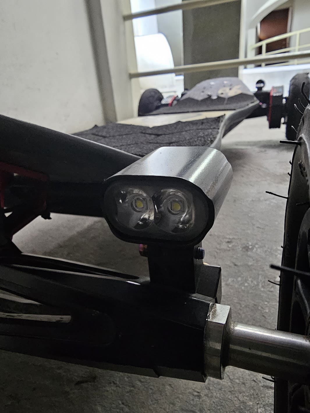

I bought some front led lights for my board and attached them directly to my 12S battery with a just a latched push button switch, no step down controller needed, the light have been amazing so far and I need new pairs for my other boards but I can’t find the source where I got them from.
I remember someone here suggested them a while back, but I can’t find where I got them, hope someone point me in the right direction.
