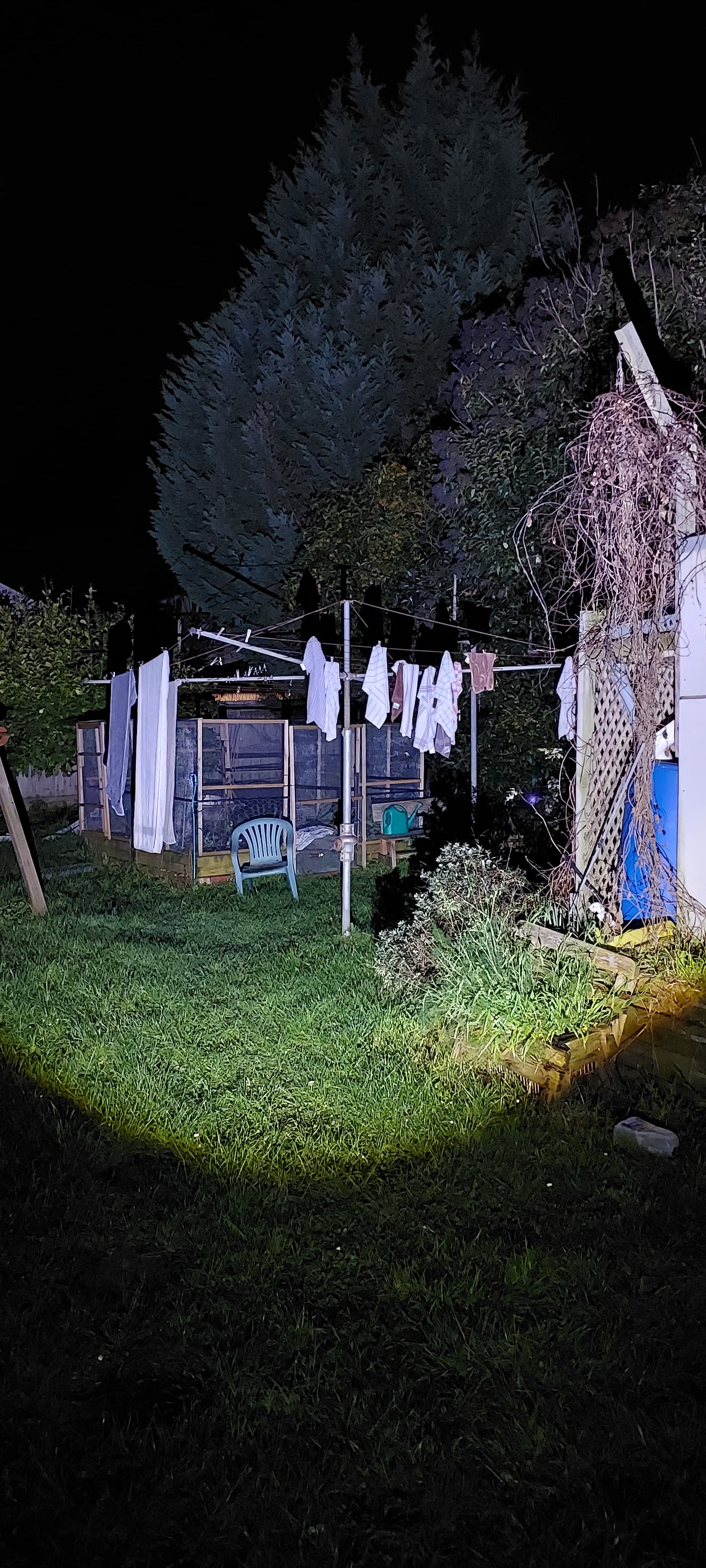

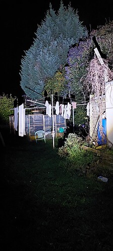

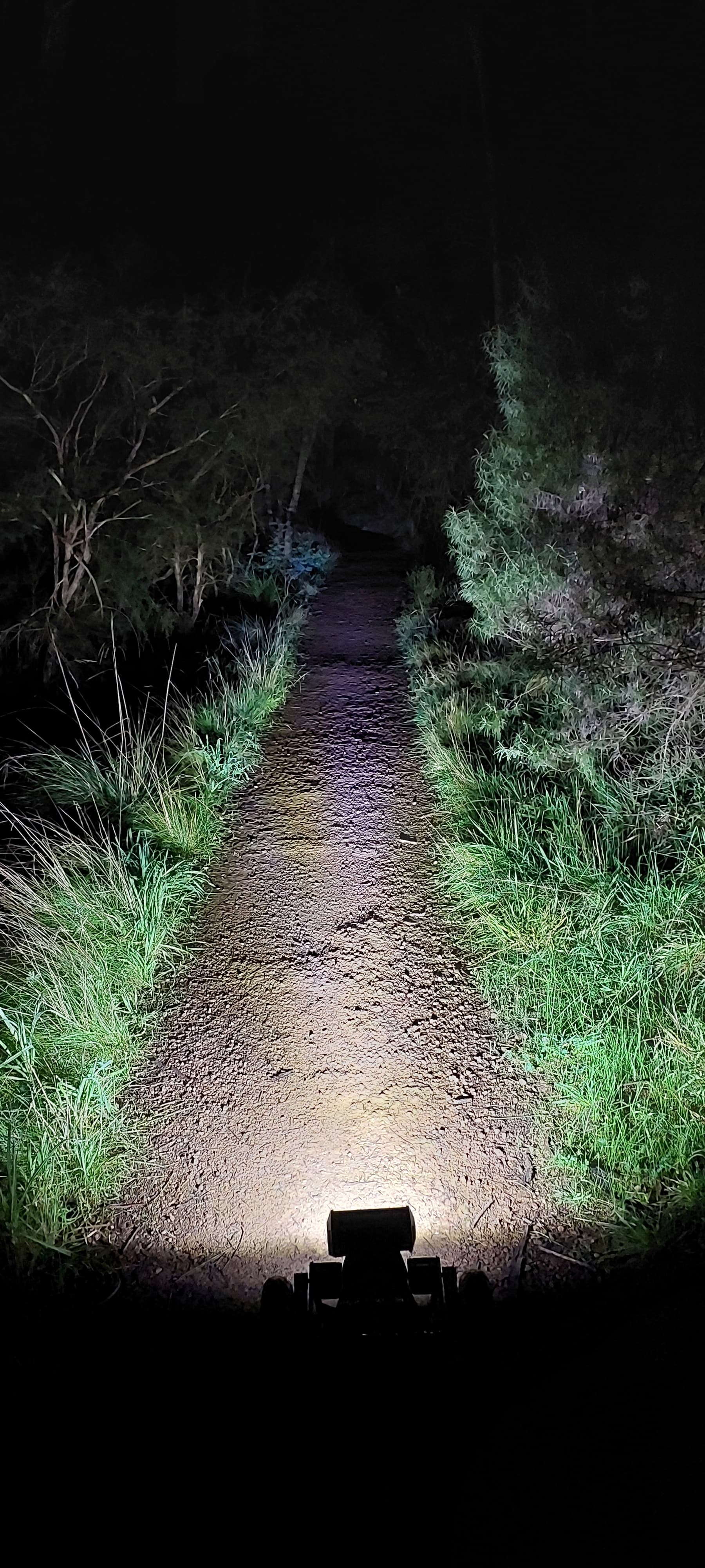

Results are in.
Headlight by itself is “adequate” for night trails, good spread of light up close. Fog will be interesting to see how it fares.
Headlight and torch… no brainer. If i forget my torch, itll be ok, just a slower trip, torch and headlight is sweet, a good 30m clear view.

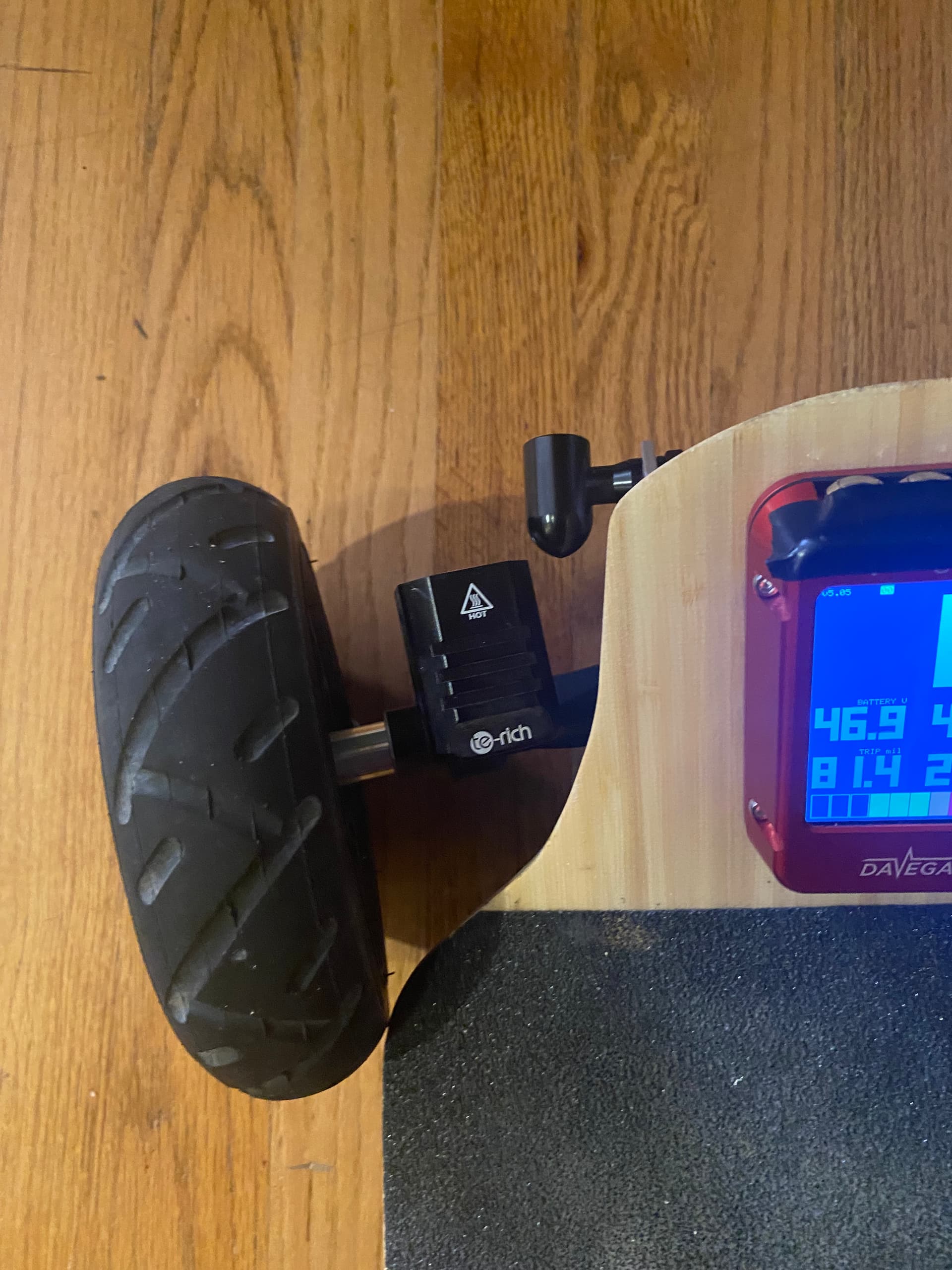

Headlights are 5v and are like a crapy version of the lights ShutterShock is working on. Drawbacks are the power source and driver and mount. They are bright as fuck so thats good. Mounted to the front trucks but the mount is too far forward for my taste (the visor I’m making keeps bumping stuff). They also have a physical button so i have to reach down and turn them on and set the brightness. The led uses 3.6v forward and I’m looking at making a 12v setup that will go into the housing but maybe not. Ideally the lights would be 12v input, small driver circuit to drop forward voltage to 11v with a similar light output and have a pwm controlled input to drop the brightness to 40-50% duty cycle. I have to redo the stock mounts as they don’t lock down and loosen up over time. Im working on a keyed version that will be basically a shaft collar with a keyed ptu insert to lock them to the truck while pushing them back a bit and cupping the light at the mounting bolt to stabilize the positioning. I hate 3d cading and only have free versions of stuff and now that fusion 360 is getting rid of the free license i’m probably going to farm it out to someone who isn’t using tinkcad lol
I think i have the room with a better mount to shift out to the wheel a smidge, bring the light back a smidge, and make the trimmed headlight visor sit behind the wheel rubber so it doesn’t bump but that’s a problem for future me. This isn’t wheel biting btw, this is my trucks as loose as i can ride leaning all 200lbs of my frame on the board edge and pushing down while holding on to a wall to get the pic and only just looking like it touched… it actually has a little gap you can’t see because of the angle

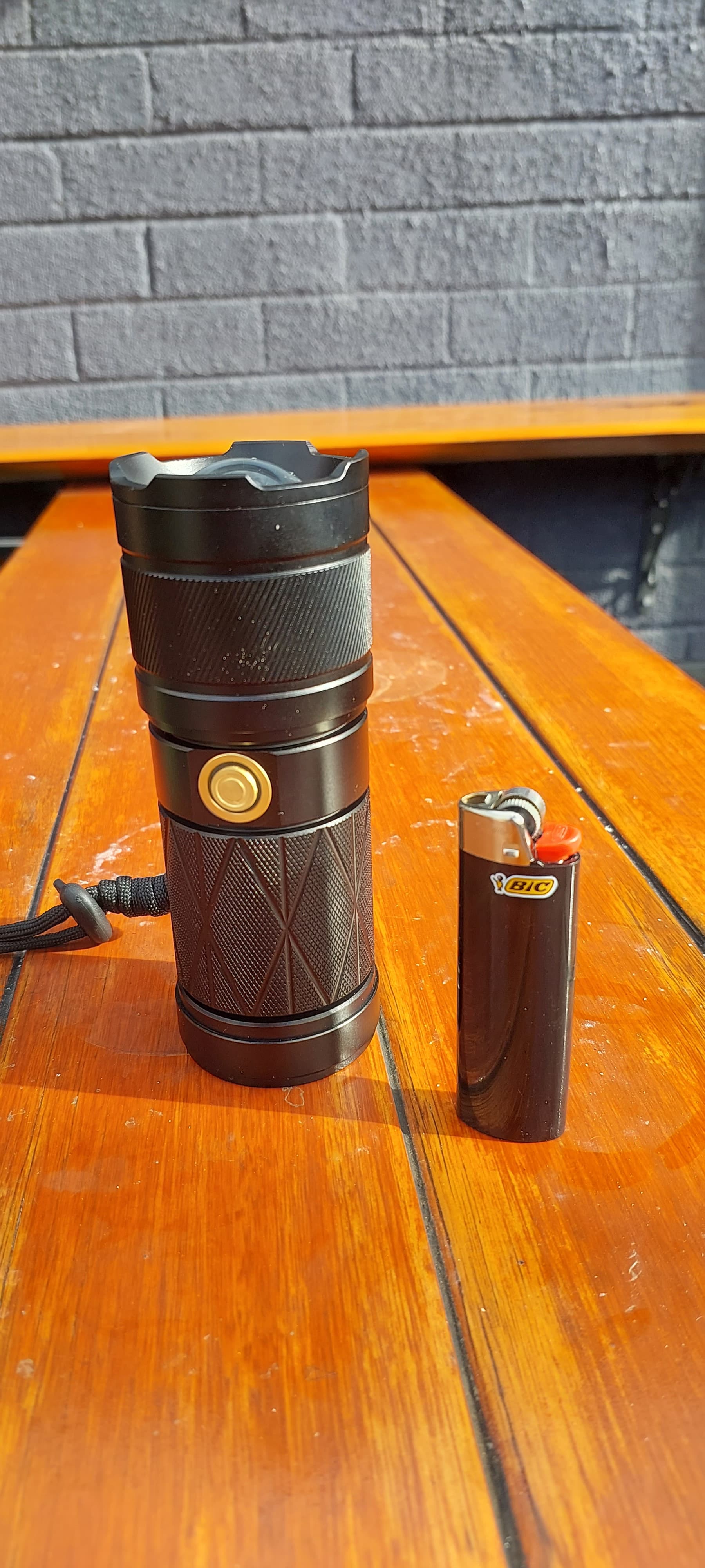

This fucked up little unit runs off 3 x 18650 and is brighter than twin SL1000’s, spreads wider and is telescopic for focus.
Will be giving it a run tonight about 3am
It might be a little savage, sure… given i was run over last week in broad daylight… its become an us or them thing for me ![]()
What model / brand it? looks gorgeous.
Do you have a hyperlink for that?
