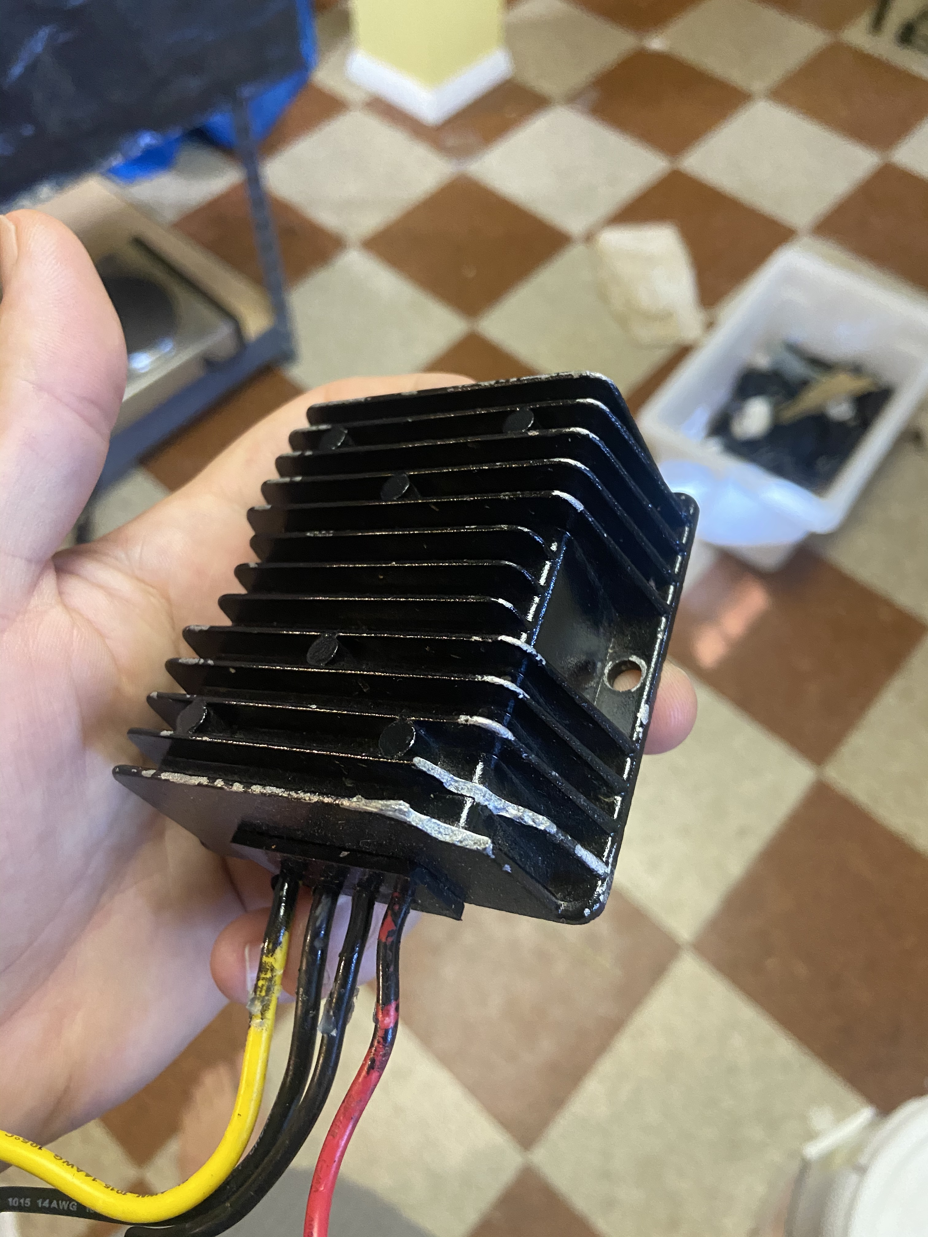

I’ve been using this converter externally on my big board. It’s survived a ton of wipeouts. Just thought I’d pass it forward for anyone looking for a BIG converter. Still works just lazily getting through a rebuild
Kohree DC/DC Converter Regulator Reducer 48V Step Down to DC 12V 20A 240W Waterproof Power Supply Transformer Volt Module https://www.amazon.com/dp/B0756T983Q/ref=cm_sw_r_cp_apip_owFhmSti183Kn
I don’t like that the big ones are all not adjustable. :expressionless:
Yea but it’s got battle scars!
Even the “neutral cure” ones will etch copper slightly and become tinted green when in direct contact, because they produce some ammonia. They’re not as bad as the acid cure ones that produce acetic acid (vinegar) though.
The one that @Ricco recommend me
@pixelsilva My trampa was the first high powered ttl unit. Ricco and I blew up my board a couple of times getting it right. A lot of the ttl kit today comes from those mistakes and is comprised of what worked. That converter is about the only thing I couldn’t blow up. It took a heavy beating in a couple really good accidents.
Still works? Look like been at war :boom::laughing:
It works just fine!
