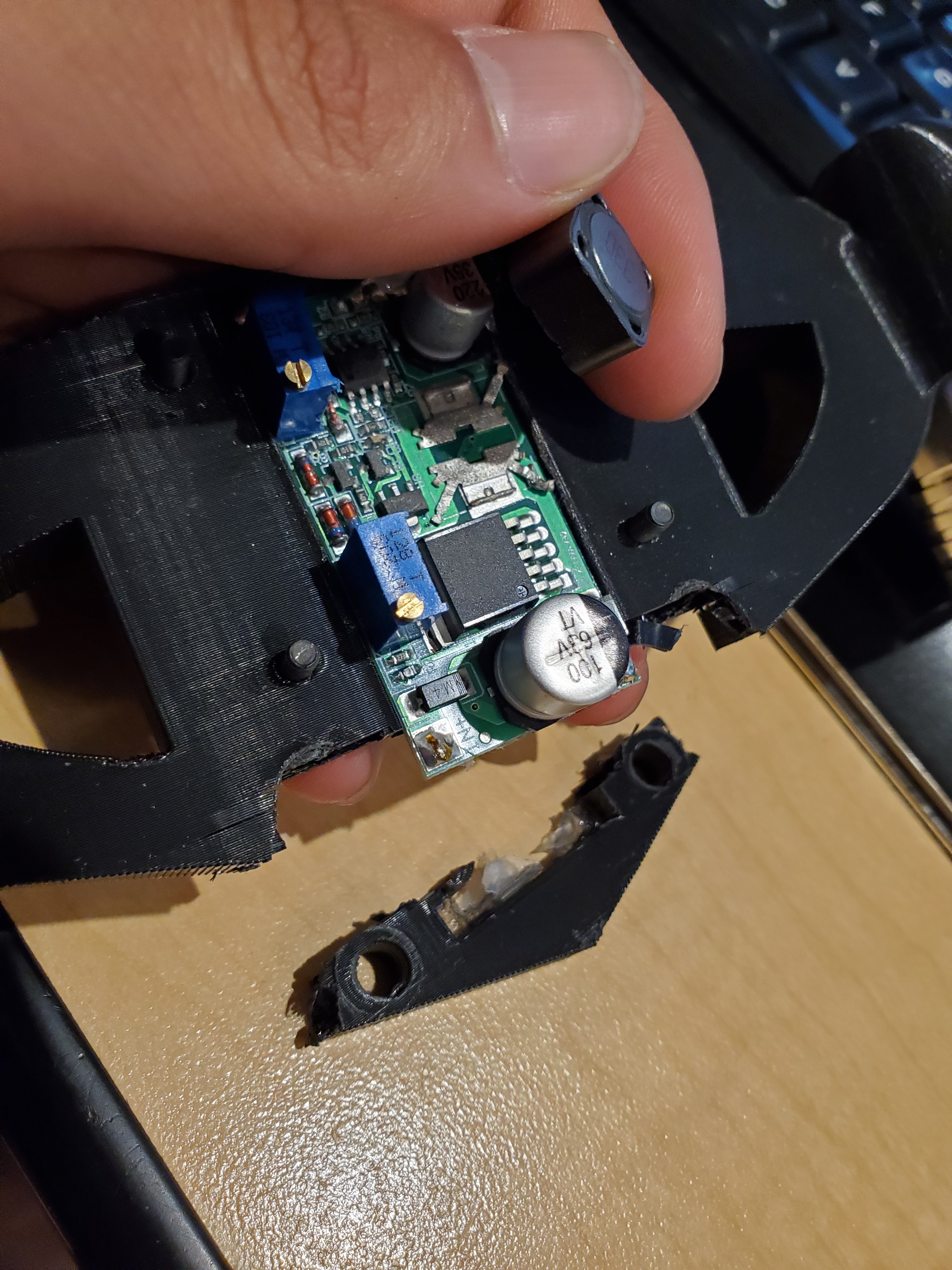

Welp… V1 of my mount died 5 miles into its first ride. V2 is printed out, but my little converter also died on the first ride. Any suggestions for the circuit board? I’m gonna have to just get a replacement - at least it was only 8 bucks
Should I just cover it in HMA? It did get quite hot so I would imagine the HMA would melt again when it’s in use.
I got this one that was already all potted and stuff so it seems good for vibration, hoping it proves to be indestructible.
Bit larger then yours I suppose, not clear in the pic where yours was stuffed.
I designed it into the mount, it was only 48x24x14mm
no other pics of it in the thread sorry, you mean the light mount to the deck I guess though.
Oh yeah I didn’t share any other pictures except for this one, the converter is in the light mount which mounts to the truck
Pot that sucker in some epoxy.
Break out all the wires (and maybe the pots too), build a mold/box/dam around it and fill 'er up!
(probably on of the few places I would NOT recommend using JB weld, even if if is theoretically nonconductive.)
I can’t disagree with what Ryan said, but I have been using those same parts in ultra-high vibration environments for a long time and never had that happen. I do always seal them with something though, usually acrylic.
