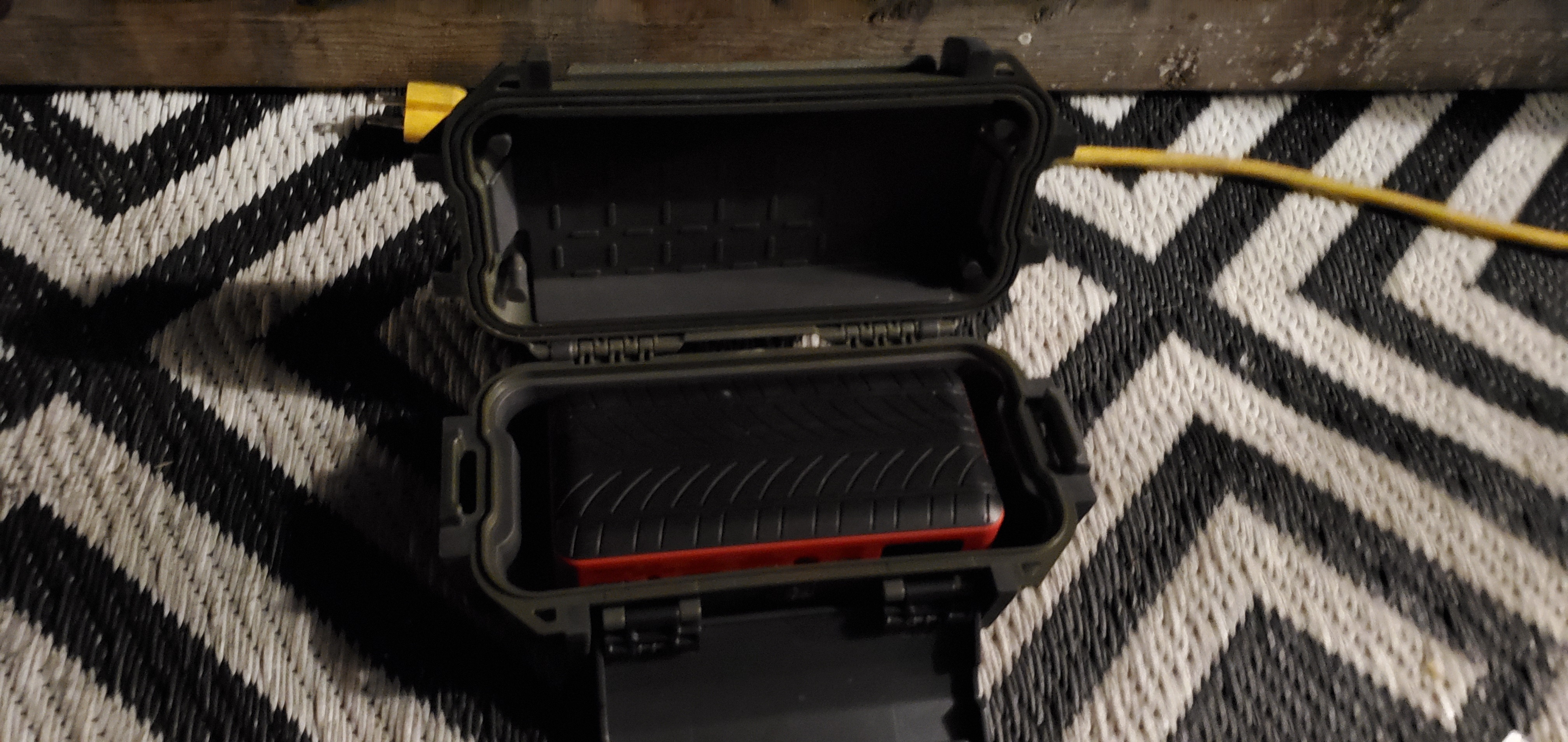

An old car jump booster/powerbank.
It has a DC port to output 9, 12 or 19v
Found my answer.
Guess I’ll grab a converter and up the voltage at the same time. That’ll bring down the amps

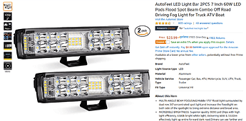

That may not, because many LEDs are current-based and more voltage doesn’t help
They’re the 9-30v kind
I’ll get a link
@b264
https://www.amazon.ca/dp/B081PZ6FRF/ref=cm_sw_r_cp_apa_i_T4qBFbN150WMZ
In any case, the converter I ordered can go to 12a

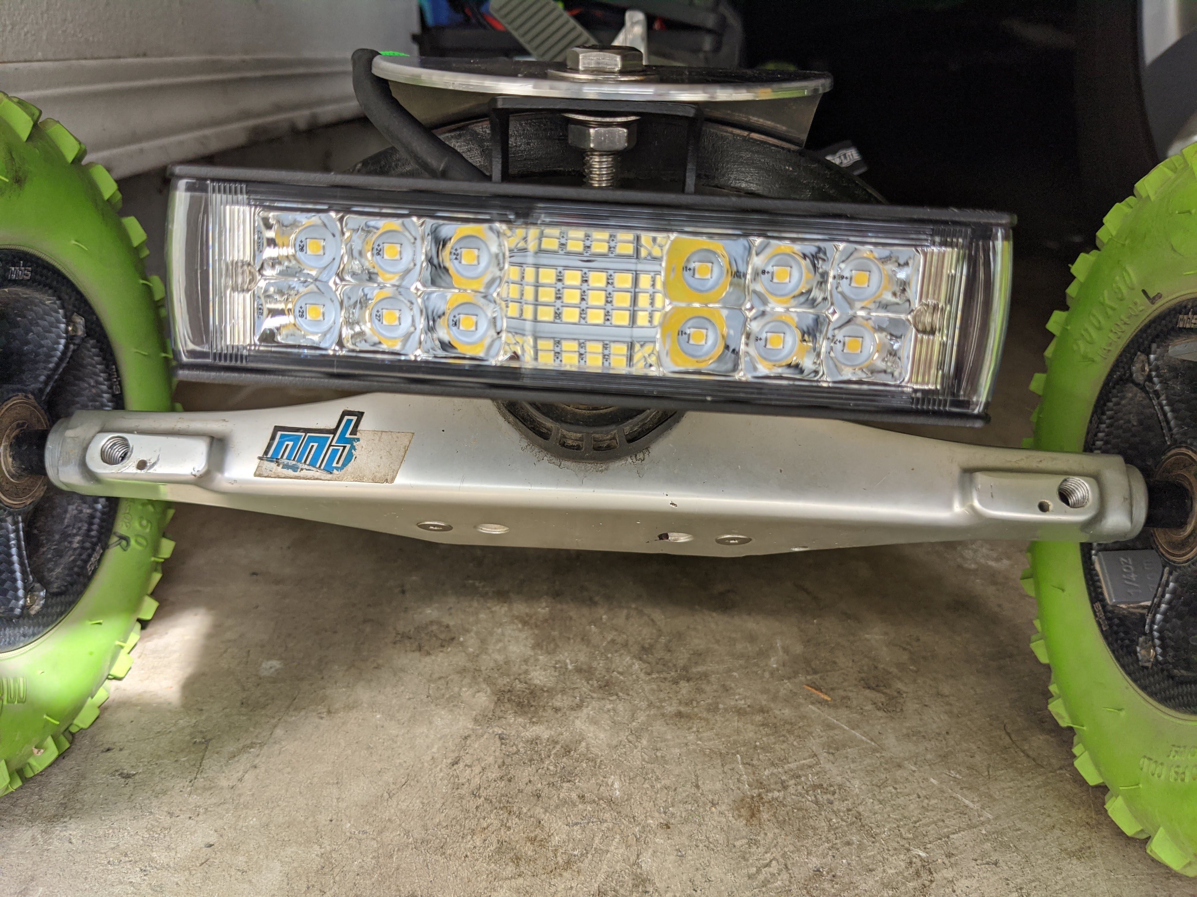

I just don’t want the 14000 mah powerbank to die too quickly. It’s for the possibility of doing night rides with my monster build while still being able to remove them

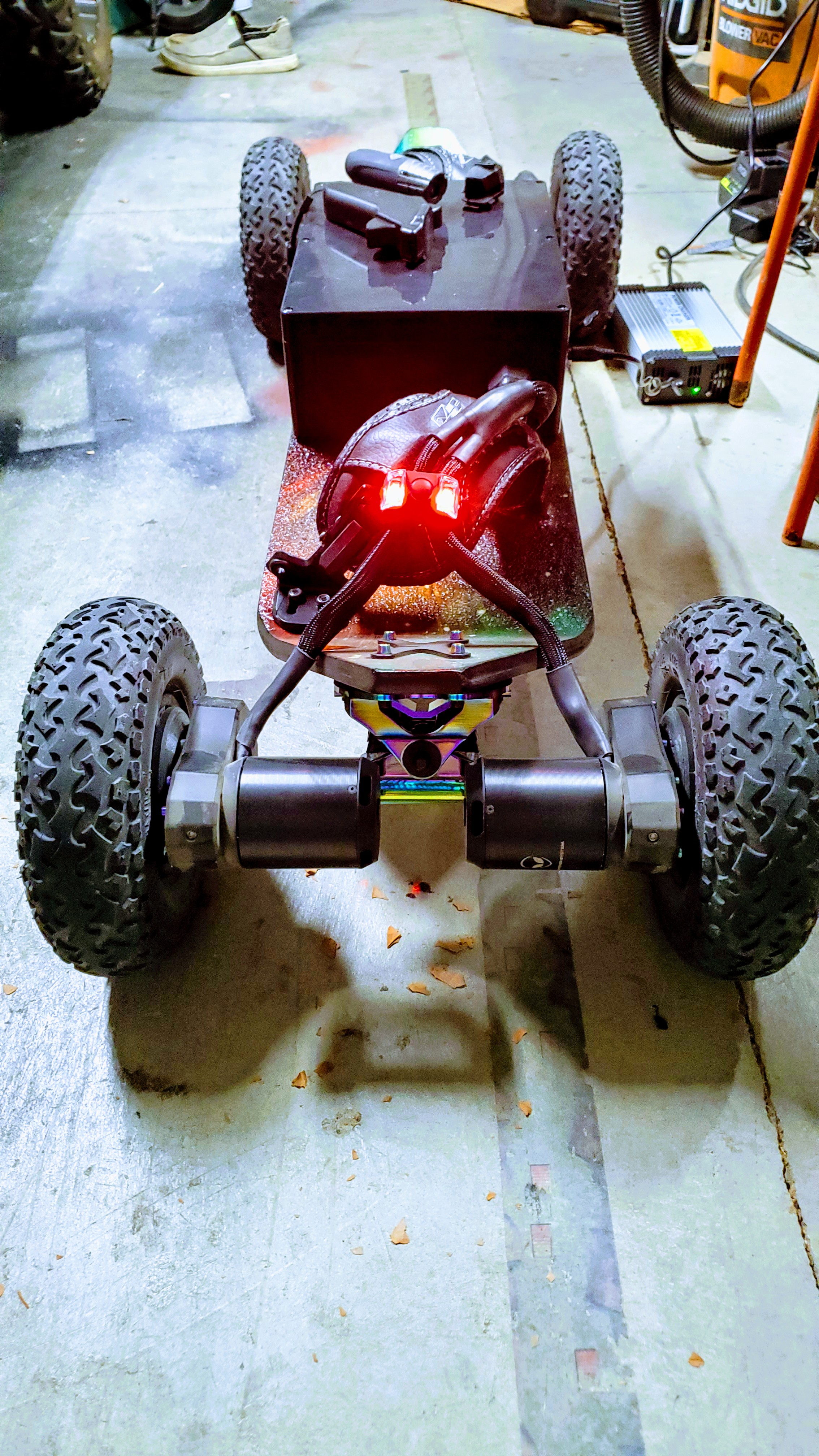

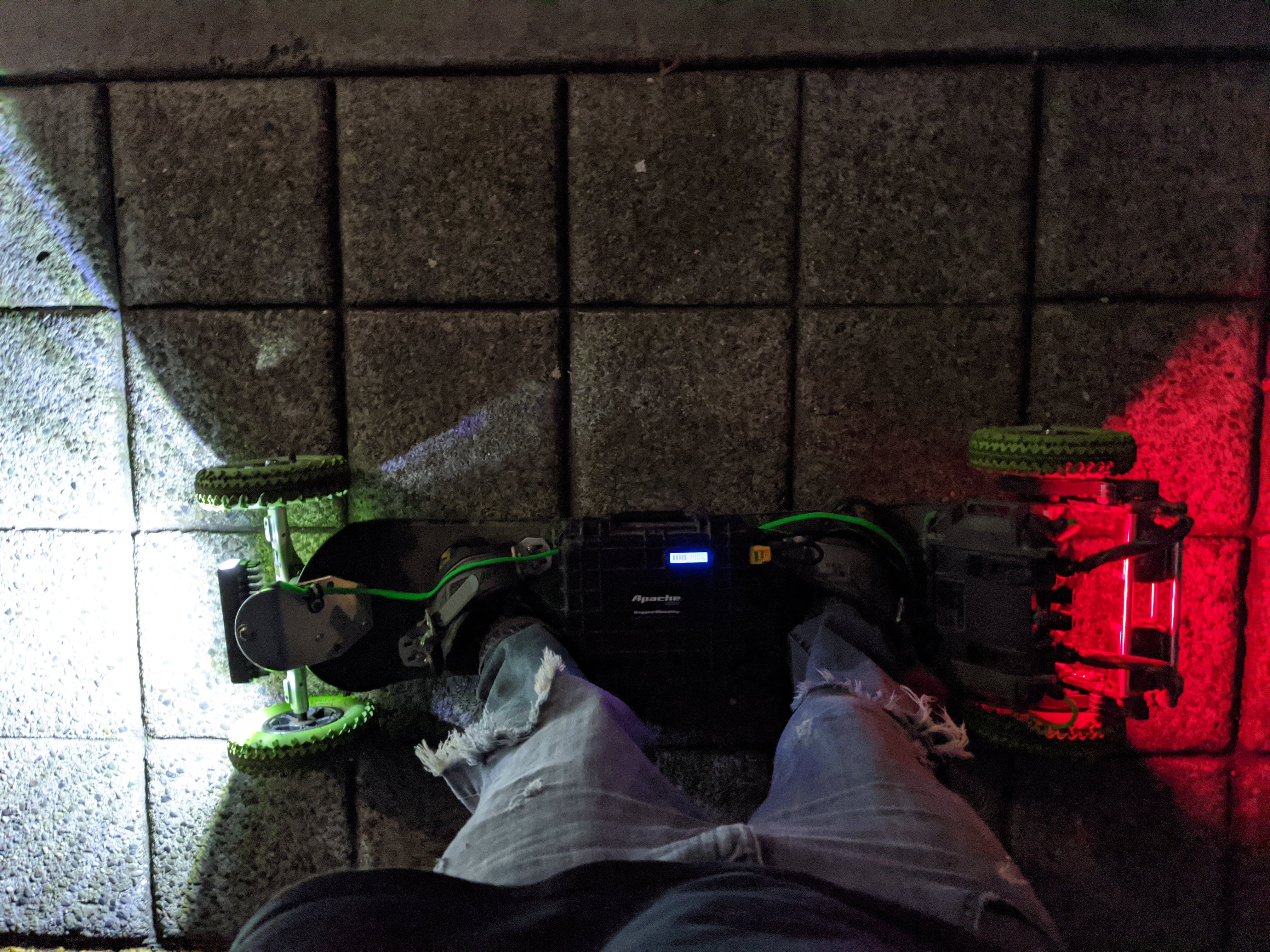

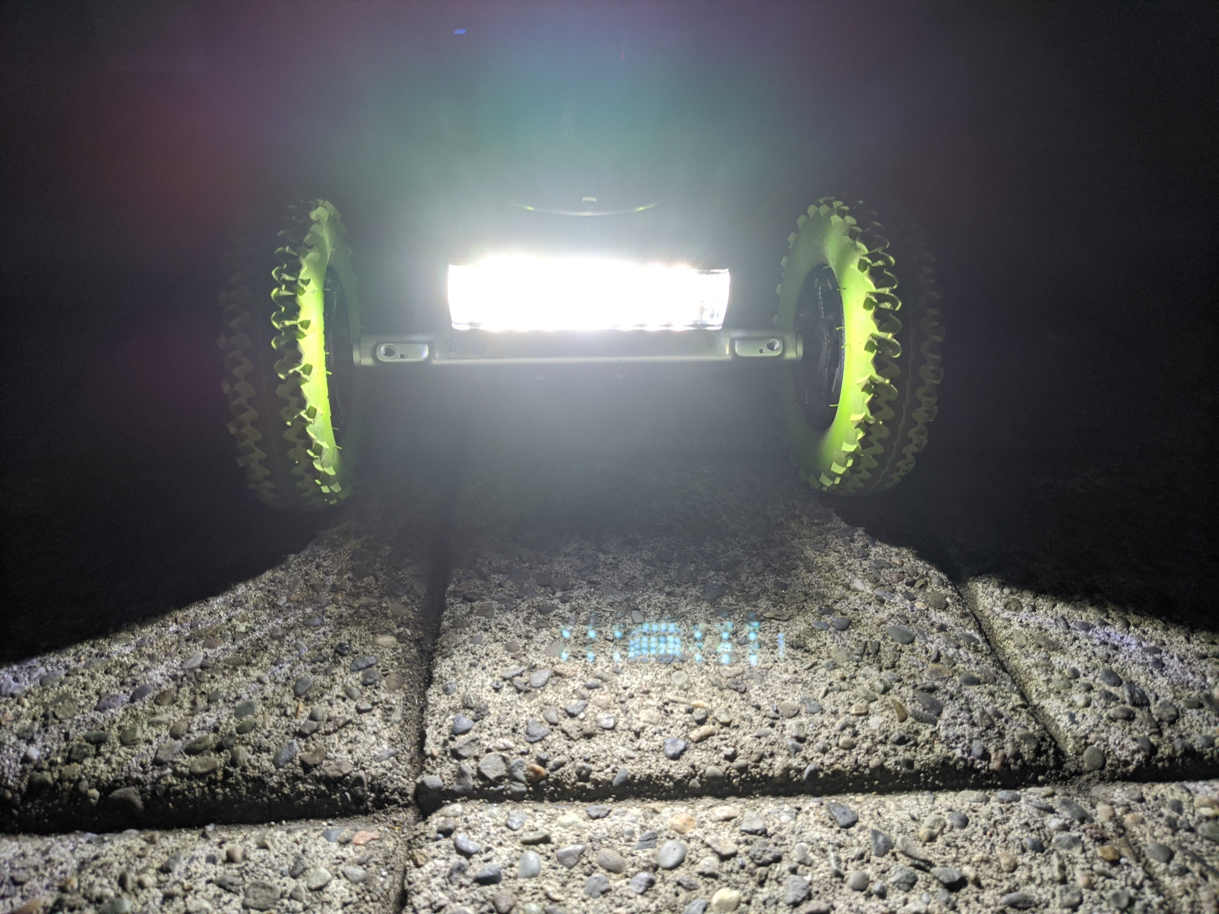

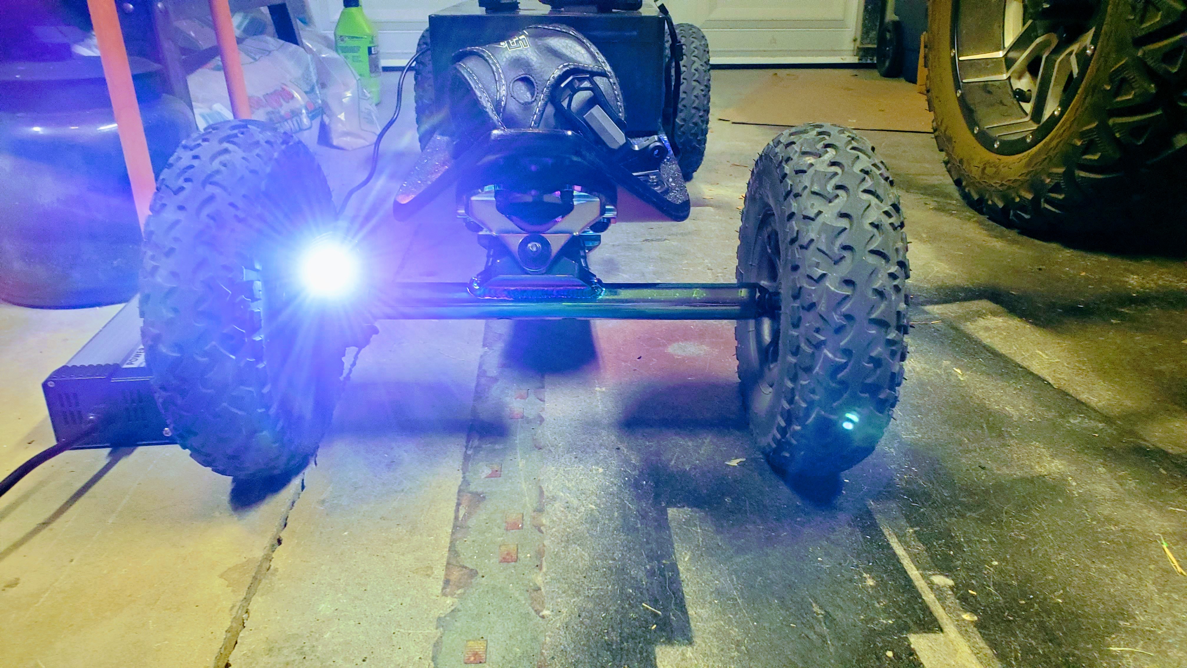

I have a small buck converter in the electronics box for the tail light with a switch. For the headlight I am using a larger buck, waterproof and a switch.
Tail Lights
Headlights:

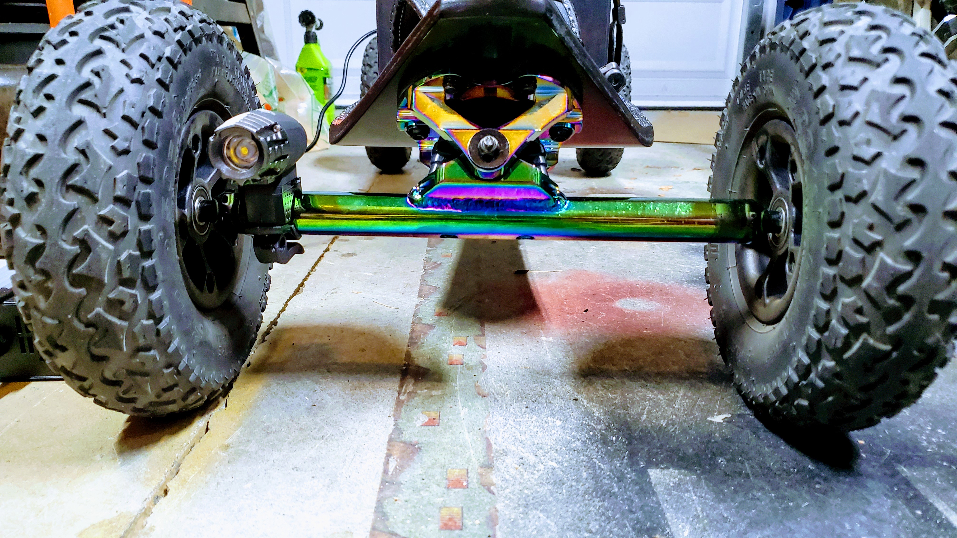

Mount, custom:

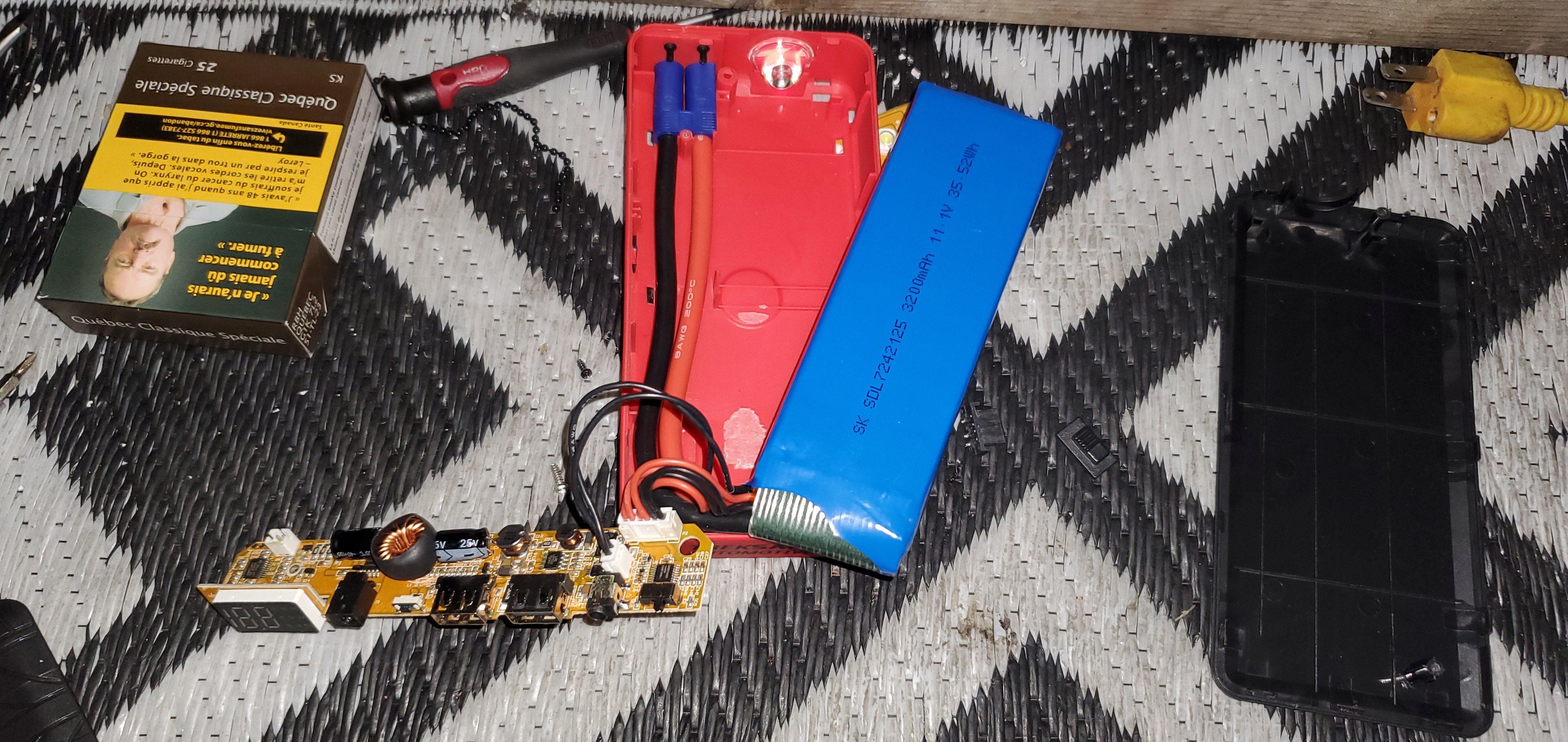

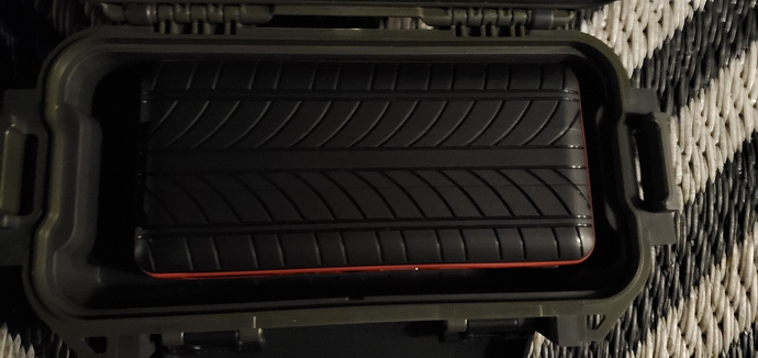

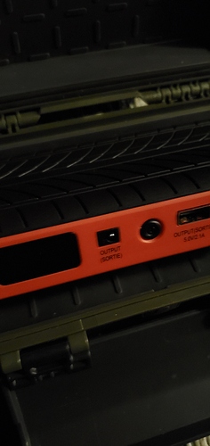

Fuuuuuuuuuck… My plan just went down the drain…

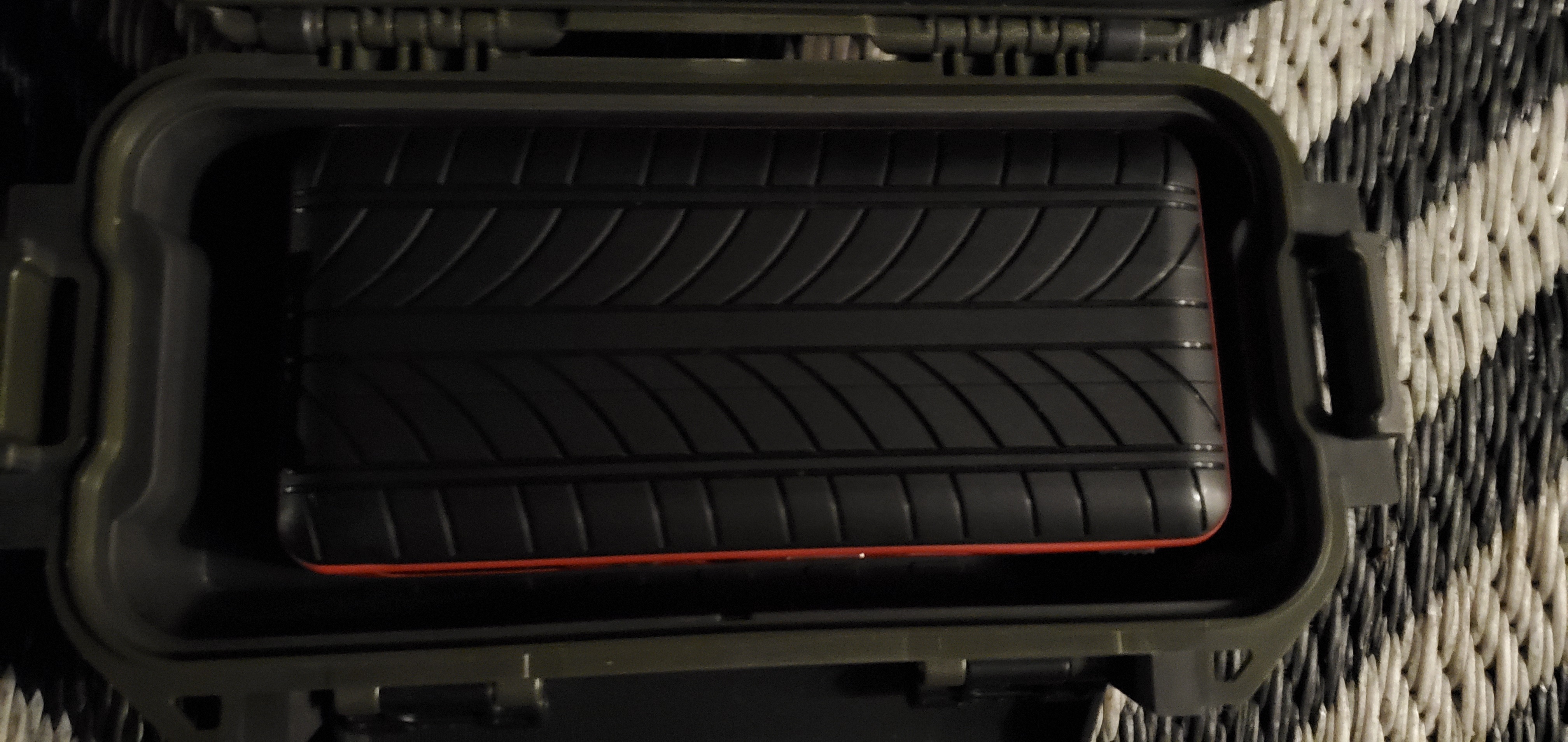

Everything can fit…except the plugs on the power bank
So…for anyone curious…probably just me…
Found out my powerbank uses a 3s LiPo
Wtf haha I have to say, I haven’t seen that one before. Usually they’re like custom sized 1s or 2s lipos haha
The ones that can be used as a jump starter are pretty much all 3s RC lipos or other high-C-rating cells inside, because they have to be able to supply the several-hundred-amp cranking current to start a car.
Looks like that one doesn’t even have the usual protection feature of a set of fets between the battery and the high-discharge output to prevent inadvertent high-output events.
@MysticalDork From what I could find with the id code on top, it doesnt make sense to me.
It would be a unbranded venom fly 3s 30C
What doesn’t make sense is the claim was can jumpstart a truck. That’s 1000amps peak. My wife’s V6 4WD SUV is 800amps to jumpstart.
Was this a ticking bomb?
Probably, yes. These jumpstarter packs run right at the bleeding edge of the cells’ capabilities, and if you use them for jumpstarting a lot, I would expect most to get angry/puffy/dead very quickly.
Okay well I already told my wife it was dangerous when I figured I needed to dismantle it to use it :rofl:
So it has been repurposed
Curious what kind of run time you get on 32Wh
Probably not much :rofl:
But I’ll eventually give it something juicier.

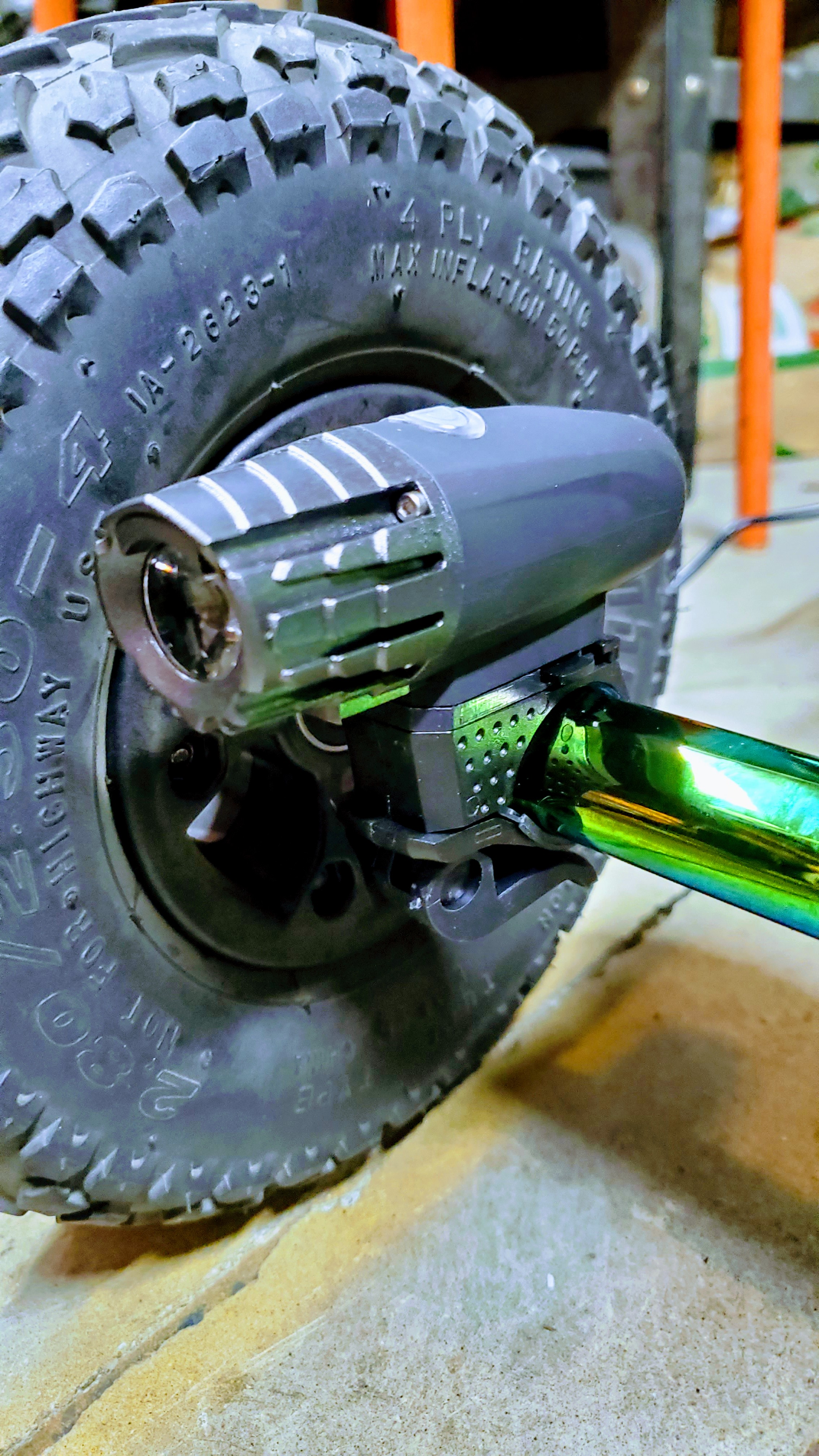

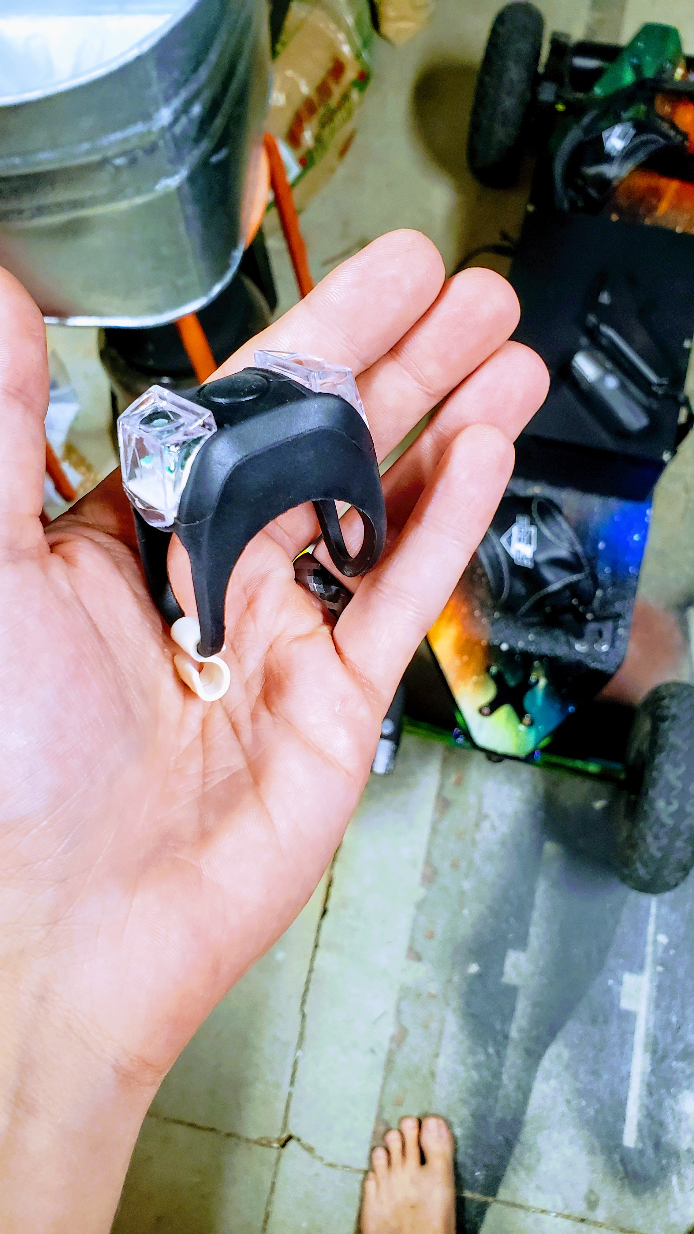

I use these lights on the top of my other boards with a vendors 3d printed setup here but had issues with the angles of my mtb so I found the handlebar versions for sale on ebay. They slide on and off with a latching clip that has held up extremely well.
They came with some free clip on red led light which was cool I guess. Then I realized I could use it as a cable guide in the rear as well.
