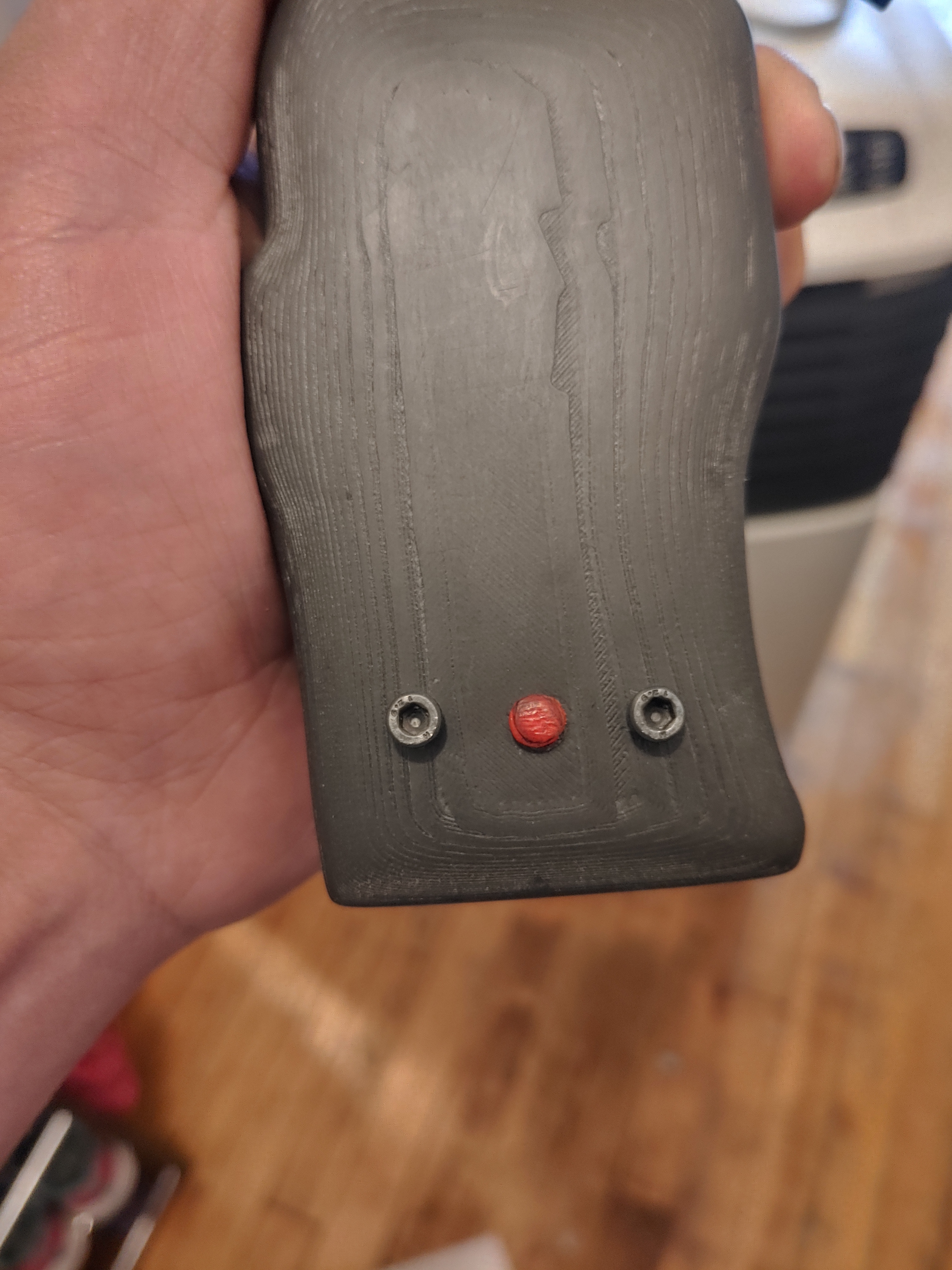

I recently assembled a gt2b Cho mod but had it printed with 15mm extra length and used that space to incorporate the 3rd channel button everyone cuts off
Doesn’t that just switch the active channel that’s being used?

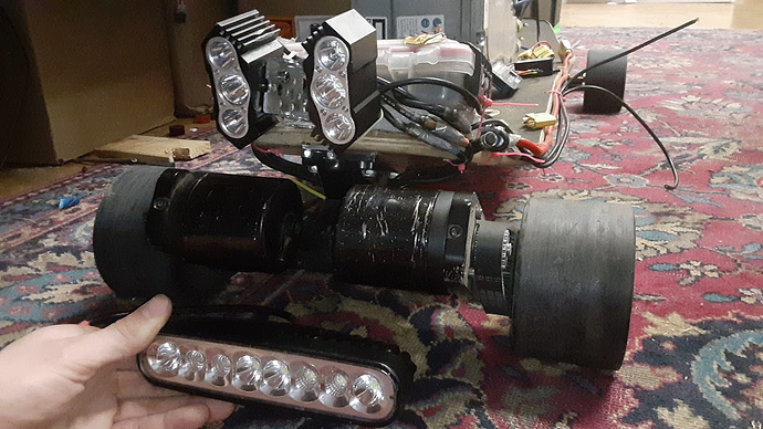

I have a pico switch plugged between my headlight and main current. It has an connector you plug into the remote receiver to control a relay to open and close whatever is plugged into it
I just mean I thought that that button in the Gt2b didn’t do anything useful
@ShutterShock I think it’s just the fact people don’t usually have a use for it.

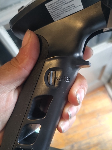

I have a second channel button on my aps and wanted to use it. Now that it’s breaking into pieces I wanted something with an extra channel button to replace it.
The GT2B is a 3-channel transmitter. Throttle, steering, aux, or 1, 2, 3. The aux/3 toggles between low and high when you push that button.
It’s how I set up my high/low beam headlight on my last board.

My light bar is directly connected to power (on exception of the picoswitch itself)
My led underglow is addressable and connected to a Bluetooth driver.
Ahh.
If you’re feeling especially adventurous you might be able to dig into it and swap the internal driver (It has to have something, if only a resistor) for one that does support dimming.
I’ll let someone else destroy theirs
Its this one. It states 12v to 24v operating voltage but if you dig further down, it says 9 to 60. Mine is plugged directly to my 12s through the charge side of my bms

I haven’t tested it yet. Are you saying it’s always on? Don’t wanna blow up my relay with a test

RLY?? I have one of those I’m pretty sure. Got it used from @ZachTetra
Do I trust
so it self current limits as well?
hmm that would make sense given it’s meant to be a light bar
do you have a link for these other ones too?
I can’t vouch for other’s purchases there were so many different versions of this light bar when I bought it. I wanted the easiest hookup possible.
I was testing it a while back and it is current limited, I thing it pulls 0.866A regardless of the input voltage (it starts up at 6V and gets brighter up to at least 50v, but you get diminishing returns and its like 90% bright at 20V)
