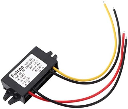

Put it on with buck converter dropping voltage to 5V so far so good.
@ZachTetra progress on yours?
Not yet, I’ve been waiting on a replacement step down since the last 2 I got came dead. Also recovering from a helmet only crash at 20mph so I’ll be taking it easy and not holding small things for a while
I had a drill fall on my leg at work 2 months ago…I’m at the opposite end. I’m not able to lift heavy stuff(which includes my trampa build :stuck_out_tongue: ) hope you’ll get better. You’re putting the step down in an enclosure under board? Or the one I have would fit your needs?
I tried the small 10a PCB style ones and they died, gonna get the fixed voltage heat sink ones and mount it external (it’s waterproof)
That was my second option when I was looking around
Do they have 5v ones?
Edit: apparently the beefy heat sink one is cheaper, just need to find space for it
How many volts input?
12s li ion, so at least 50v
Would the extra .4 be a risk on a 50v regulator?
Also, would 3a output be sufficient?
The underglow runs at 9A supposedly
Wait what? How??
I just tested 144pixels and got only a draw of .73a
Hmm…it says 43W at 5V
Edit: haven’t tested the amp draw since my multimeter is half blown
Mine or yours?
The lights I bought are listed as pulling 43W of power at full brightness, and I can’t test the actual draw without a new multimeter
Okay well mine are rated the same. You putting in how many pixels?
2 strands of 72, 500mm each
Basically 1 meter of 144 XD
I had a chat with @MysticalDork about this 3 days ago. I’m planning on 2 meters and this is what he comes up with:
Oh that’s amps into the step down
