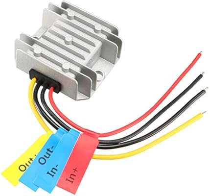

So, considering the above statement I have a feeling g 3 amps would work for ya.
So this bugger is overkill?
uxcell Power Converter Regulator DC 48V/60V 10V 60V Step-Down to DC 5V 10A 50W Waterproof Voltage Convert Transformer
Erase absolutely everything I said…i was running a setting that gave less amps from the strip. At full blow it’s another story
Oh lol, so full brightness for 144px is 25W?
Full brightness (according to my app) on white since it’s the most current drawing color, I get this as a max
And they are toasty hot

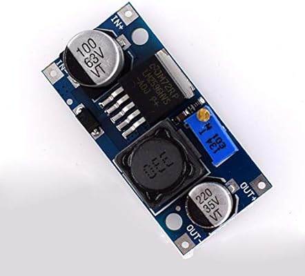

Just for another buck converter option this is the one I’m using right now:
Typically only have like 48V cap on the input side this one has 60V and believe the main chip there is rated high enough for this to be safeish (it works fine for 5 high brightness RGB LEDs at least not sure how many is too many though).
