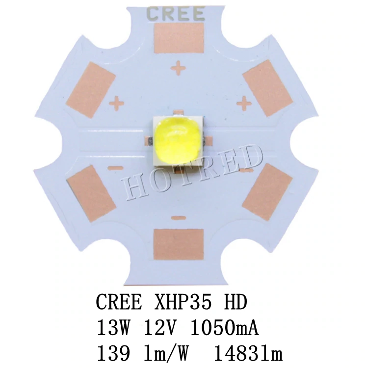

The output shape is dependent on the shape of the LED die itself, so picking something like an XPL HI (HI = high intensity, has no dome/lens for a smaller apparent emissive area) will result in a sharper, tighter pattern, whereas something like an XHP50 will be a lot more floody and less-controlled.

There’s a holder that the lens fits in, that sits on the star to give the desired spacing. There are three different part numbers and I don’t know what the difference is between them. 10732, 10734, and 10736.
Just did some more digging and it turns out there are a whole range of different numbers, and the numbers determine different reflector spacing. I don’t know if there’s a way to determine the optimal one needed without testing.
I think I’m gonna order 3 of the XHP35 12V cree modules with the 20mm copper PCB in cold white. Hopefully they don’t take more than a month to arrive, I also have no clue how expensive the optics are yet lmao
They’re a buck or two a piece, not terrible.
Okay, so after you select the specific LED you’re using, the carclo website will tell you exactly which holder to use that will hold the optic at the optimal position. Looks like for an XHP35, the holder you want is a 10733.

So basically per light set up, I would need 1x lens, 1x holder, and 1x diode. Then after that, I need to figure out what the heatsink would look like and then design the rest of the holder.
