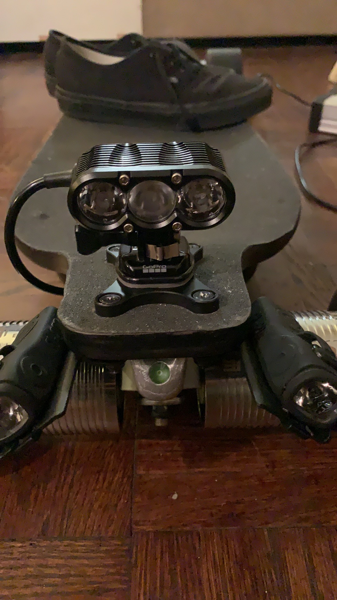

And don’t underestimate the led heat production, even with this relatively massive heat sink I’m using, with the board stopped I can only run 1200 mA, more than that and the temperature gets out of control, they can do 3000 mA
On Lacroix lights they are run at 1600 mA, so if you manage to use the same LEDs (Cree U2 - T2 bin) at peak current you can have the same output as two lights in one, or in my case have almost 3 times as much light

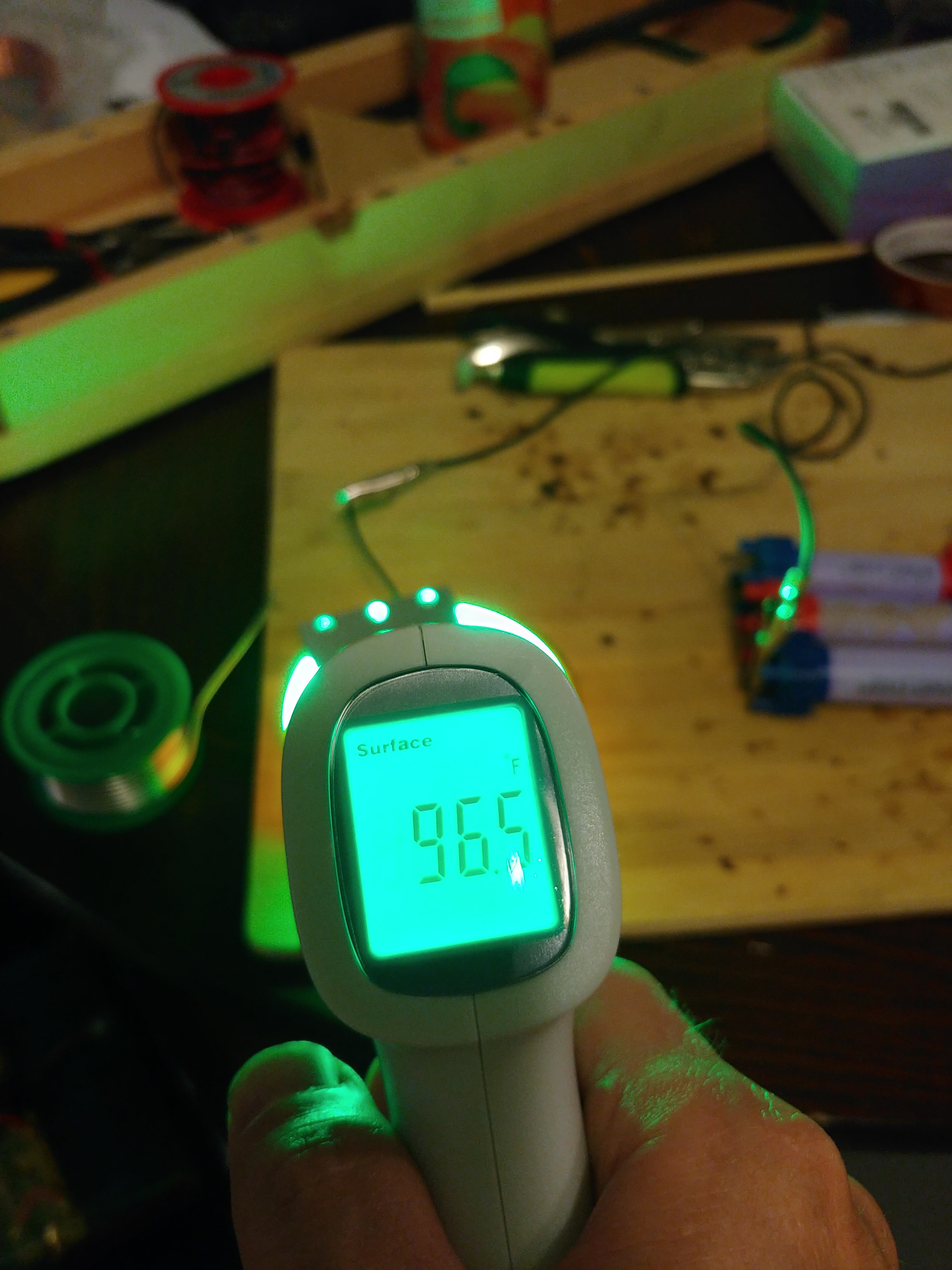

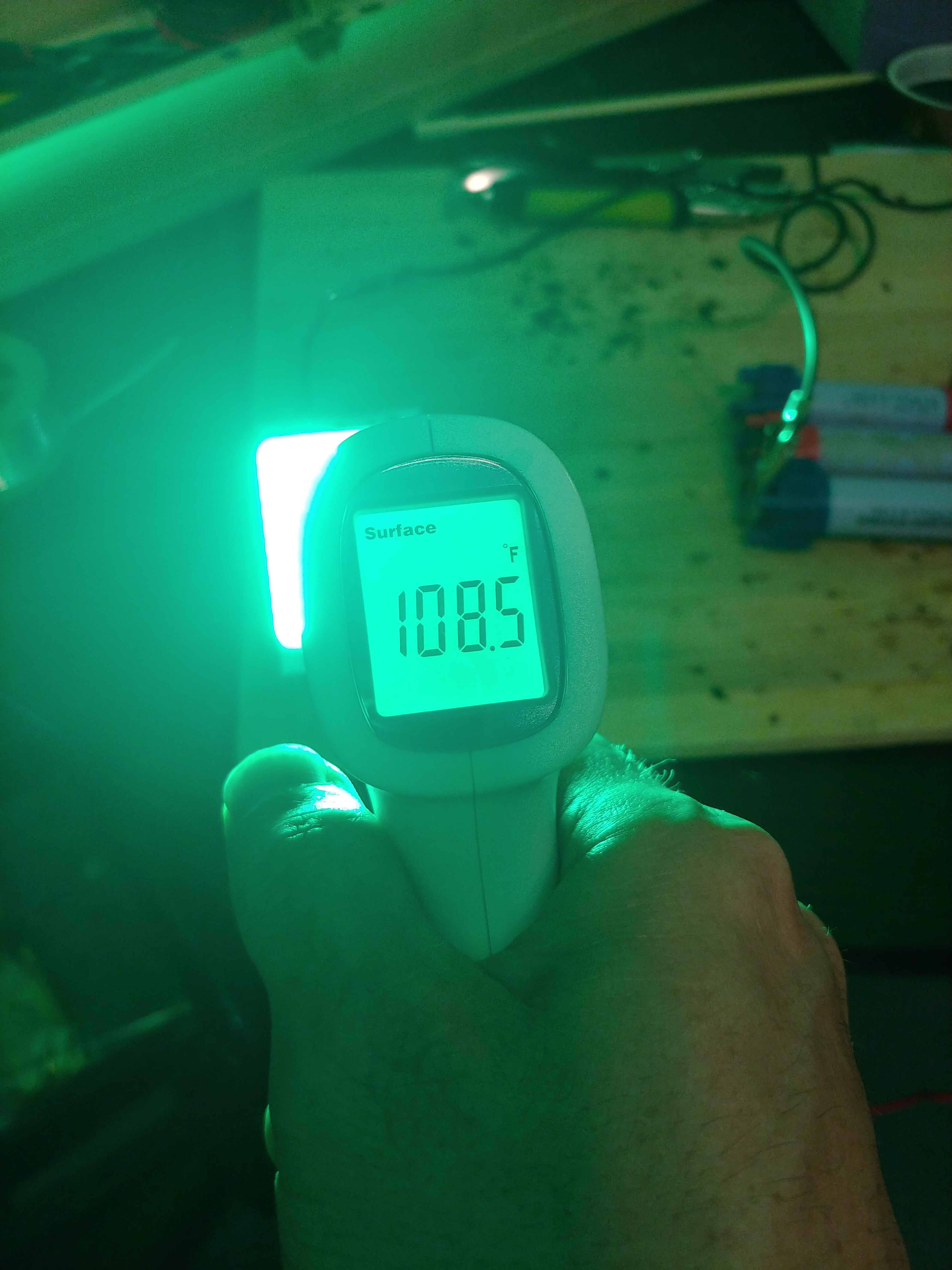

Posted these cobs in thw fluxmotion thread…
Let it run 15min to see how hot.it got… Still thinking of using Velcro to attach and running the wires into the case at each attachment point… Ahould be ok
Heat sink side…
Direct on the leds

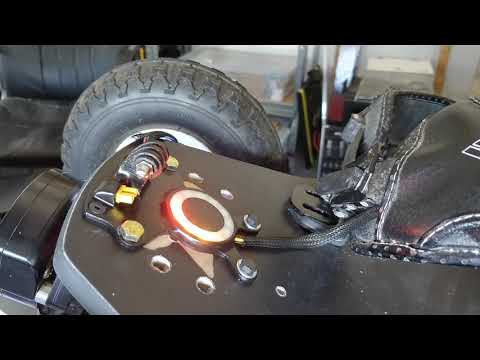

Hi lighted folks !
After many tries I think I now got the final version of this multi-purpose SmartRing mount :
  • SmartRing (as always for years now)
  • Gopro mount
  • XT30 socket providing 5V for the attached device (main purpose : light, but can be used for action cam or charging the remote)
As the SmartRing is powered with an 5V UBEC (40 RGB leds used + Arduino), I found a flashlight that would work at the same voltage + an easy way to install/remove ('cause I rarely ride by night).
I ended up with this product : https://fr.aliexpress.com/item/32922037927.html
The model without battery is perfect.
I just needed to solder the power leads on the battery pins. That’s all.
I didn’t try to charge my phone though.
I think it’s a bit too much for my setup as it hasn’t been sized for that much current in those thin routed wires (current would be something like 1.6A + leds).
Feel free to copy and remix the design ! :+1:
STL and SolidWorks 2017 files available here : SmartRing front support for MBS/Trampa trucks by Peemouse - Thingiverse

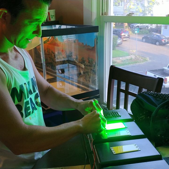

Any led gurus here know why the green cobs glow at full while the red and.blue dont?
All wiring meets in parallel and the green is furthest away from the power source… Or is it an issue of which ever one wants to draw the most gets to?
How you wired them? Different colors have different voltage/current curves
because of this
and this
So each color needs a power source that adjusts the voltage so that the current flowing through them is the correct amount
You may need 3 power sources, or you can fake it by adding some resistors in series with the brighter ones, but the resistors are going to get really hot.
all three are wired independently as they enter the case…then each lead comes together in parallel right before the buck converter…
i may just roll with it first and see how it looks when I ride as the overall output is still bright but wont know till I can mount the wheels and get it in the street…
of all them the red between the blue and green looked kinda dim but who knows…plus asphalt will absorb some light too

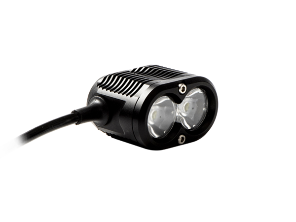

I remember the first time I saw a video of those lights on the Lacroix Facebook group
They guy turned them on and I was like, that’s in bright, and them it kept getting brighter lol
Sorry too lazy to reread 559 posts and too honest about it
Which lights are those again?
