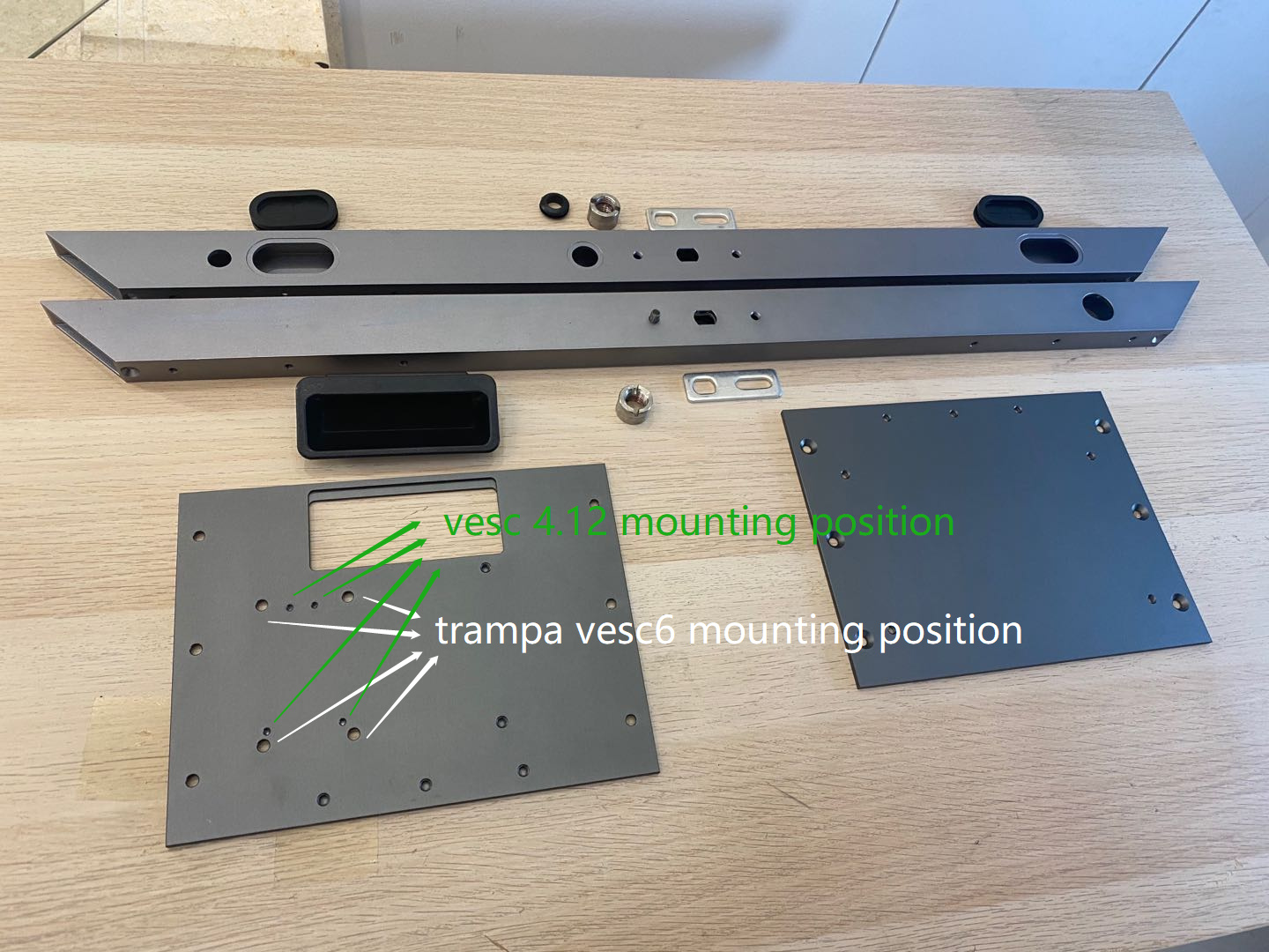

1.Phub-188 48v 800w hubmotor with tyre bough for $112 on ALIEXPRESS
2.DIY 12S1P SAMSUNG 40T BATTERY PACK $60 (177wh)

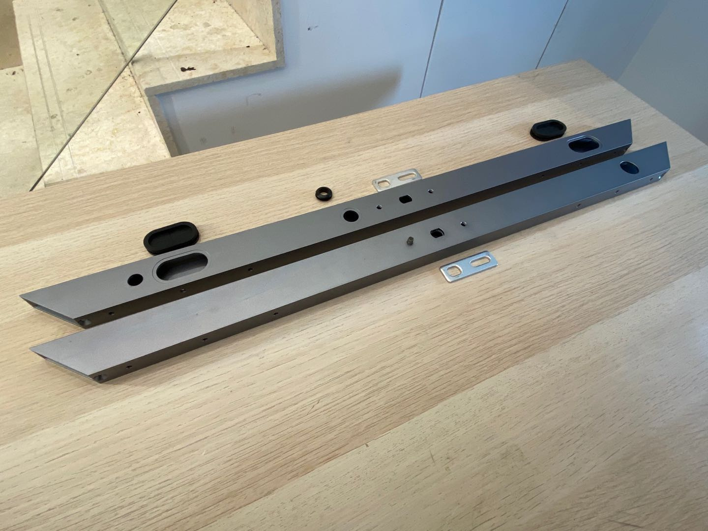

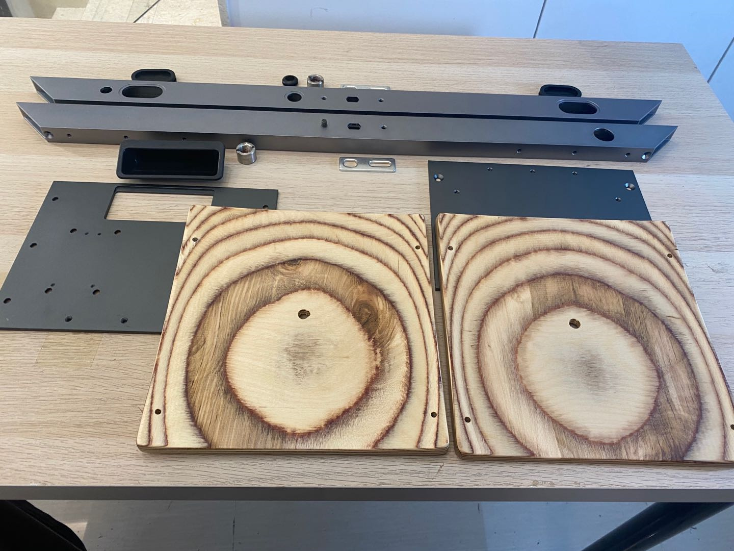

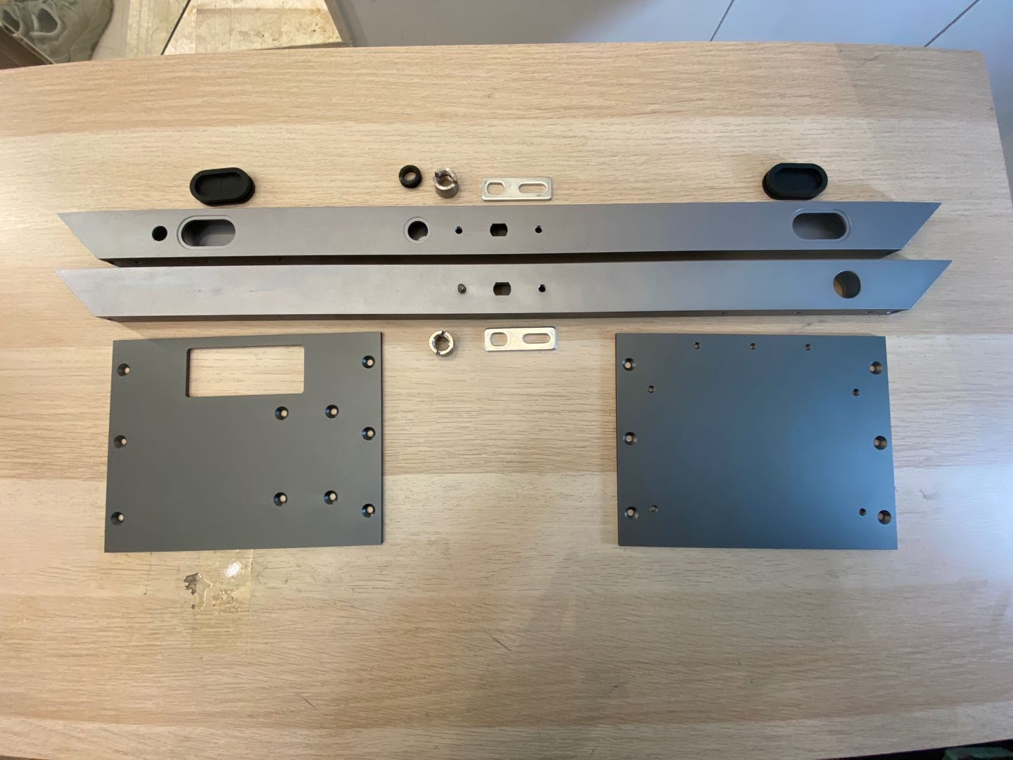

  1. 2x Customize CNC space grey anodized aluminum rails ~$120 ordered from local CNC shop
  1. 2x CNC milled aluminum underpads ~$75 ordered from local CNC shop

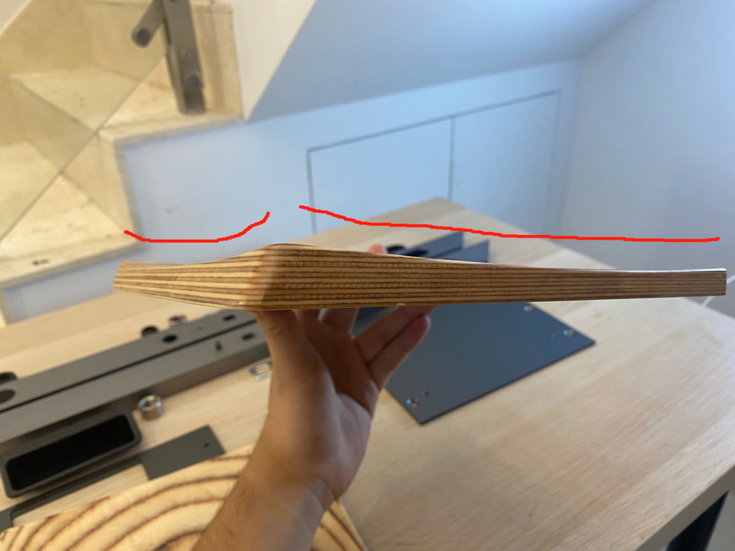

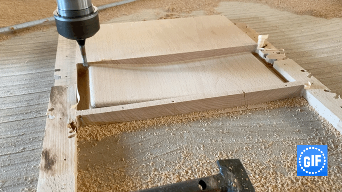

5. 2x CNC milled wood footpads made from my fathers wood hanger factory
Dish shape double concave designed to lock foot in for carving.
  1. TRAMPA VESC6+ (onboard mpu9250) $175 bought long time ago

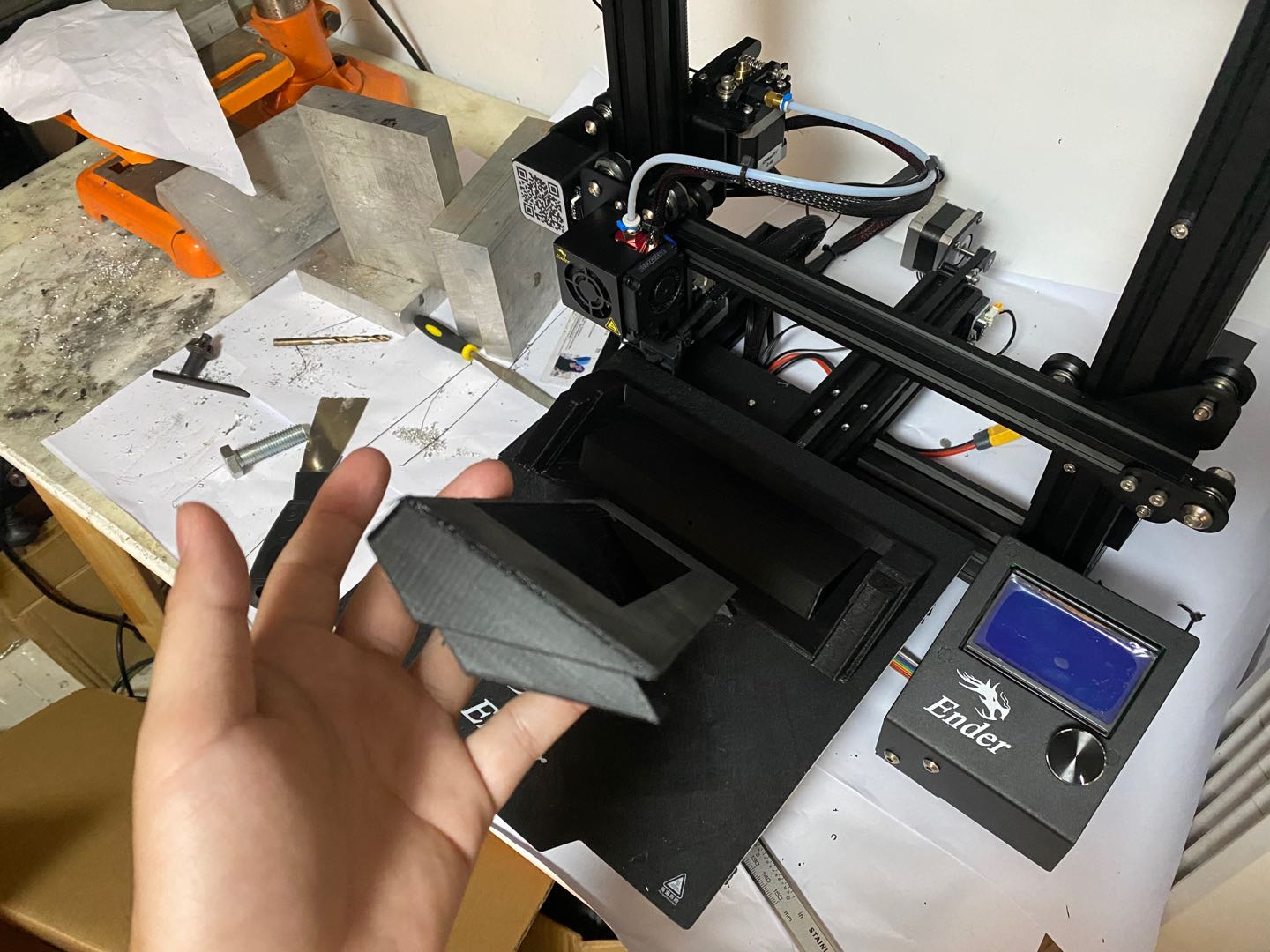

  1. 3D printed front&rear bumper
    total cost is around $500

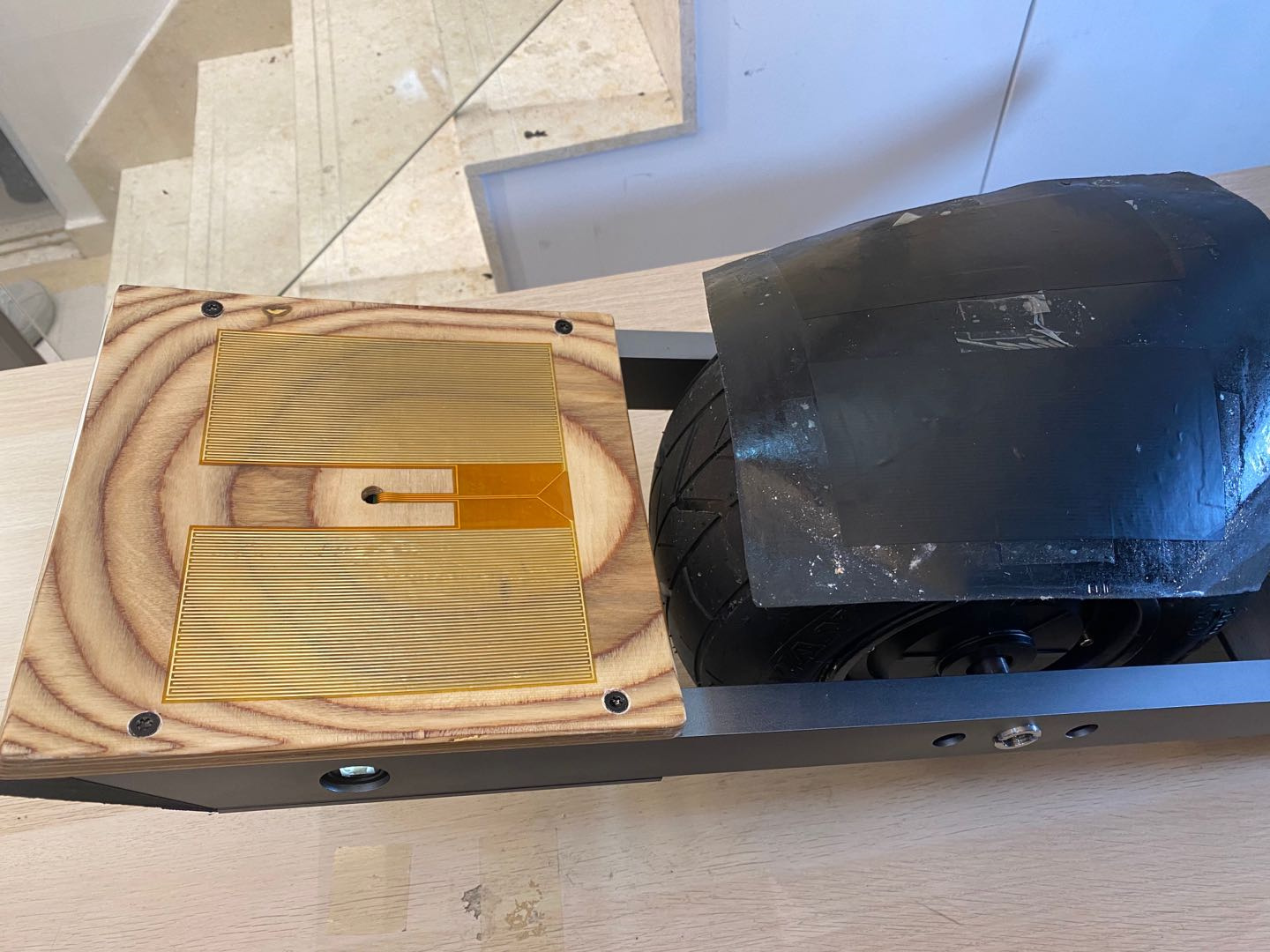

This is my footpad sensor set up, designed this thin flexible pcb and tape the velostat on top of it

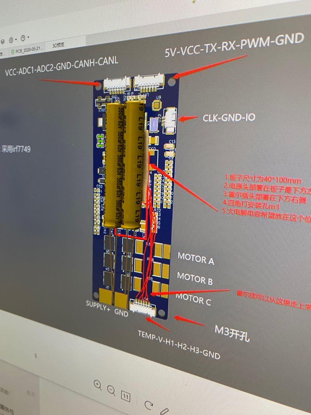

actually i’m using mahony, madwick is kinda shaky didnt know why, my trampa vesc6 wont conect to vesc2.09 after the loading the new firmware so i’m using 2.03 for now, also i’m working on my own vesc6 with onboard mpu9250
had a quick layout and it looks like this, the mosfet are gonna be irf7749 aswell dont wanna cheap out on parts lol. it has a strip shape so it can be mount to the side of the rail hence free up the space in the front for more battery.

Can you tell us more about your velostat footpad setup. When I tested it I could only get it to work with a spacer. The velostat sheet would just short the ADC and the 3.3V side. Do you use any additional (pull-up/down) resistors and what kind of values are you measuring when standing on the pad vs not standing on the pad.

I used a pcb which has 4 resistors on it as voltage divider, i didnt use any spacer, it works perfectly, even better than the ones on pint. its basically a flexible pcb which has 4 cables not touching each other, and the velostat shorts them to pull up the adc value, u can not just use them without a divider circuits. in my set up,step off is around 2.35v on adc1&2, step on is 3.2v both, i set the falut value to 3.0 which has worked great.
