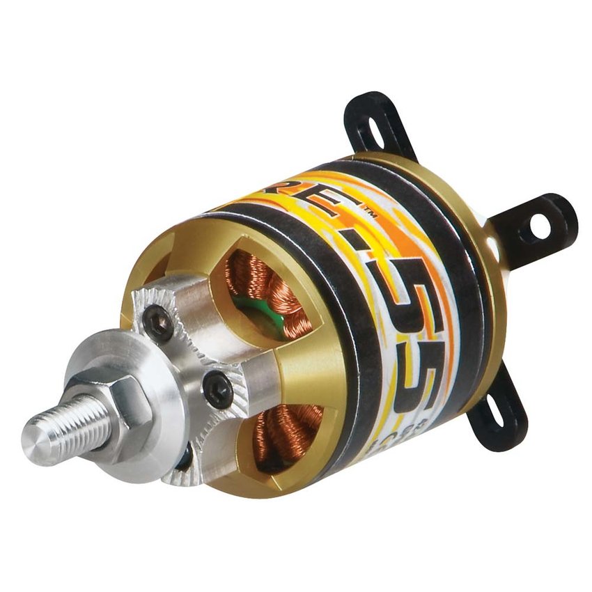

Except that looks like an inrunner and likely has fewer poles and will have less iron losses at 10k rpm than what we use.

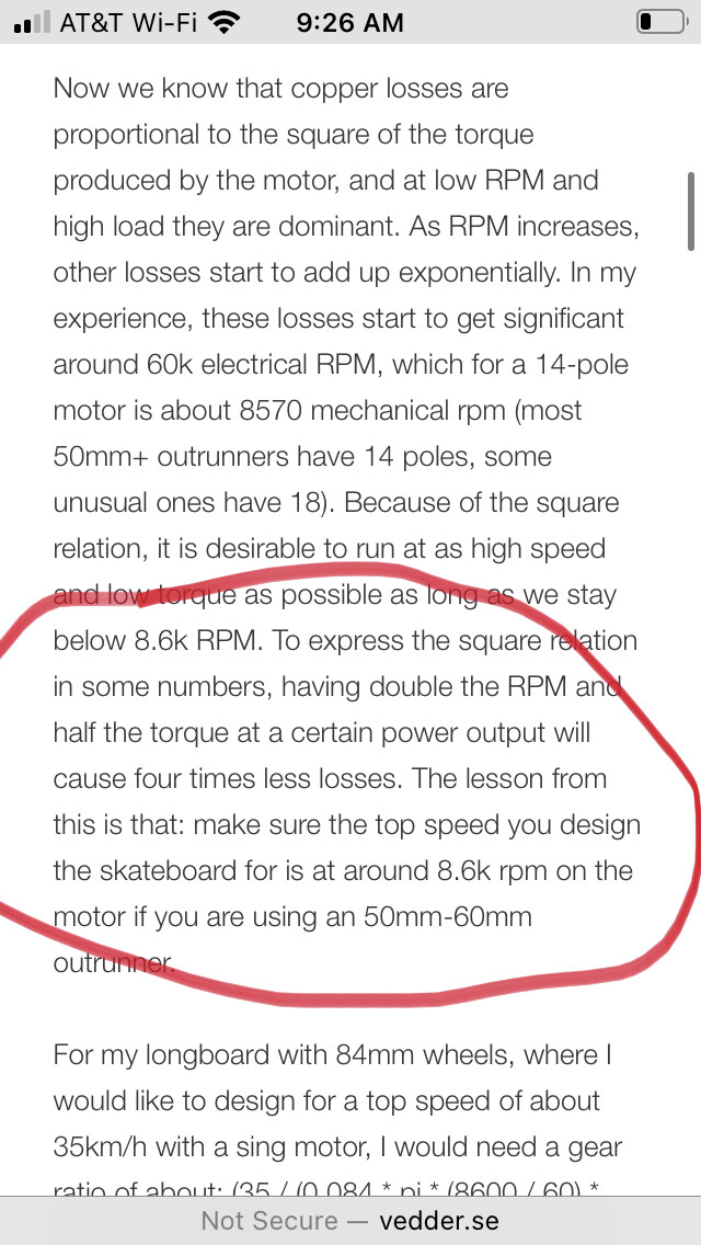

I think vedder showed 8k rpm was a top speed of our 12x14 motors before iron losses generally overcome copper when riding. But if ur an acceleration freak it’s probably worth going faster as your copper losses go higher.

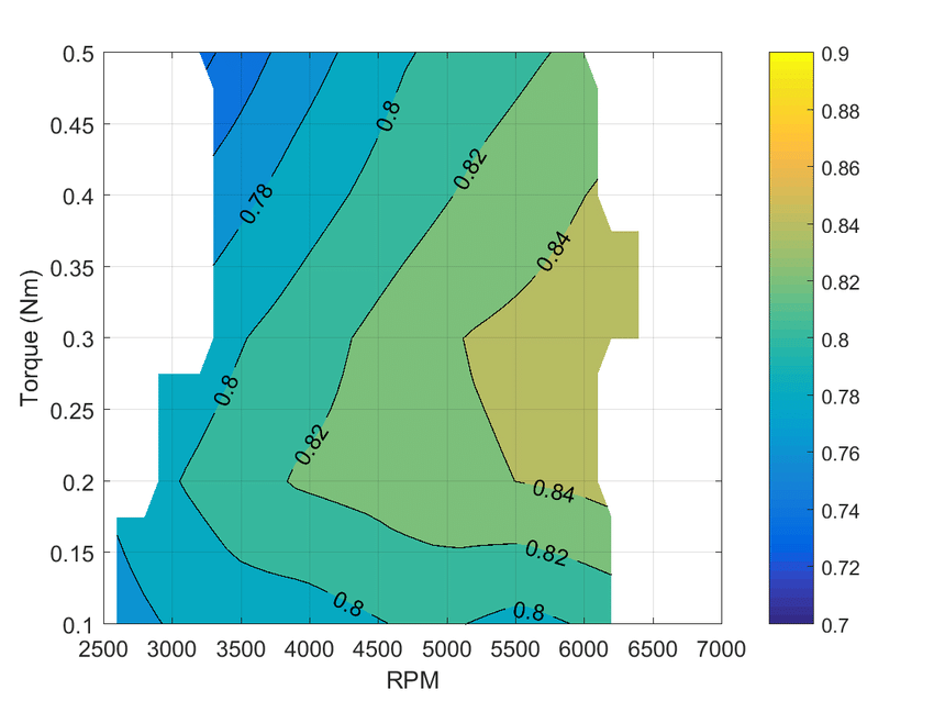

I looked at the paper, and that graph is simply used as an example of a graph that they would like to produce. It’s not an actual test of anything provided in the paper. That graph could be mapping literally any motor and have no relation to our esk8 sized outrunners.
I didn’t read anywhere it said what motor or how many magnets. It looks like an inrunner and surely had fewer than our common 12x14
this shows increasing efficiency with motor rpm at constant torque & above a certain threshold, decreasing efficiency with increasing torque…
https://www.researchgate.net/figure/Rimfire-55-Motor-Measured-Efficiency_fig3_326263042
http://vedder.se/2014/10/chosing-the-right-bldc-motor-and-battery-setup-for-an-electric-skateboard/
It would be nice to see the details and would depend on how hard you ride or what specific motor and one with .15mm laminations will be much more efficient at high speed than with cheap common .35 mm lams

So if your motor spins 8-10k rpm at the cruising mph, you have tuned for ideal efficiency.
with a 14 pole outrunner that has common .35 or maybe .25mm lams 8-10k rpm will likely be less efficient according to vedder. if u found a motor with .15mm lams that speed would likely be more efficient. But depends on the load and how u ride. Have to get data to really see
The motor in vedder’s description is most efficient at 8.5k rpm (below that speed the core losses are insignificant compared to copper losses under load), but going 18mph while the motor turns 8.5k rpm will be more efficient in terms of wh/mi than going 35mph while the motor turns 8.5k rpm because of the wind/rolling resistance.

So if all you cared about was efficiency & keeping the motors cool, you would increase your gear ratio (sacrificing top speed) such that your motor was turning 8.5k rpm at your avg cruising speed. You could do 8.5k rpm with 190kv & 12s.
