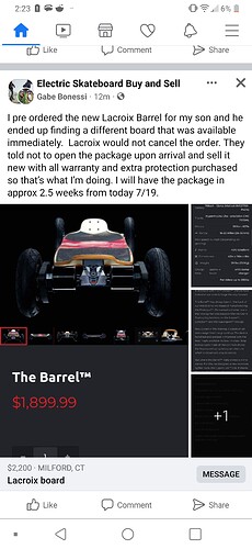

They told me they have a strict no refunds policy, but they made an exception since I had requested the order cancellation like 15 minutes after placing the order.
So they did right by me, but in general I think this is a very poor way to treat your customers / conduct business.
