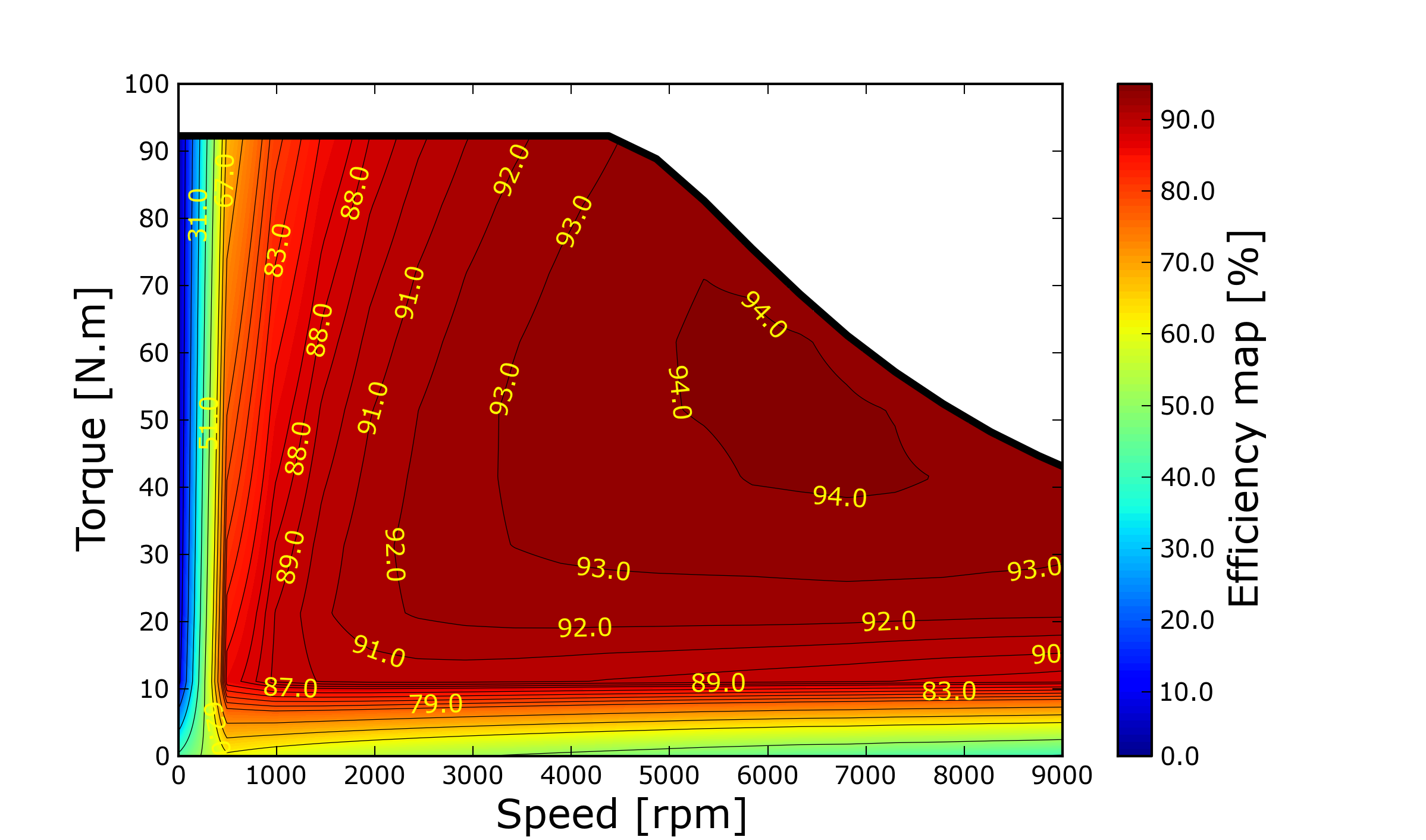

It takes a certain amount of mechanical power to go constant speed, say 30mph. Mechanical power is torque Nm times the angular speed of the motor rad/sec. If the angular speed of the motor is lower (bigger motor pulley) then it takes more torque to go constant 30mph. More torque takes more current. More current makes more heat. More heat means more losses and hotter motors. Gearing for higher top speed is less efficient at any given constant speed.
No you can’t generalize like that. The faster the motors is turning the more inductive losses you have. Motors have a efficiency curve that’s starts going down again when turning very fast.
No need to worry about the iron losses below 10k rpm.
If you have stupidly large motors or a 4wd you have very low resistance and higher magnetic losses.
For motors the size we use, losses other than resistive losses will only be significant above 10k motor rpm…
