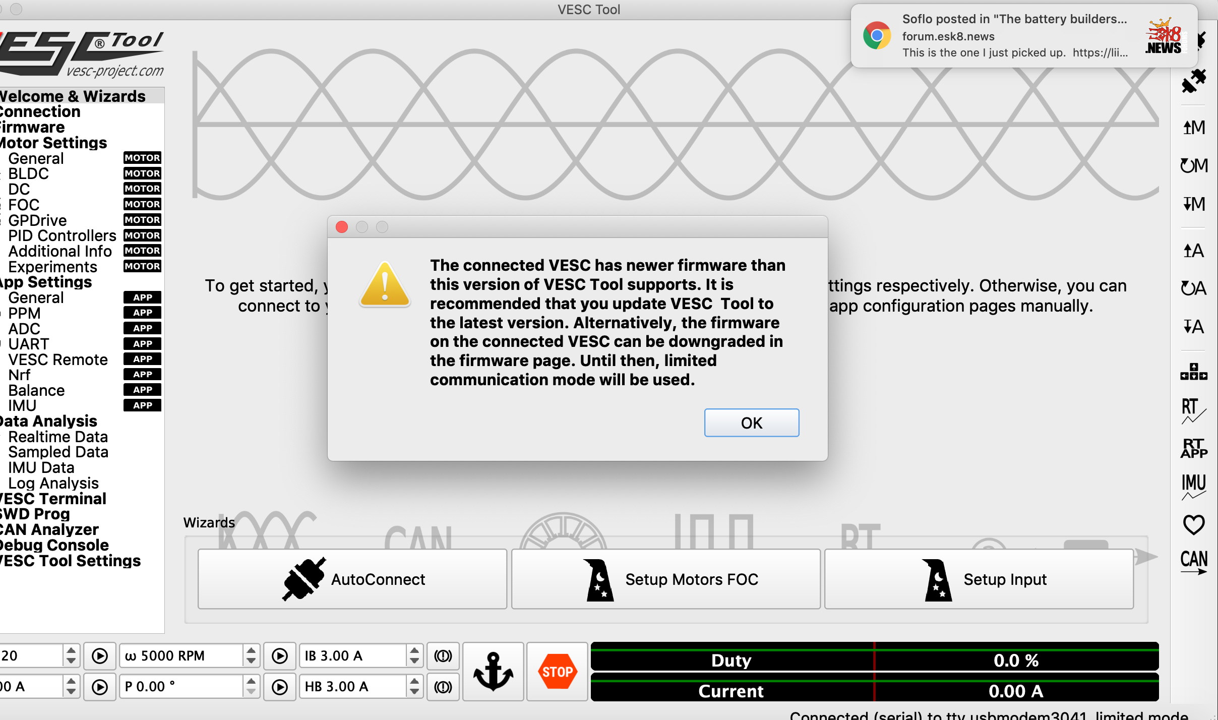

I get this
I don’t have an extra METR. Like a unity METR pro?
For the Stormcore you’ll need a regular METR Pro. What version of the Vesc tool are you using?
vesc tool 2.03. I think that’s the lastest available for mac. I also have an android phone with vesc tool app. and an ipad with stormcore app…So I ghave everything I need to install this thingie other than a metr pro? Maybe I have one around here somehwerererererer

I don’t know where I found it but I have 2.05 on my Mac so its gotta be somewhere on here

bluetooth even works from vesc_tool on osx.
I was hoping I could connect to the storm core with vesc app on Android but I couldn’t get it. Curious if anyone else has Benn able to. Maybe with an nrf module it’d work
I believe the Vesc tool only connects to NRF Modules. Looks like I’m going to have to use this trampa nrf module after all.
vesc tool android app should connect to the stormcore nrf module…

So there’s an nrf module in the storm core already that vesctool should detect?

Idk why I couldn’t connect earlier…I’ll have to pull my :cactus:outta my​:horse::tangerine:
