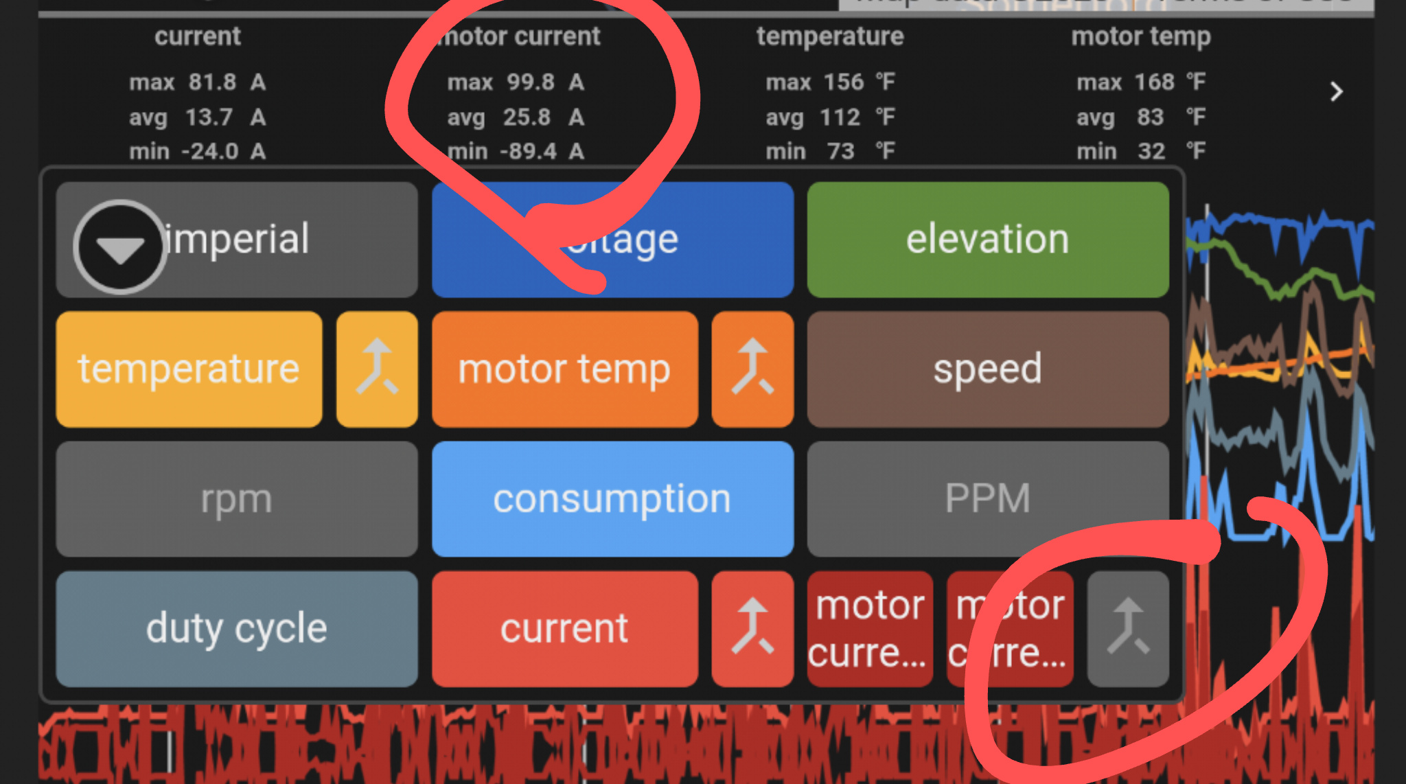

Was your consumption always in that ballpark? Average speed of 19kph with 29wh/km consumption seems really high.
That average motor current also seems really low
more volts = less amps xD
Actually for the motors if you don’t change the gearing the average amps should actually higher if he is riding at higher speeds
Yeah this is about right. I’m a big guy and I went out with the specific goal of abusing this setup to see what it could handle. Lots of full throttle starts and hard breaking. At points I pulled 100A per motor accelerating and 90 per side breaking. Not exactly efficient riding.
usually get better than 45wh/m but have logs of getting over 60wh/m on particularly hard rides.
@Pedrodemio motor amps seem to be off due to a bug in current beta build I’m running, causing second motor current to be reported negative. When metr combines both Motors data your seeing the motor current difference between the 2 wheels.
If you click to separate the motors data then metr shows you the real max and min motor amp values.
Checks out, not by a lot though, and that’s going from 9S ~45kph to 18S ~60kph.

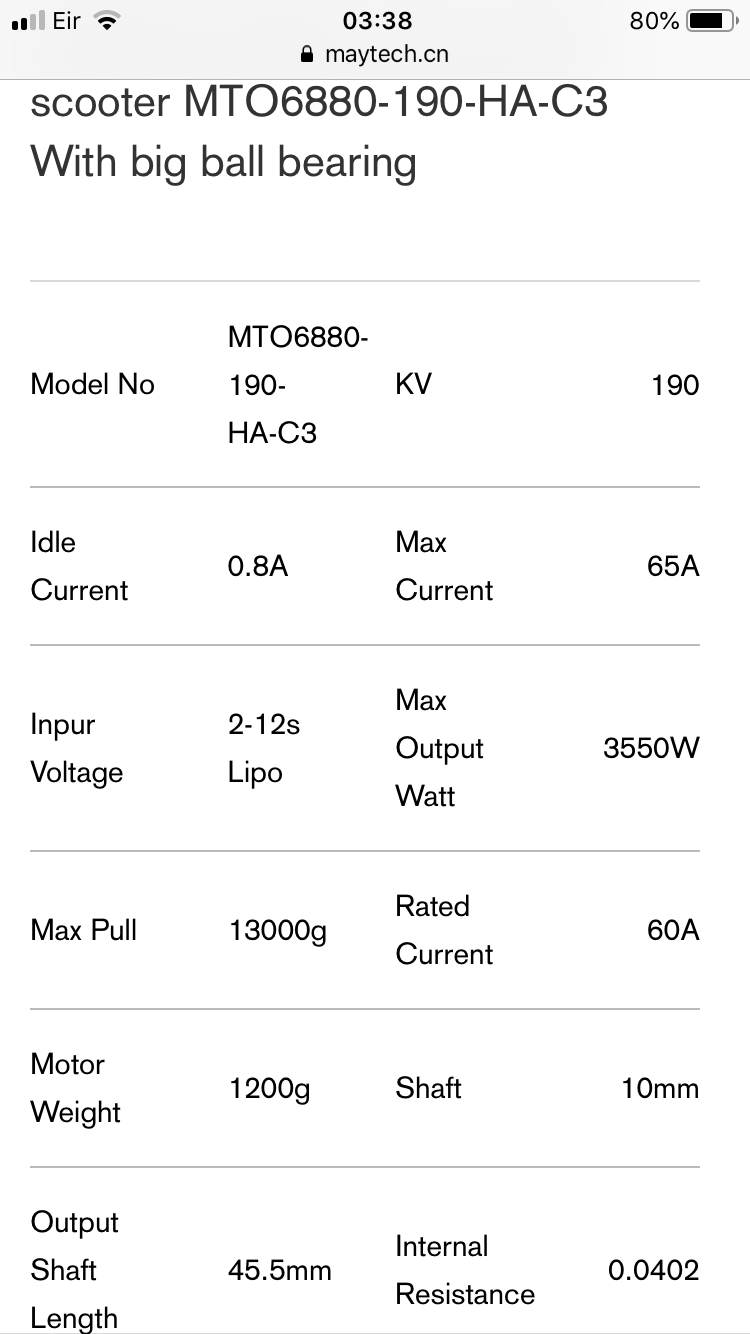

There was concerns raised about motors not designed with 18s in mind, how do your motors feel about this?
I see you’re running maytech 190kv 6880
Going out on a limb here, only because I see what motors he’s running, but could it be that higher kV motors specced for 12S does better than low kV motors when it comes to overheating?
