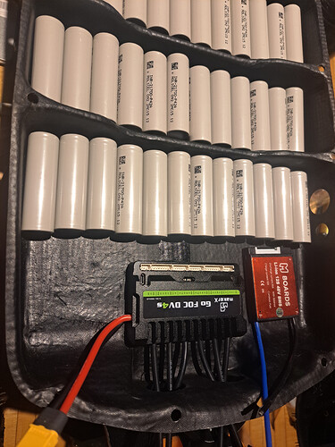

I will be starting a build with Lacroix Nazare deck and enclosure soon and wanted to see if a 12s6p battery was the most that is going to fit in there. Has anybody fit more 21700 cells in there? Its the first get enclosure, not the newer supersport one. First battery build for me but seems like there would be extra space but doesn’t seem super usable

12s6p will not fit if you’re using 21700 cells. That enclosure was designed for a bastard sized cell of 20700. That’s why lacroix switched to 12s5p for the nazare when they started using p42a cells with that enclosure.
If you get creative with placing p-groups you can fit 18s4p in that older naz enclosure. I believe @Skyart has done this and might have pics he could share of the layout.
If you have the 7 compartment enclosure, the VESC compartment nearest to the motors is huge. So you could even add some P-Groups in that compartment too (if you wanted to).
Get some 21700’s and just experiment with your enclosure to see what works best for you.
I think it’s only that last compartment at the front that doesn’t fit all 12 21700 cells flat. Is that right?
looks like you could definitely add one p group the ESC area, as long as you don’t have a big BMS, or can stack the bms on top of the esc?
I had a bms and sentinel in the way, so I couldn’t do that when I replaced my nazare battery a few years ago.
In the first compartment (closest to the front of the board), the a couple of the cells are not laying flat in the mock-up. But I think it is deep enough so that the cells don’t have to be perfectly flat and still be able to screw the enclosure down.
Yep, there is plenty of room in the last compartment (by the motors) to add another 12 cells, without having to stack the VESC and BMS. The last compartment is huge, and I might end-up using it for P-Groups also. Not sure yet.

Got it. Looks like a 12s6p build will be easy to fit then. Especially if putting 1 p group in the slightly smaller front and 1 in the rear with the BMS and ESC. Could even potentially put a 14s6p if you squeeze everything in. Thank you guys!
Here’s a picture of the last compartment with 12 cells in it. So you could probably do a 14S6P if you wanted to.

Its not. 12s6p won’t fit in the configuration you have shown it.
If you get creative you can stagger the cells a little, and that would allow it to fit, but you would likely still need a slight gasket.
