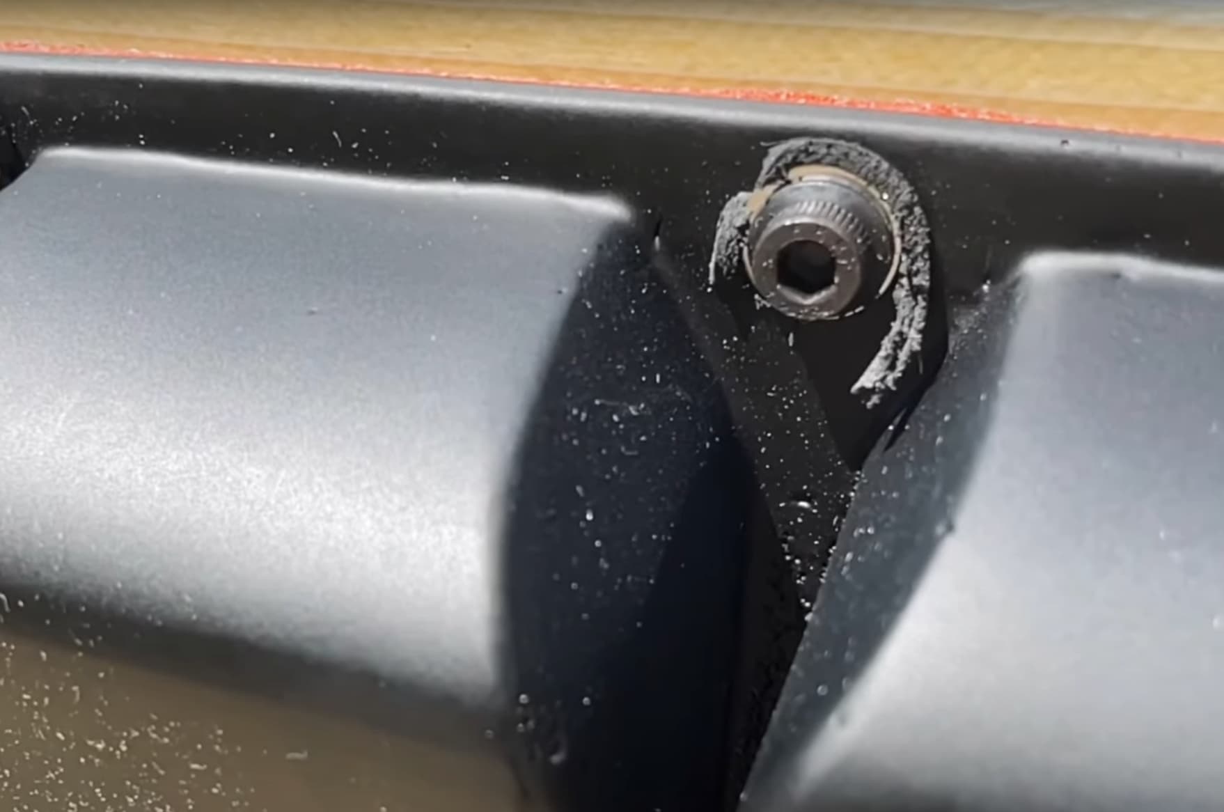

Does he make valid claims? Yes. It’s unfortunate that shipping was so delayed and updates were few and far between, and the use of rubber gaskets on the enclosure hardware without anything to protect them from abrading into nothing is pretty negligent. The battery sag issue is also pretty bad on lacroix’s part, it seems like their battery readout and voltage power cutoffs are running the cells down to absolute minimum, and they should have absolutely tweaked that to more accurately represent the usable percentage. I’m not going to discredit those parts of the review - that’s fair game and is something lacroix should absolutely work on, regardless of how much i respect them as a brand.

As someone with very little experience with anything like these boards, the washer thing was the only thing I found of substance in that review.
