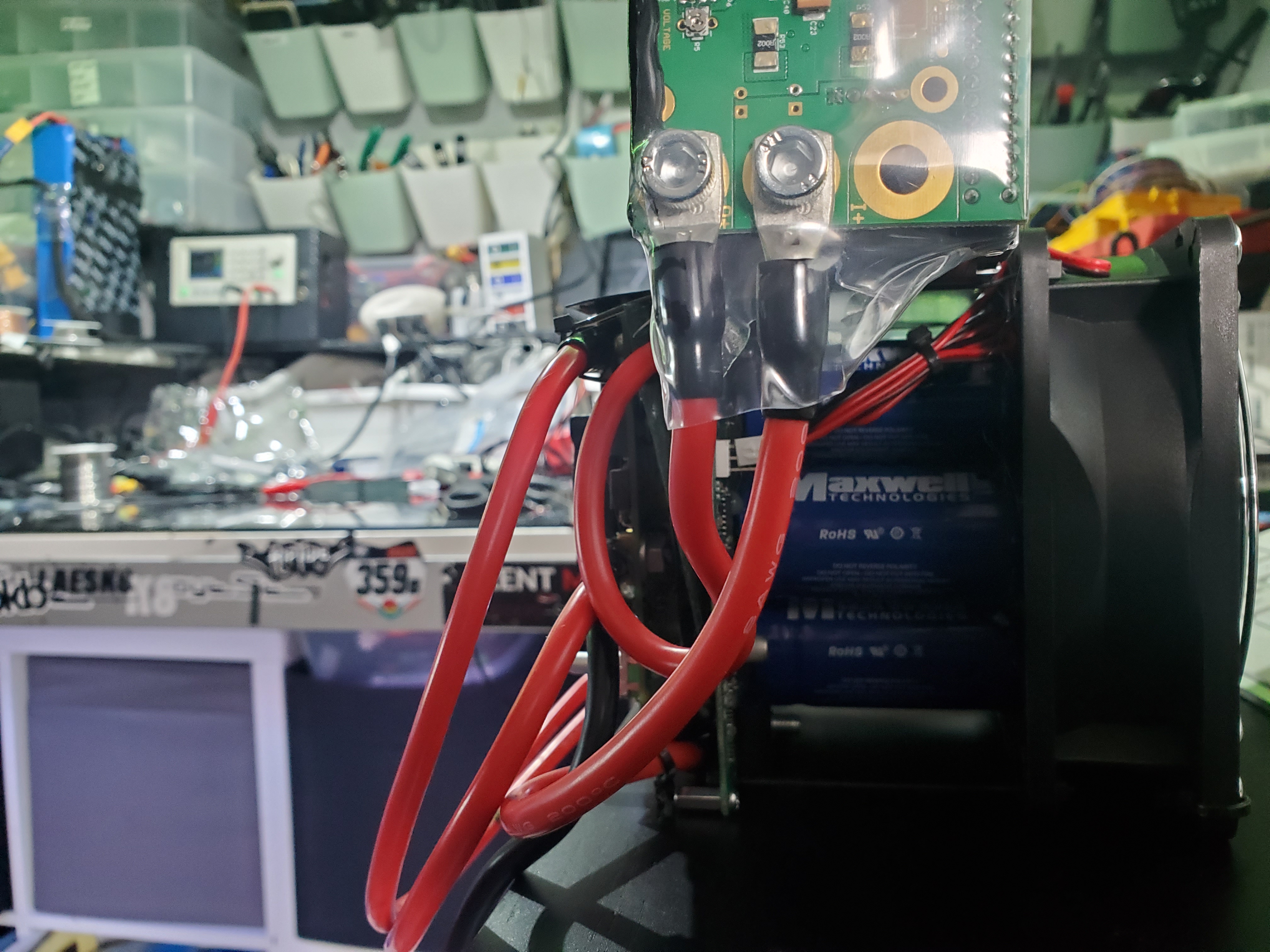

The only annoying thing is,. Even after you unplug the caps store voltage for hours. Even with my small fan on. I need to hook up a 10 watt dump resistor or something. It’s annoying :rage:
Nice build! @Annoyance, yeah I know. But a disconnect switch in the power line is prohibitive. I use to short the probes and make a few weld pulses, this will quickly deplete them down below 4V. A dump resistor (or halogen bulb) can do the rest then.
Yeah. I’m going to put a momentary switch and a few load resistors or a bulb.
.250mah fan still takes 40 minutes to discharge them
I think in the future , i’m going to add a xt60 for a dump to kill the batteries.
The fan control on kcap #1 is controlling the fan.
I made sure to add a diode, so when i manually turn on the fans, it doesn’t feedback into the PWM controller for the onboard kcap thermistor/ fan control
new with two kcaps, one ksupply, and one HP power supply, i can non stop weld .25mm nickel… Just need to add a second pair of electrodes so the others can cool down
Now 60 joules happens all at once, and less heating of metal, and actual 100 percent penatration. A single k cap could not do that. At least on .25/.20mm. A good lipo could do that, but I’m sick of melting lipos with 800 welds in a sitting
