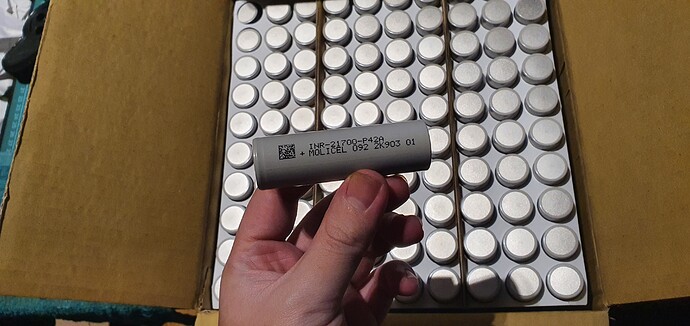

Some oddly satisfying battery pics for ya

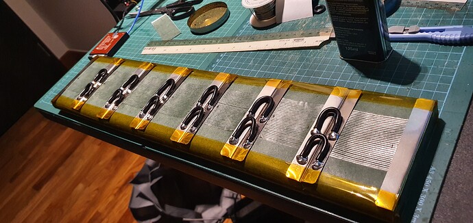

Last week I got some free time so I finally built the 12s5p P42A pack. The 30mm nickel came but wtf it came with a bent. Luckily it was able to bend back straight without any kinks. Enjoy the battery build process! Its my first time doing the folded nickel and silicone wire method, so the first couple solders were not great. The rest afterwards were alright.

So I had to change the location of the charge port and power switch so that it does not hit the unity and phase wires.
First test ride! Wow, 12s is really something. I also set my battery max to 150A, 75A per side.
