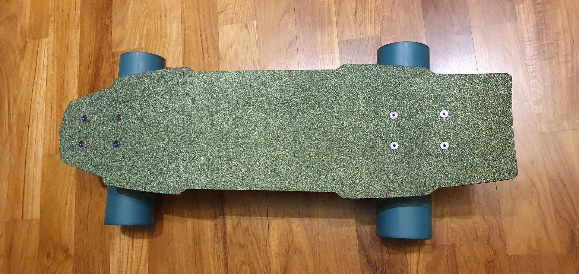

I’m making this one a bit lighter, and going with a 10s1p P42A pack, a flipsky 6.7 mini, and a reacher 6374. Other things to make it a little more premium are the BN 145 hangars and 48 deg baseplates. Titanium bolts, all that jazz. I went with the Mach 1s and dyed them green, because i will never use white wheels…
Okay, enough of that. Some pics!
Dyeing the wheels
The Orbiter Deck with the wheels

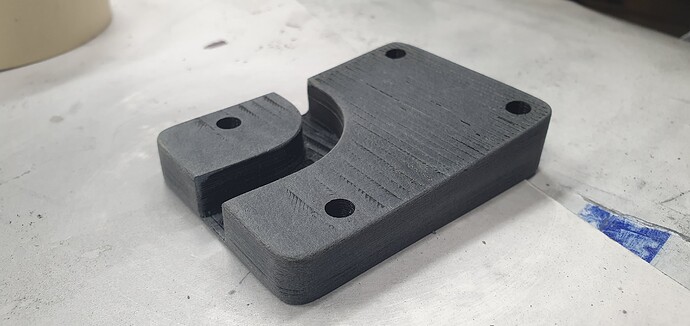

@JoeyZ5 was very kind to send me the model of the riser that he used for his Orbiter build, and i got help from @Venom121212 to edit a groove so it’ll function as a tunnel riser. Thanks guys!

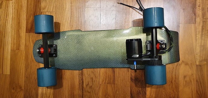

All of the parts. I’m going with a belt drive for this, as there is no gear drive available that would be compatible with the Mach 1s.
There’s the mock up, i’ll have to cut the motor shaft shorter so it’s flush with my motor pulley, then i’ll install it inside the riser properly. Stay tuned!

Might want to extend the motor shaft, that way you prevent a slipping drive wheel. Cool build!
What am I seeing here? One motor but 2wd??

These look amazing! How did you keep the yellow parts from turning blue? And the white outline whaaat? Some kind of sorcery!
This is super interesting…
The parts that did not turn green are screen prints on the wheel. Those do not absorb dye so hence they retained the color for the most part.

Not quite, I replaced the shaft myself and it’s quite a bit longer, but yeah, something like this. It’s also really easy to do, and makes single drive boards a lot more drivable.
