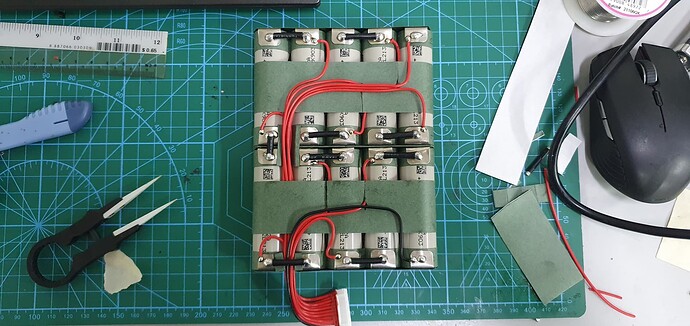

Starting work on the battery. Im going with one piece of 14 AWG for the series connection since this pack is going to pull 30A max. So downsizing on it would be better construction wise. Now how the hell am i gonna route the balance wires on these neatly…

So turns out balance cable wiring is really difficult to do neatly. An attempt was made.

Waiting for 14 AWG wire to come so i can finish up the pack and solder everything together. Then measure my space, and start the enclosure.

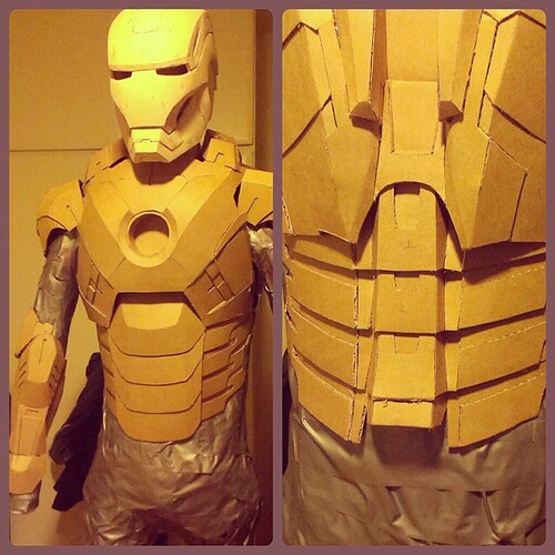

Back in 2013 before i had a 3d printer and all, this was the ‘poor man’ method of bring 3d model to actual artefact. It basically takes a 3D model, and unfolds it into paper, then you do a bunch of clean up to get the pieces where you want it to, print onto paper, cut paste, and glue.
There are also alternate ways instead of paper like using cardboard, foam etc.
For simplicity’s sake when cutting and gluing the paper pieces, the chamfers and roundovers were removed from the model. So the current shape is more sharp and polygonal. No worries, I will be sanding this later anyway.
Let me show you what i did back in the day!
17 year old Linny was very ambitious, doing all these in the bedroom
