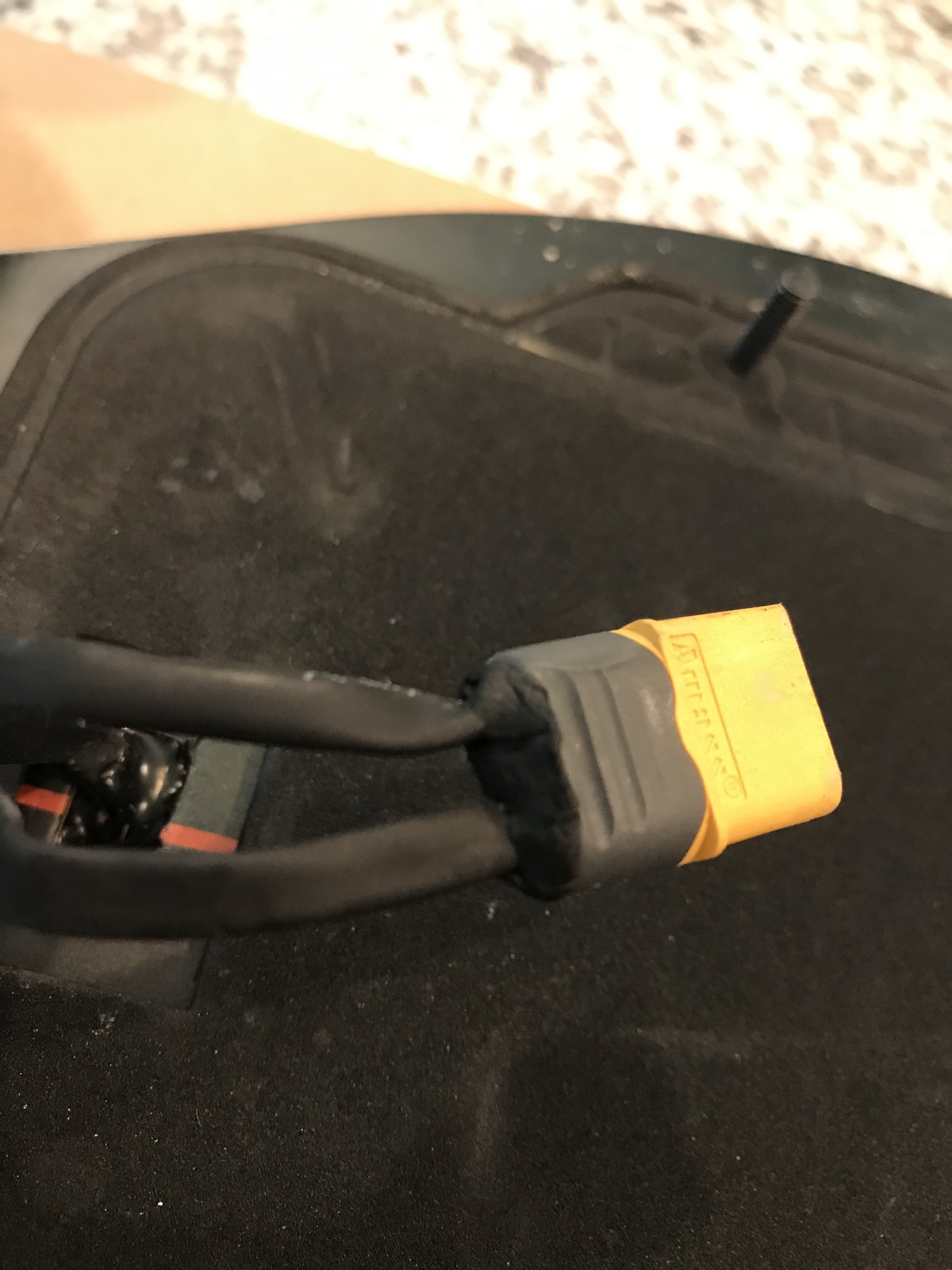

Well, I’m up to 180miles on the V3 now. The noise from the motor is still there but its still going strong, but I developed a charging issue. I always charge before heading to work(about 25% up to 100%), every workday. But on Tuesday the board and charger showed 100% and I set off, but right away I got a vibration from the remote, showing the board battery flashing. I had to manual push halfway to work, not bad but tiring lol!. I couldn’t test with my Wowgo charger because the plugs aren’t the same, so I opened the battery cover on the V3…
Yeah that might need some help

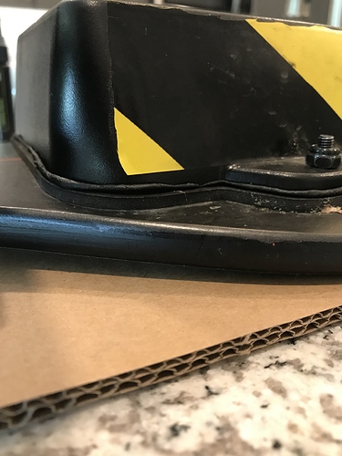

So After seeing the corrosion and the broken wire, I cleaned everything and then used a small heat-shrink connector to fix the wire. Tested that it now charges again, and then started sealing and securing the connectors with butyl.

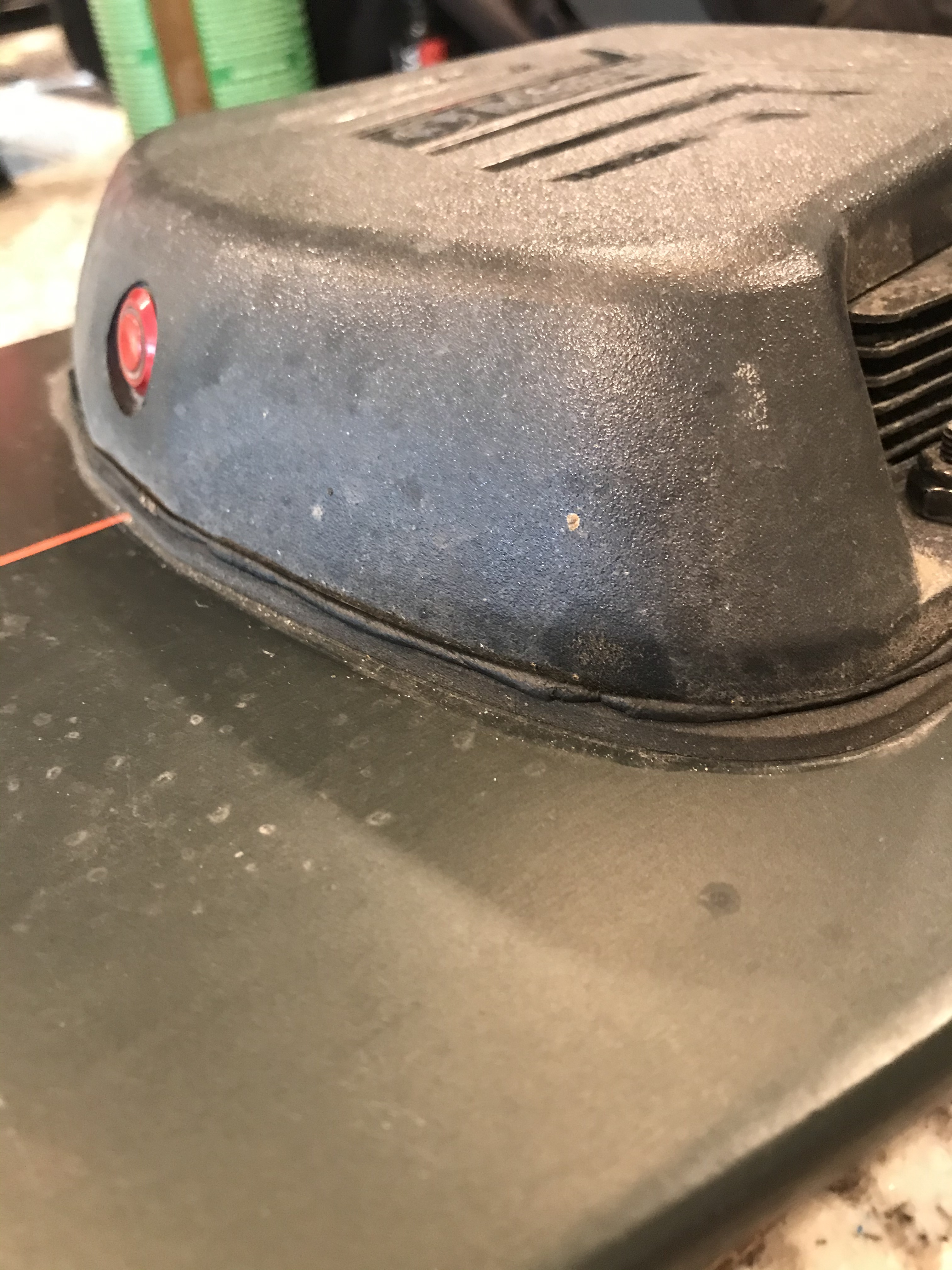

I opened the ESC cover to check the connectors as well, but they looked good. I used the rest of the butyl to create a gasket around the battery and ESC cover. I have continued my normal use of the V3 and am happy to report no other issues since the repair.
Learning leason here, seal up your board properly if you regularly ride in ALL types of weather. lol
