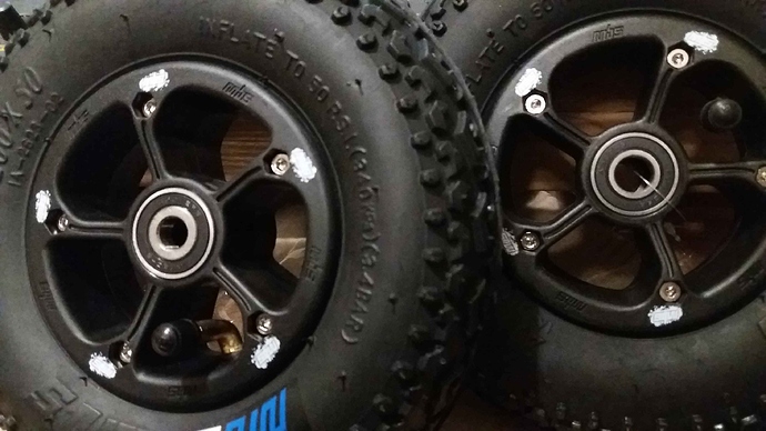

Ding-dong!
Looks good beside the fact that I also ordered 6x 9" tires which I wanted to ride tomorrow but no 9" tires inside, only the 9" tubes, damn.
However life goes on… ups wrong bearings inside one wheel :sweat_smile:
Changed them to 12mm ID bearings
