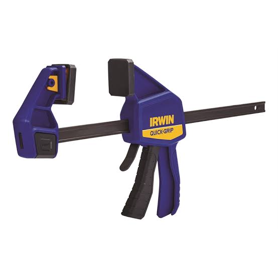

How do you switch dampa’s easily? I could only manage to put the green ones on the back of my board today. Springs are way to tough for me! I only kept the rear ones in for high speed stability, but we will see how it works out when my build is done. I wasn’t able to get both on in the front, only 1.
How my rear end is… and I weigh 170 lbs, which is in the range of what trampa recommended from the guide. I should’ve gone with a lower durometer.
My front end also feels really small as well (spring only), but I can’t say for sure until I am all powered up.
With it you can press the side you placed the first spring down. Makes it easy to place the spring on the other side than.
