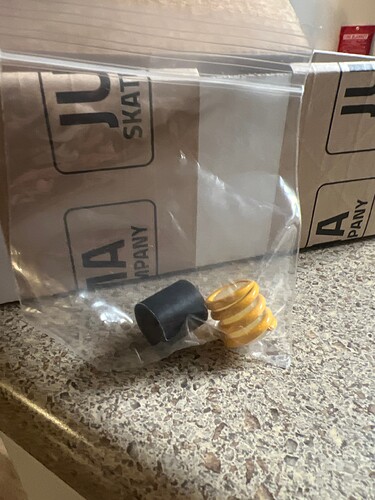

Anyone know what happened to the rebound adapters?
They didn’t come with my truck so I assume they have to be bought separately, but they aren’t listed. Maybe I’ll 3d printed an adapter to that works with ordinary bushings. Since it’s not necessary for stability The consequence of it breaking is significantly reduced.
Just opened mine, both rear and front came with the adapters so I’d email about that.
Those aren’t the adapters, these are:
More
That photo is of the bushing plugs which go inside the truck not the rebound adapters.
Yeahthatperson’s thumbnail shows the caster and rebound bushings. Do you have those?
Ah ok. Then no I haven’t seen those either.
I think we can print them out of tpu.
The rebound adapter consists of a riser, mounting brackets, bolts, and the actual rubber rebound bushings
I’m thinking a thin sock around the caster block at 100% infill then the actual bushings on the side printed at less than 100%.
