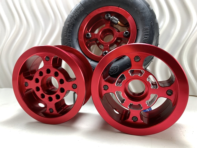

Janux Quattro Hub 4.25" to fit 8" tires, Trampa Urban Treads and Gummies
More details can be found here, https://www.janux-esk8.com/product-page/janux-quattro-4-25-hubs-for-tbdd-or-elofty
Size comparison: 4.25" vs 3.25" hubs
4.25" hubs fit 8" tires, Trampa Urban treads and Gummies
3.25" hubs fit 6"x2" and Bergmeister tires
