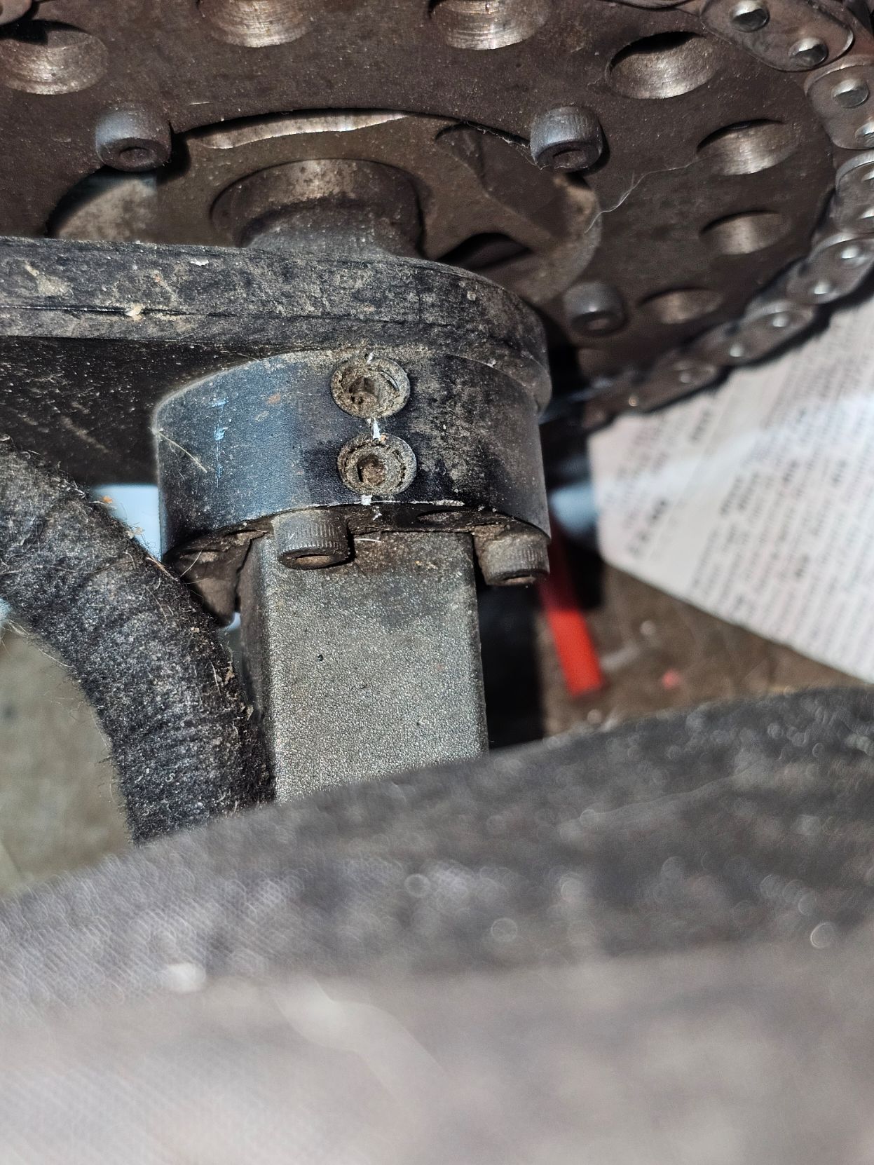

on the grub screws

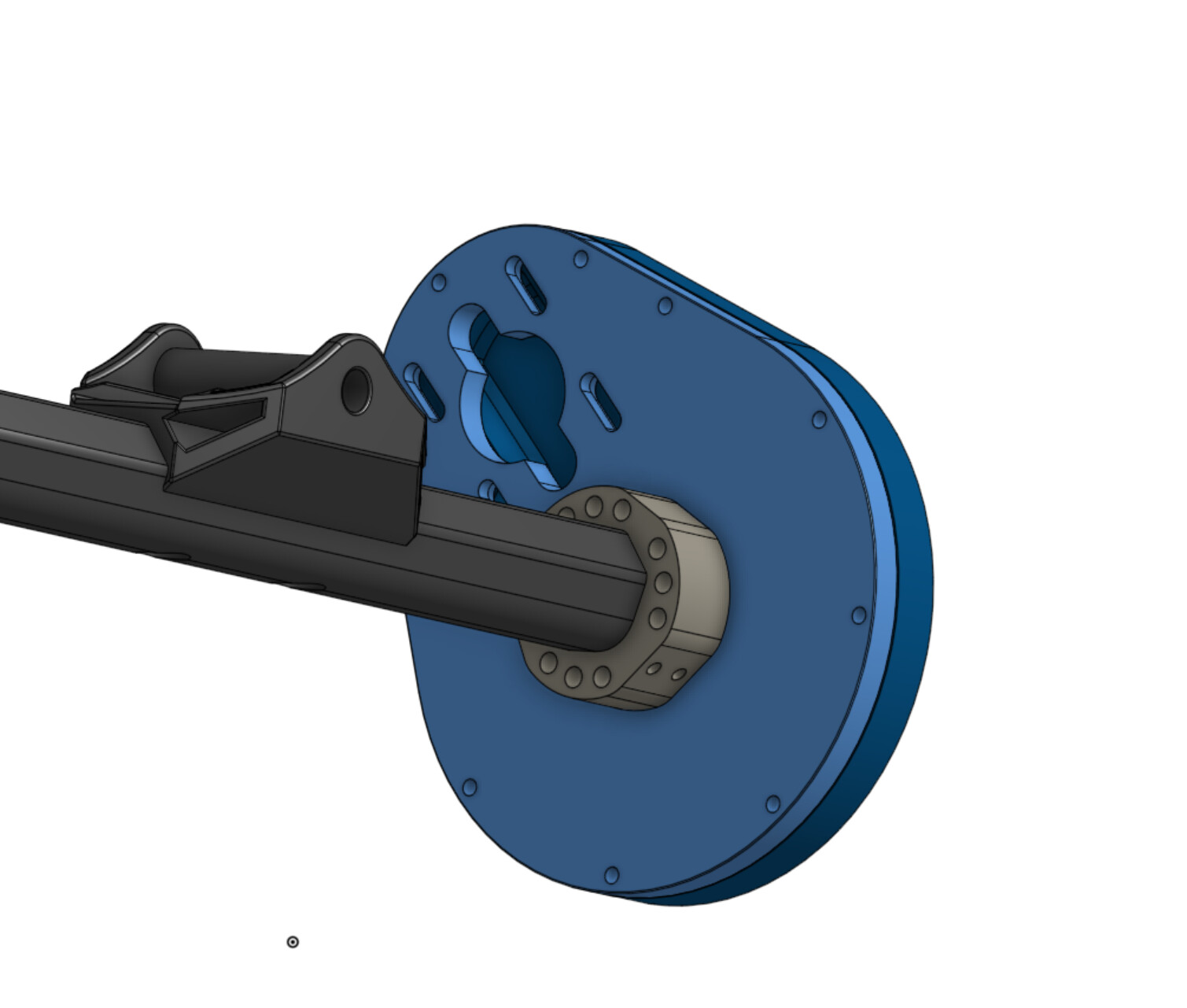

Interesting. Maybe a longer (deeper?) collar would help with this? How many cases of this failure mode are you aware of?
Looks like that will always be the weakspot, even if strengthened.
How about an optional, additional secondary clamp exerting force around the perimeter, hose clamp style? But a refined low profile design.
Belt and suspenders redundancy for confidence and longevity
It’s anecdotal, but both sets of those clamps that I have are not cracking. They have some dents from hitting rocks but other than that are still in good shape. Two other sets in our group are also crack free.
yeah would only need to be a few mm but would help massively. the wall is just too thin.
just mine it happen 6-8month ago and not ridden since

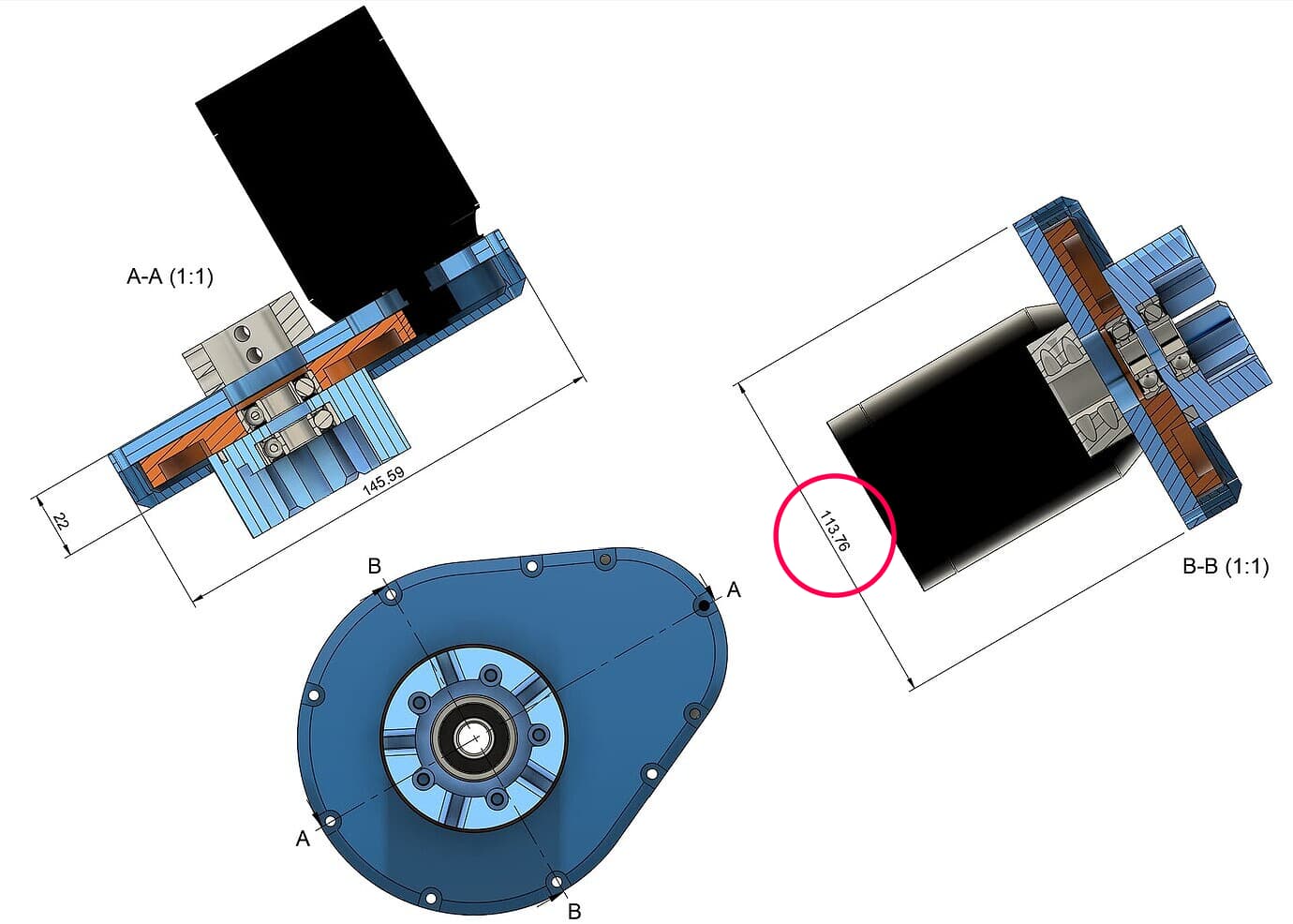

is there not enough axle length for thanes, or is it some other factor
The size of the gear casing
