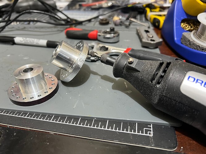

So excitingly my milled adapters came in early. They’re pretty close but still had to dremel here and there to make things fit properly.
Was to eager when tapping and snapped the bit. Had to run to the hardware store to get more taps, and go slower.
Mounted and loctited, time to let things cure.

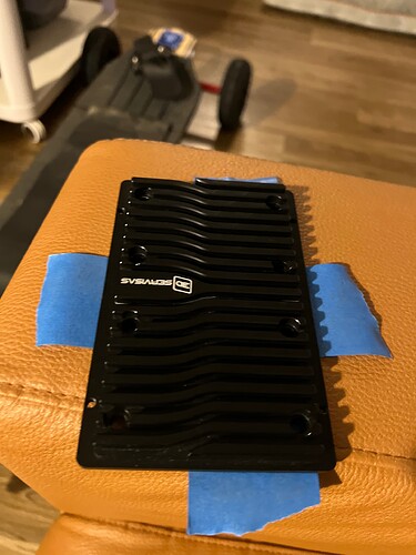

Was up to about 3am trying to slowly and quietly (hard to dremel quietly) install a heatsink I bought a while back. Ever since moving to BN AT drives 3.95 ratio, 205kv reachers, and 175mm tires my Stormcore 60d has been struggling to stay cool on relatively easy rides. Touching nearly 80c on a cold and wet day:
Those reachers though definitely staying cool :sunglasses:.
While I had it opened up decided I’m going to throw the WavRX iRemote and iLogger in there, since its incompatible with MakerX ESCs. I can connect the remote to the receiver, but still need to set it up. Left the puck receiver in there for backup/if I’m too lazy to set it up right now (real reason).
Also, learned dropping the rear drivetrain off the kingpin not a bad way to go. Granted my cables are clipped into those loaded clips making this easier.
Still have to put the board back together this morning and clean the mess I made. Wife’s outta town so I hijacked the living room :joy:.
Not the same distance but I’d say that’s a significant improvement…
Before:
After:
