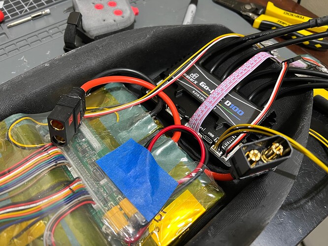

Sooo close but no cigar on finishing the battery tonight. Need to wire up the charging on the BMS and batt, then wrap it up and should be good to go.
Had to spend a lot of time extending balance wires as they were too short.

Alright mostly finished with the battery got the BMS in there. Using the Ennoid xlite v2 as mentioned above. This is a recalled version and getting a replacement from @ENNOID. I was informed this is still usable I just have to be very careful so, in it goes. Great customer service.
Next needed to swap in the beefier QS8s and then cross my fingers that all would go well.
It lives!!!
Threw on the motors so that I can see if all goes well. But for some reason I thought I’d be able to use Metrs BT to connect to the Vesc app, wasn’t the case. Did successfully run motor and sensor detection through Metr though.
Still a lot of things to button up like power button, charge port, splicing the can cable for a different remote, mounting, etc. But calling this a win for tonight, need a break and just ride.
So I done fucked up and set myself back a day. I noticed I had the connectors for the xlite BMS charger and battery mixed up. So, went in and fixed that… then while measuring voltage to see if things looked ok hand went limp (I guess) and I shorted the board… which blew the shit out of it (fucking couldn’t believe myself).
So, I had to swap in an LTT (LLT?) smart BMS which is actually what I was originally going to put in anyways (it’s a chonky mf). But that meant needing to do the balance wires again and other stuff. Anyways got it in there and we’re sailing smooth once again.
Also, mounted some Tee Nutz so that I could use my s2 binding as well as a foot stop (not pictured).
Lastly, blue loctited and greased up the gear drives so that they’re ready to mount. Now I need to mount the enclosure and seal it up. Program the VESC and hopefully get a test run before weekends end.
