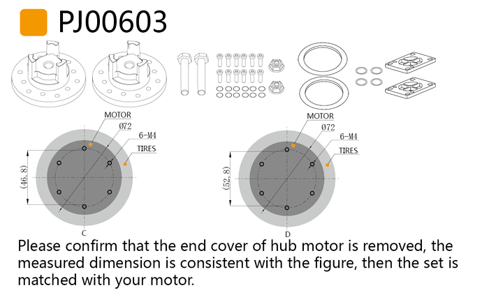

are you able to make an adapter that fits all of them?
something like this with offset holes:

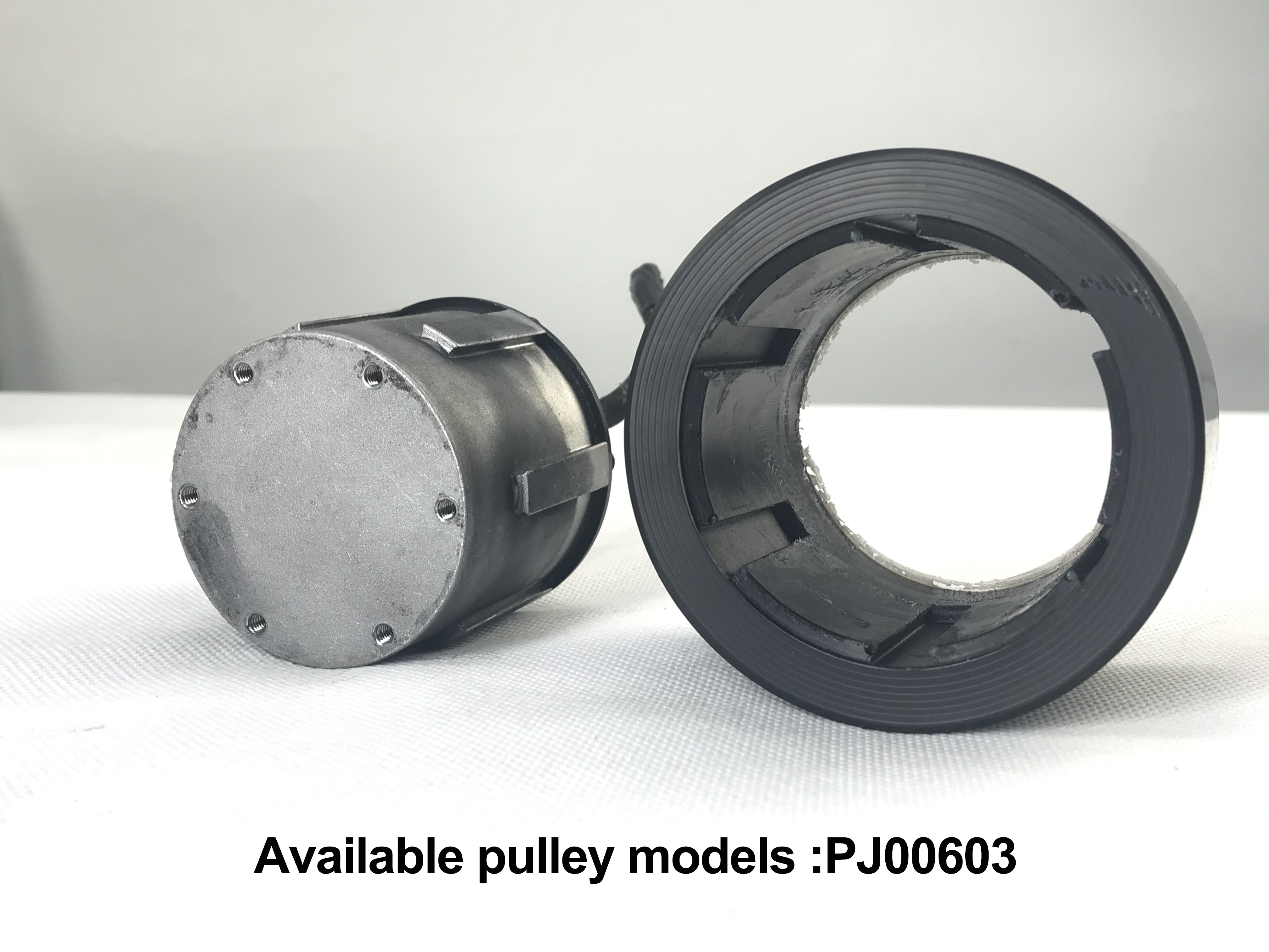

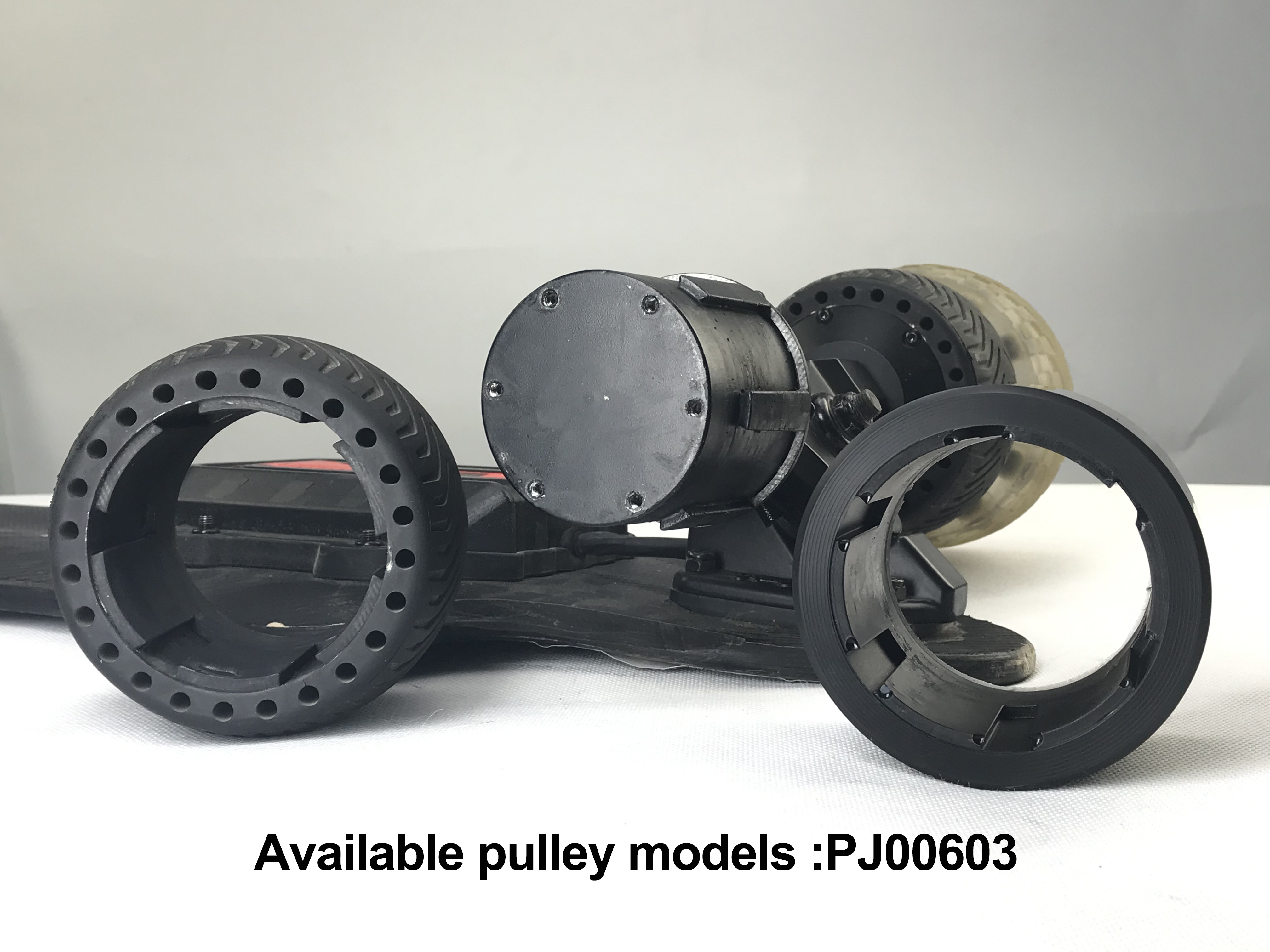

@hide my hubs fit model PJ0063.
@Hide I’ve also got PJ00603

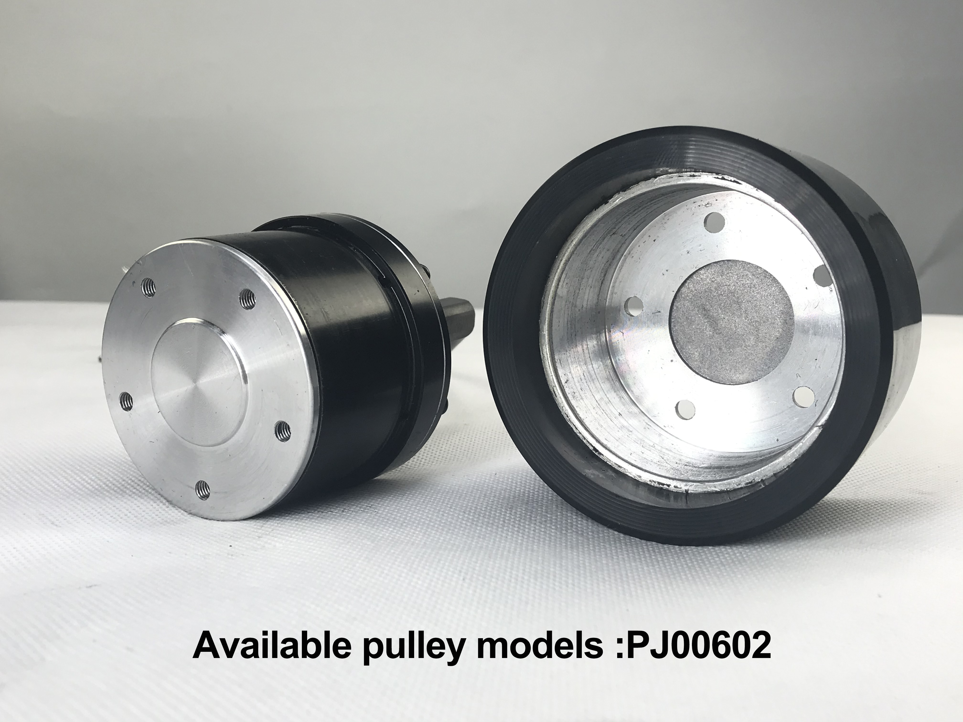

I have a backfire mini with PJ00602 pattern I can test on.
My backfire g3 also has the PJ00602 layout and I’d love to test
@Hide The original Wowgo 3 hub motors and the AE Board 105mm honeycomb (AX2) hub motors are both compatible with PJ00602 fig. B
