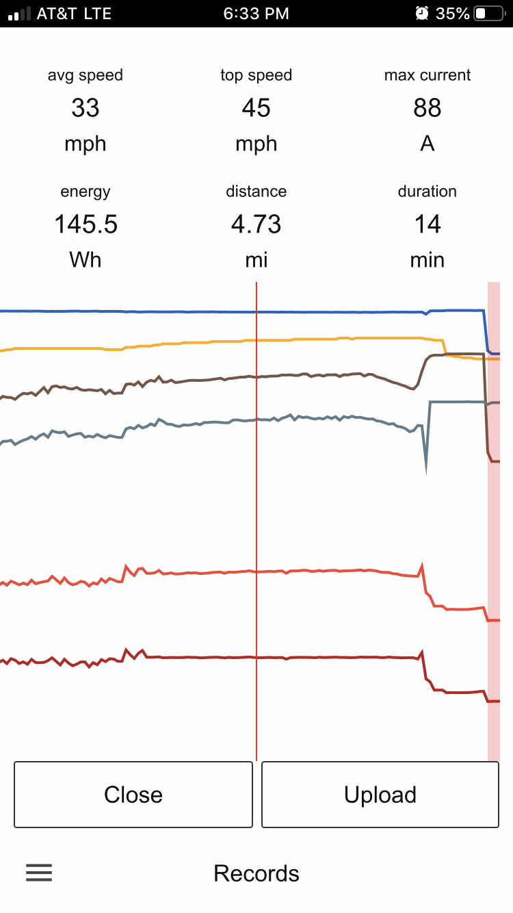

Idk how to upload records but that’s what my metr records look like right before the crash

Oh please sort out how to get that record uploaded would be very valuable. Do you have the internal BLE module or external from metr?

Internal. Unity one
