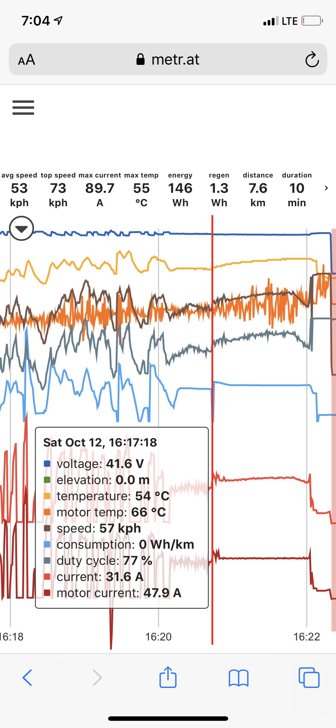

Issue With Unity and Metr.at Module while Logging data

it looks stuck at constant motor current not constant speed…

Hm ok yeah so this isn’t cruise control which is good to know. The motor amps got locked to 40.5 which would be consistent with the ppm getting locked. The only question now is whether the reciever was continuously sending that ppm value corresponding to the amperage or if the unity locked it in for unknown reasons.

Can you try slamming throttle around on the bench? See if you can get it to glitch again? If it’s possible to repeat it gets really simple to diagnose.
you can see the motor current line is more flat than the speed during the “issue”
Yeah. It’s odd. Specially since it happened right after the fw update

the “consumption” line momentarily drops to “0” before the motor current locks at 40a…
Yeah this seems to happen a few times during the log. doubt it’s related I think it is probably just an incorrectly interpolated datapoint or something.

the other dips i find in “consumption” appear associated with actual drops to 0 motor current
Yep, good catch.
It looks like the unity was able to continue reporting data through metr so I doubt it. the best thing would be if he could get it to glitch and unplug the receiver. If it continues on in glitched state its unity side. You might want to run metr log when running such a test, its best to reproduce same circumstances.
