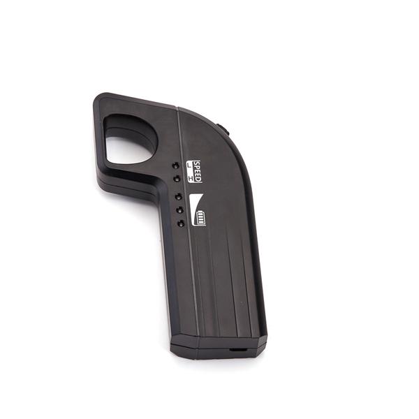

FYI, lots of remotes provide this feature. Although the Hoyt Puck does it better than most.
Their implementation is awesome. Love how doing that affects current and (at least on my RC ESCs) top speed as well.
Do you know which other remotes have this?
Benchwheel remote has a low and high setting. Works really well

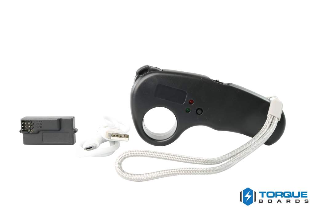

The Torqueboards Nano, FlipSky VX1 & Vx2, the Benchwheel remote, most remotes in fact.
All easily accessible like the Puck?
Yeah, to one degree or another, they are all buttons on the remotes.

VX1’s modes only changes the acceleration and NOT top speed. (You’d still get to your top speed slowly)
@mmaner is saying the hoyt puck remote is the same
So there is still no way to have a vesc remote that has modes that adjusts acceleration AND speed? (Essentially what the chinese esc’s do)
My VX1 doesnt do that. Modes, across most remotes, function by limiting PPM output. Like the Puck, mode 1 is 70%, mode 2 is 85% and mode 3 is 100%.

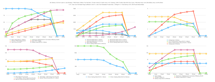

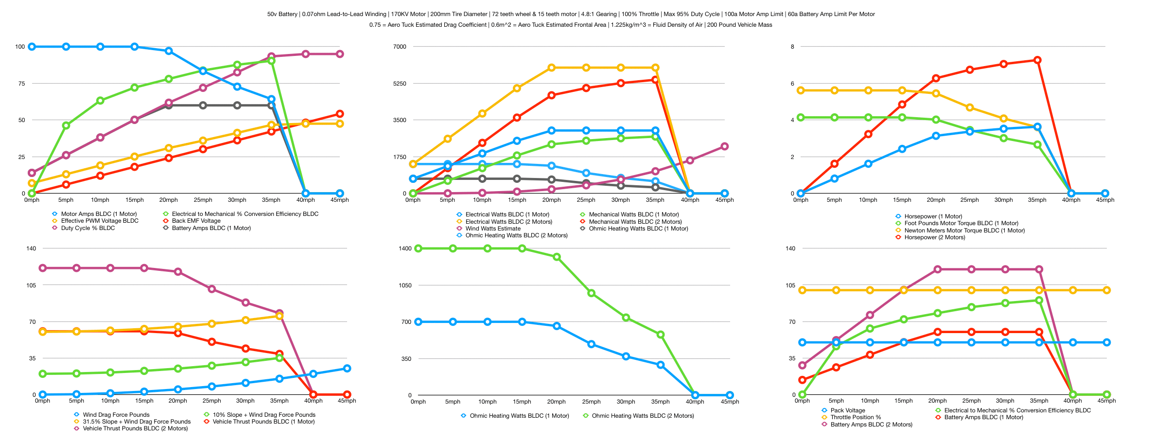

it takes much less current to sustain constant reasonable speed than is used during typical acceleration, so limiting speed in this way would limit your acceleration dramatically. and forget about hill climbing. the best way would be to limit the duty cycle to less than 95% in current control mode, in my opinion. limiting duty cycle to 50% is equivalent to changing the battery voltage from 12S to 6S, from the motor’s perspective, without sacrificing torque during acceleration, and without increasing the battery current required for that torque.
this shows the effects of changing the duty cycle limit from 95% to 50%, without changing any of the other settings or hardware:

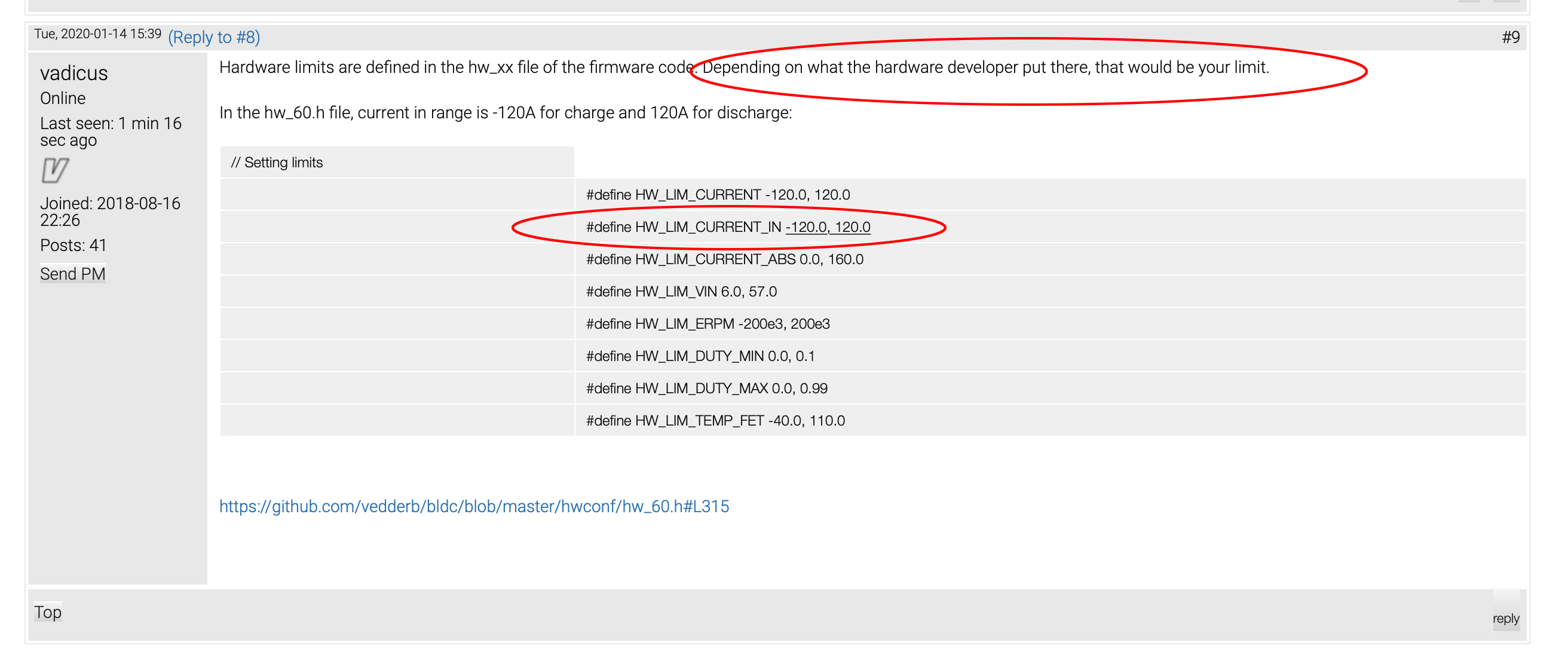

@Chricious if you are using a dual controller it’s possible your 120a bat setting limits each motor to 60a bat…
if that’s the case, then changing the bat setting to 200a and leaving the motor setting at 100a, would give you 100a bat and 100a motor per motor, which in theory would enable you to retain all your torque and have full throttle range and torque at the higher speeds.
if the bat setting you referred to is “per motor,” then it depends on what the following firmware limits are that the hardware developer chose in your particular firmware for your controller…
^CURRENT_IN would refer to the firmware battery current limit for your hardware

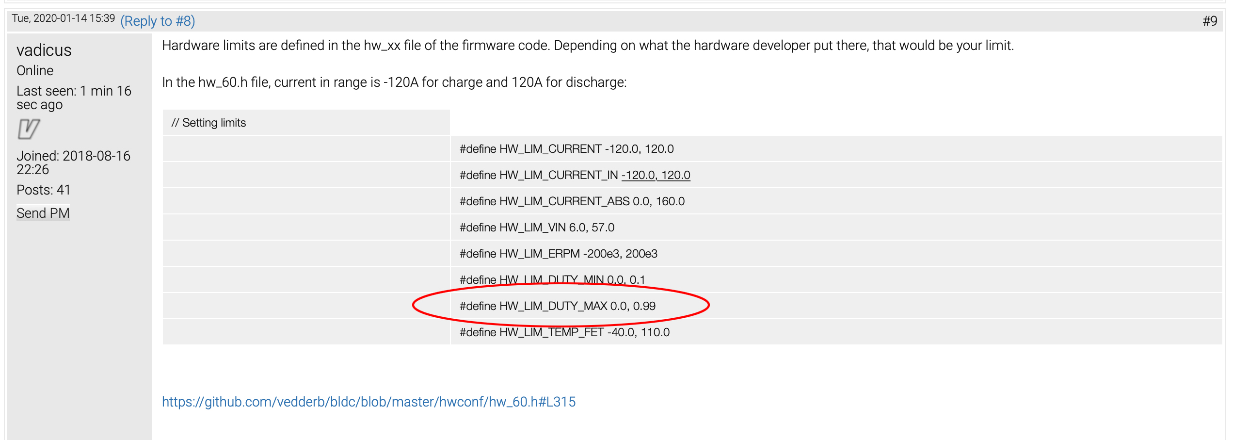

& @murdomeek @mmaner @BluPenguin its possible changing this value could limit the duty cycle and max motor rpm to a chosen percentage of the battery voltage * kv:
