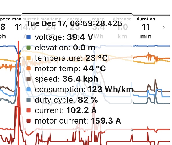

i’m confused what this statement actually means… earlier you said your motor current limit was 100a but that your motor current was 200a… suggesting you are ā€œaddingā€ the current of both escs together which isn’t technically accurate. to avoid confusion, when referring to currents always refer to motor or battery current per motor (as if your board only has 1 motor).
did the 60a / 60a (per motor) in current control give you linear throttle/torque at all speeds? when you input settings it refers to the motor or battery current per motor not both combined.

You can see the logs in the community board project X thread :slight_smile:
it looks like your controller is capable of drawing over 100a battery current per motor (see battery current 102.2a and motor current 159.3a)… so if you want a high level of power and linear torque at all speeds, just set the motor current and battery current limits per motor to the same value… it looks like you could use 100a motor and 100a battery settings to achieve this
*the one exception to this is if the graph is ā€œaddingā€ the currents of both motors together than the statement i just made isn’t necessarily true- it’s only true if the graph shows the motor and battery currents of only one motor
can i ask… when this graph was made was the motor current limit setting ā€œ100aā€
if the answer is yes it implies the graph is adding the currents of both motors together

This was on 80A per motor.
right so each motor is only getting 80a max in the chart… (each motor gets half of what is shown by the graph)… which means when the battery current says 102a, each motor is only drawing 51a battery… which is still under the 60a battery limit I told you about.
so for linear throttle at all speeds, you need 60a motor and 60a battery settings as i’ve been saying all along.

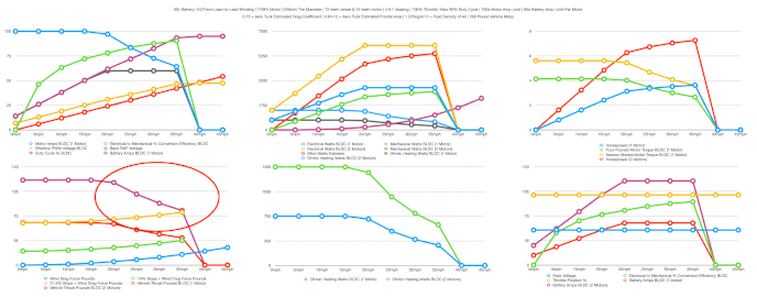

^see the bottom left chart, thrust is reduced above a certain speed with 100a motor setting and the 60a battery firmware limit (even if you input higher values), because sustaining 100a motor current at those higher speeds would exceed the 60a battery firmware limit

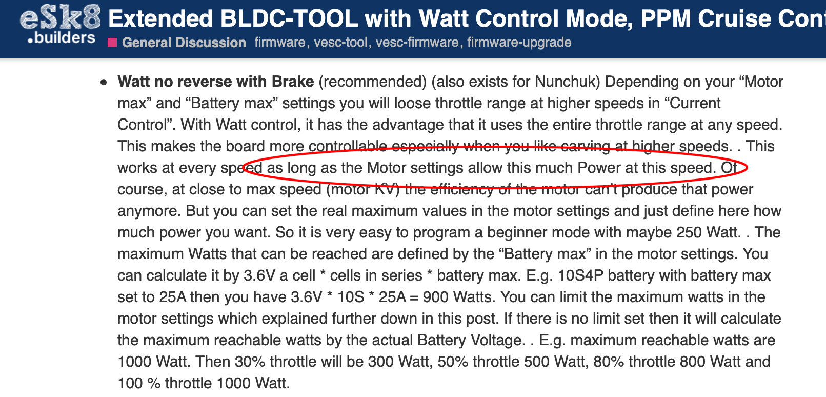

Ack has mentioned current mode in official vesc has implemented his watt mode.
i think watt mode will either sacrifice your power at high speeds (with low watt settings) while delivering throttle range at all speeds, or if you try to have the same amount of power as current control maxed out (with high watt settings), then watt control will in theory mess up your throttle range at low speeds

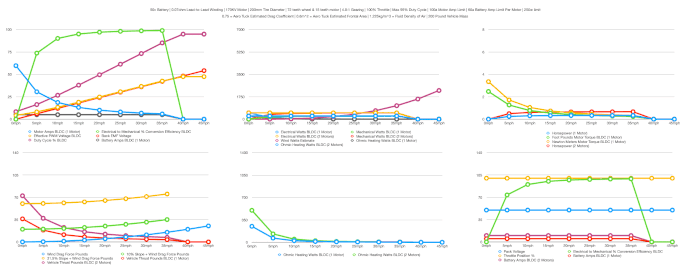

@deucesdown here is an animation of @Chricious setup in watt control mode (with 100a motor current limit setting and 60a battery firmware limit), starting with a 250w limit and increasing in 250w limit increments to 3000w limit (which is equivalent to 60a battery firmware limit):
i’ve circled in the top middle chart the ā€œmissing wattsā€ and in theory ā€œmissing throttle rangeā€ at the low end of the speed range which are caused by the 100a motor current limit setting in watt control mode
notice either he is sacrificing thrust at high speeds compared to his present setup (bottom left chart) with very low (250w) watt settings (but achieving full throttle range), or with high watt settings, the throttle range at low speeds is sacrificed because with a 3000w watt limit, this wattage is impossible at low speeds without exceeding the 100a motor current limit setting.

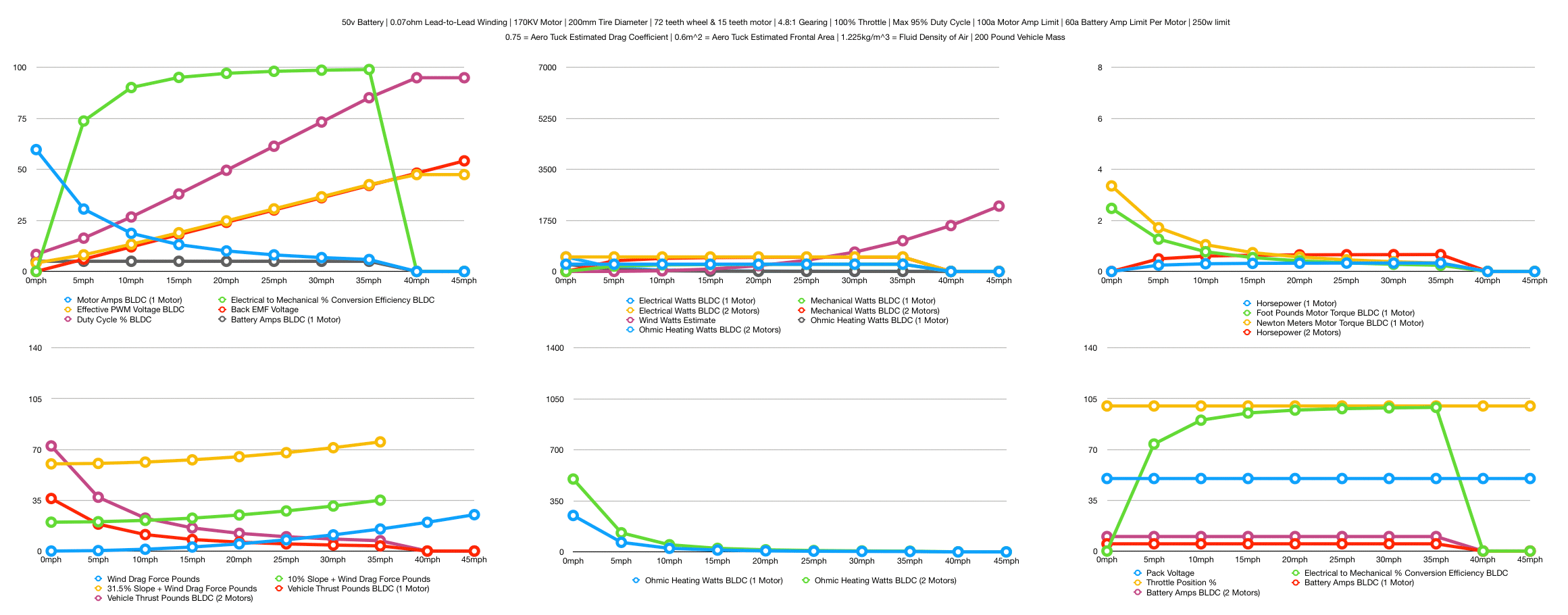

finally, for comparison a chart of his performance in current control mode with either 60a motor and 60a battery settings or 100a motor and 60a battery settings:

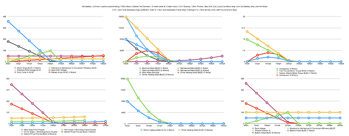

finally, let’s look at his setup in duty control mode with no current failsafes at 50% throttle (which is a bit absurd):
hmm… ~360a motor current (blue line, top left chart) and 18000w electrical watts (yellow line top middle chart) total from the battery at standstill… it’s hard to say what would explode first…
