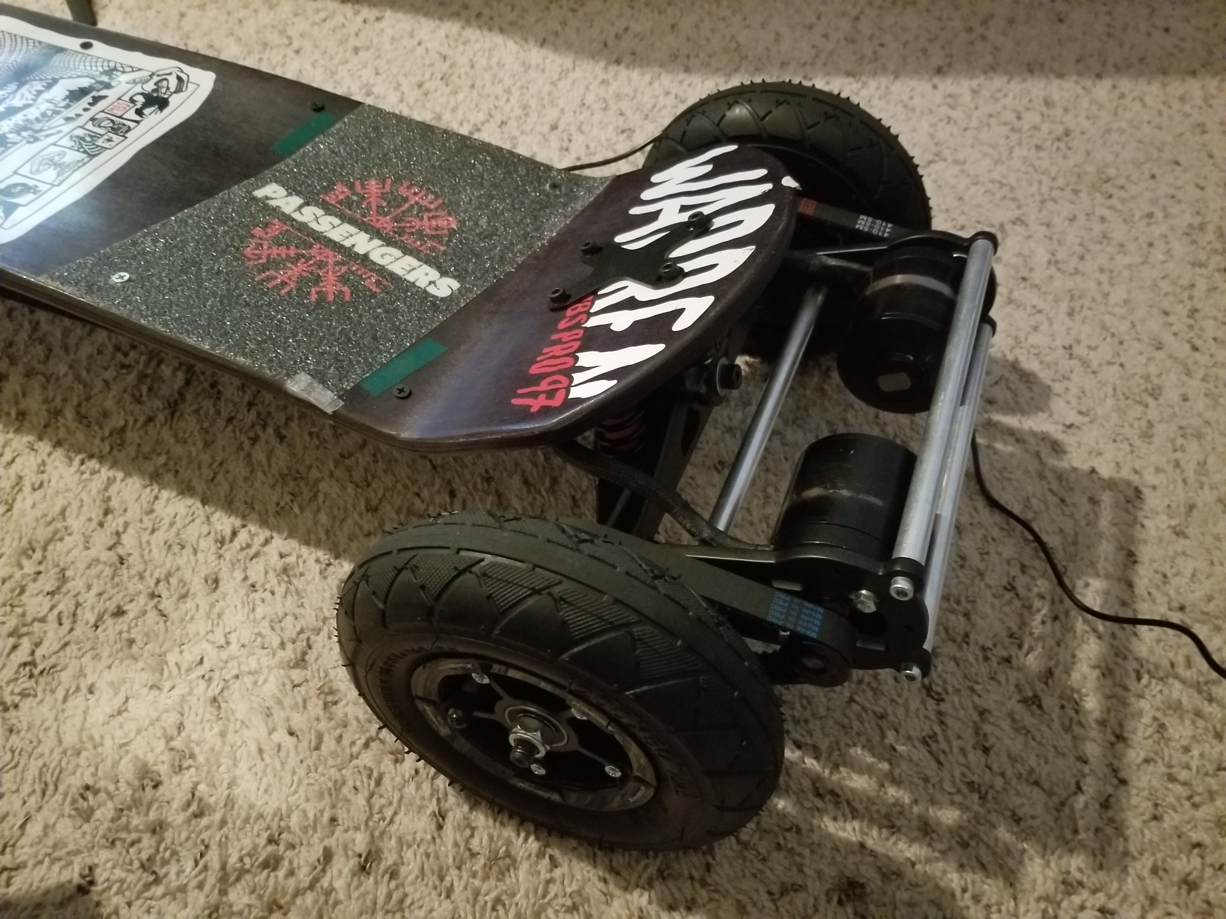

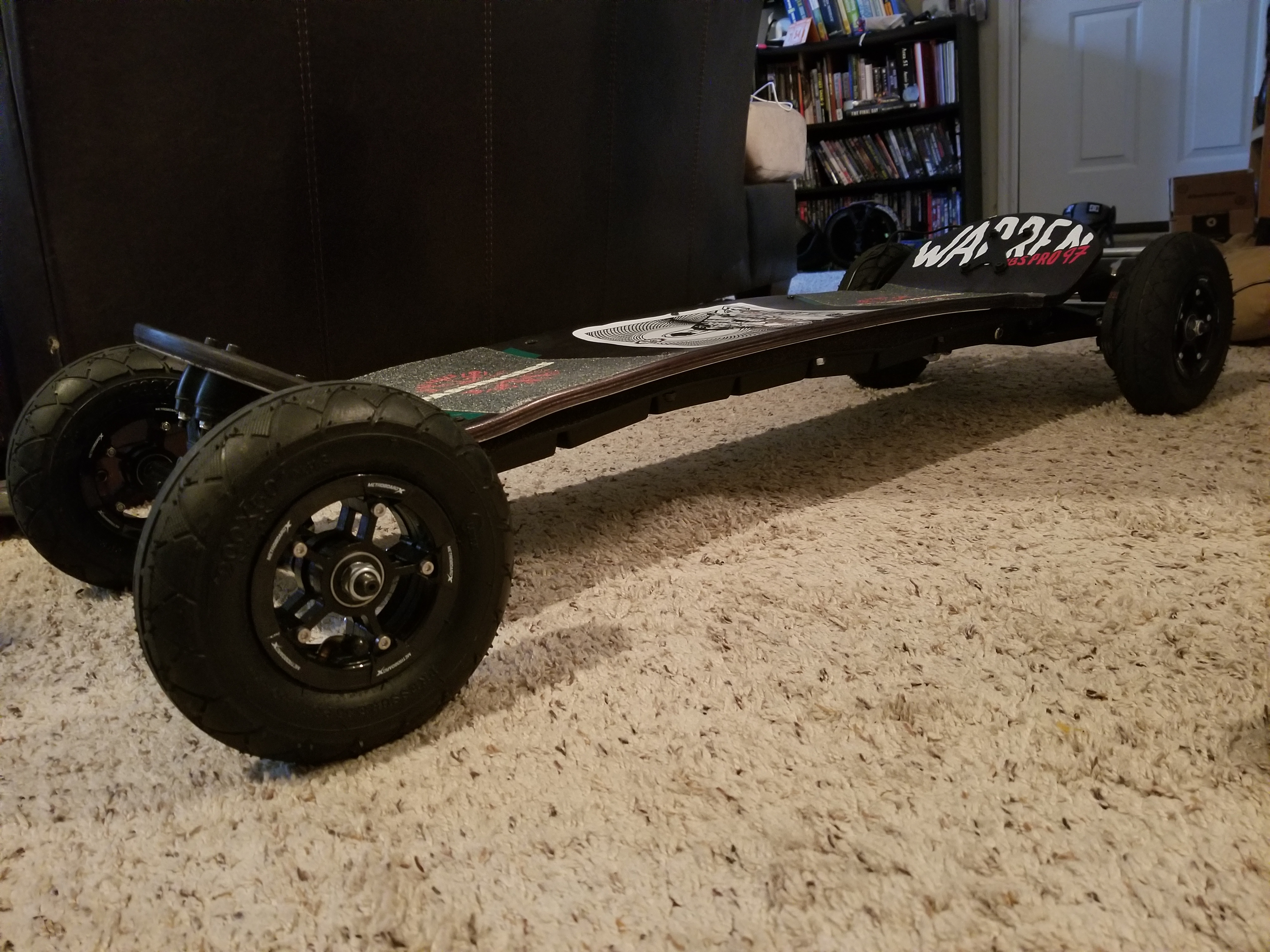

Ok y’all, this is my first DIY (built with the help of some friends) and I’m a complete newb at this. And to be honest, this shit is hard af!
-cheap Chinese spring trucks and motor mounts from Allie express
-metroboard 190mm wheels
-MBS pro 97 deck
-hs11 enclosure from eboardsperu which is now the “universal e-MTB” enclosure after i told him that it fits an MBS deck
-6375 brushless outrunner motors
-@m.hboards 12s4p 30q batteries built into the enclosure.
-flipsky dual vesc6 mini (initially used 2 maytech superfoc 6.8 50a, but those burnt out as soon as i turned on the board)
Really the purpose of this board was to teach beginner, so its not really suppose to be a high performance board. But I’m still having issues. I think the vesc is over heating bc the space inside the enclosure is too tight for the vesc. So it would throttle down the speed at 2.75 miles and the top speed for this with me on it is 22mph. I didnt put any if the components on top deck bc i wanted a sleek looking board. Now the motors get warm but not nuclear hot. Still trying to figure out the solutions but to be honest this will probably be my first and only diy. But on the brightside, i learned a lot.
