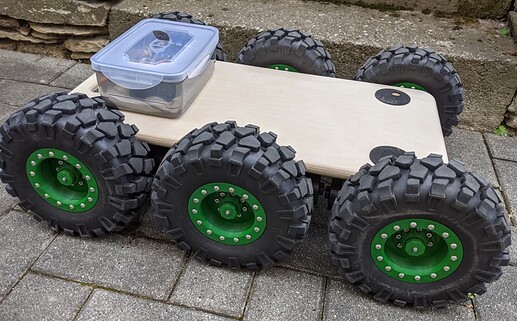

I am playing around with hub motors and a Cheap Focer 2 for a 6x6 RC crawler/rover project. (I cobbled together a test bed for the wheels using old DC wind shield wiper motors, but I would like to use BLDC motors with VESC control in the future.)
My plan is to have a hub motor in each of the six wheels with 6 Cheap Focers as motor controllers. Problem is that my wheels have a diameter of 206 mm, so I need hub motors with loads of torque and low kV which are hard to come by. I found these hub motors for electric skate boards on ebay:

So far, the motors are not too bad, however, with a nominal speed of 1600 RPM my rover would go at about 60 km/h with its 206 mm wheels which is dangerously fast, while the torque is quite a bit on the low side. I should prefer to have a top speed of 10 … 15 km/h and an increase in torque. Which finally leads me to my questions:
  1. The motor has 20 poles i.e., 10 pole pairs, so presumably the max ERPM which I have to set up in VESC tool is 16000, is that correct?
  2. If I run the motor at much lower ERPM than the nominal 16000 I will not lose torque, as torque depends on current and number of turns of the winding. Is that correct?
  3. When using the ERPM control loop in VESC I can not get the motor started below about a 1000 ERPM, below it just clogs and stutters. 1000 ERPM are already about 4 km/h speed which is far too fast as starting speed for my rover. Are there any settings I could use to have much lower starting speed and low RPM control? The motor turns very nicely at the lowest RPMs when I slowly start to slow him down by hand until stall, so in theory the VESC is able to do lowest speed.
  4. Can I increase the torque (and reduce speed) at a given motor current in any way except using a mechanical gear box or rewinding the motor to a lower kV? A gear box defeats me using hub motors in the first place and rewinding 6 motors is the last step of escalation I might consider. :blush:
Thank you very much for bearing with me, any advice is much appreciated,
Cheers Olaf
Re: 4 - You can increase the thrust per amp with smaller diameter tires.
  1. Yes, eRPM = RPM * pole pairs
  2. Torque is dependent on current primarily, electronically limiting the RPM will not reduce it
  3. Low speed control without sensors can be possible with HFI or something, but i have no experience with that myself
  4. You might be able to slightly increase the current capacity with statorade, but I’m afraid that your choices are gearing, rewinding, or hot motors
A gear ratio might just be what you need
…or more wheels…
Thats true, but my whole project is planned around those large tires.
2 hubs per wheel— 12 motors total
Thank you very much, it seems I need to have a look at rewinding the motors. Both gear boxes and hotter motors are not an option.
Regarding the low RPM control, I am using the hall sensors (they get recognised and work apparently fine) but for some reason starting is only possible above a certain ERPM.
Re-winding, you’ll get the same heat for the same torque
The Maximum RPM in VESC Tool doesn’t do what you think it does. It does not prevent the motor from spinning faster. (only prevents power/brake while spinning faster)
Try setting Maximum Duty Cycle instead.
So rewinding can not achieve what a gear box does as in reducing speed and increasing torque at the same power and power losses?
Rewinding for more torque per amp will increase the resistance such that the heat per Newton meter stays the same.
Rewinding at the same copper fill won’t change the KM motor constant, which is the torque per the square root of the resistance heating.
If you add more turns, the controller will run cooler for the same torque but the motor heating will stay the same.
Thank you, more reading to be done. And in all probability I need to find a larger motor with more room for copper…
Probably best bet would be a mechanical reduction with gears or belts or chains.
I am afraid so… I wanted to avoid building gearboxes as it messes with my suspension arms
