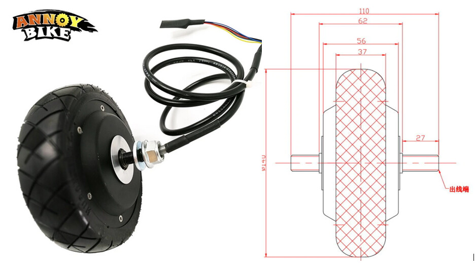

I think I might give those motors a try:
They fit the available space inside of my tires quite nicely and I should think with their larger diameter they will have more torque than my small skate hub motors.
The 5.5 inch hub motor is marked green in the drawing, the rims are red and purple.
Technical data is available a plenty as usual: :smiley:
I already asked the shop for a datasheet, hopefully I will get at least some information…
