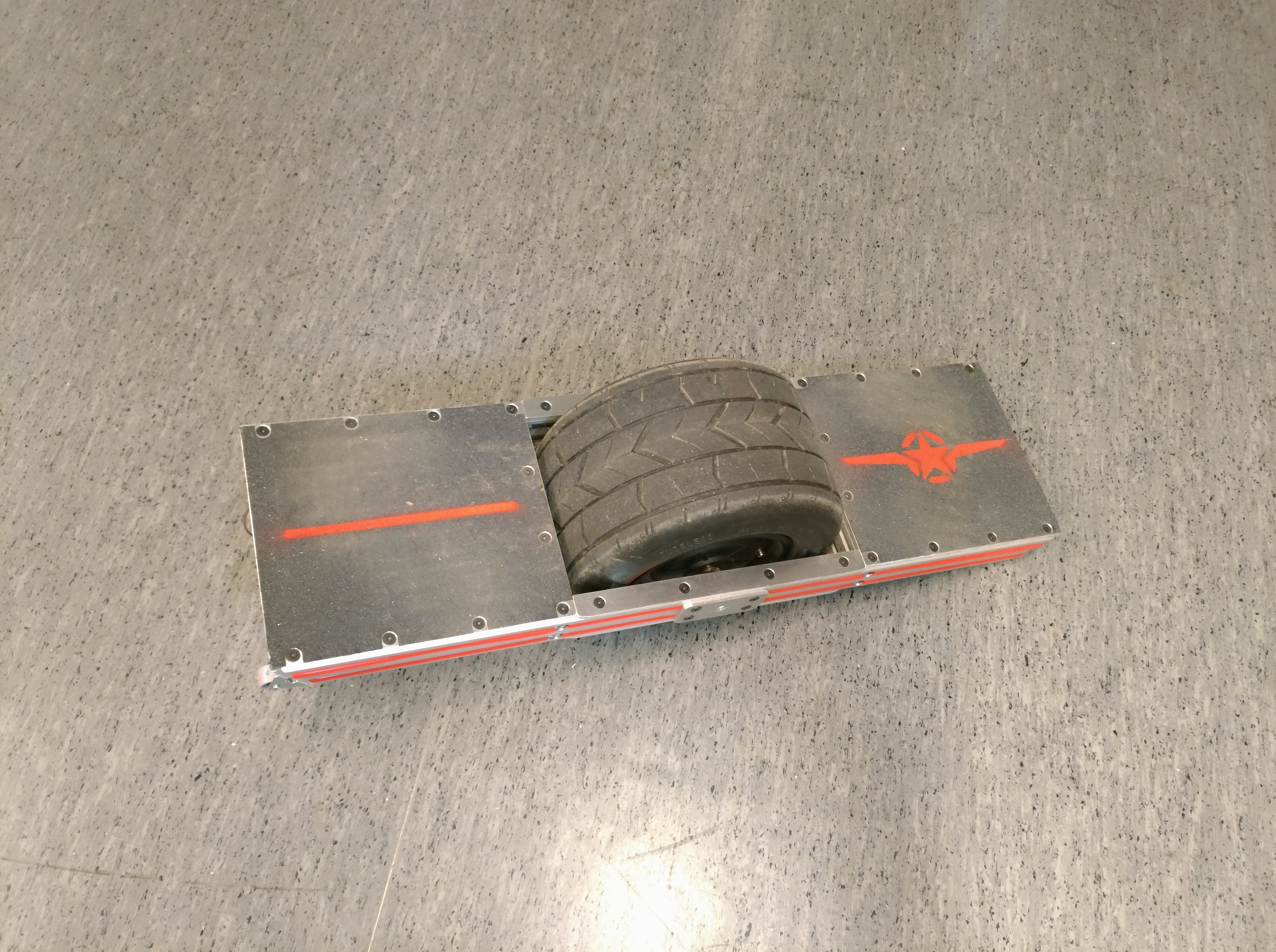

The Redstar from @Jopj inspired me to build my own Oneweel.

Ah and here are at least some wheel pictures
the tire: Maxxis MW 11x6.00-5 ~35€
the Rim: Douglas 130mm 125 ccm DWT, star RIM ~30€
some sheet metal: 1 mm stainless steel (top cover) and 4 mm aluminium (bottom cover screwed on)
Getting tubeless kart tires on such small rims is kinda hard.
The tire appears to be 285 mm (thankfully I accomodate for 290 mm tires) in diameter and is pretty soft (at 1.5bar ~ 15psi) super grippy. Even wih my small hands I can easily pick it up like a resined up handball.
The width is very close to 6" spec with a 130 mm rim.
The wheel looks kinda narrow next to the back (battery frame on this pic only spotweld) but I need the space on the sides to fit the pulley, while keeping the wheel centered (the frame is 215 mm ~ 8.5")
This is the actual build size, the long flats are the actual missing frame pieces but will probably strengthend. As you can see the stainless plates will cover the top, the very right (ie very top) is for the VESC 6 but will get a wooden or plastic cover to make the BT module (which I want to use and YES IT WORKS IN THE BALANCE APP ON THE VESC 6 WITHOUT ANY MODIFICATIONS)
stay tuned more in the future :drooling_face:
