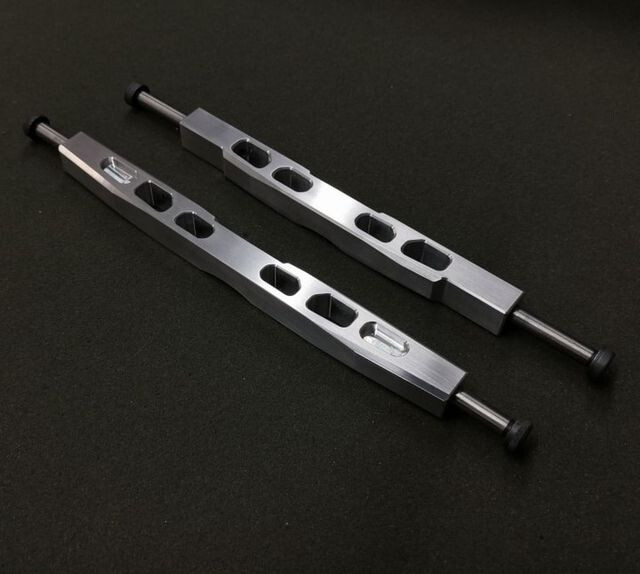

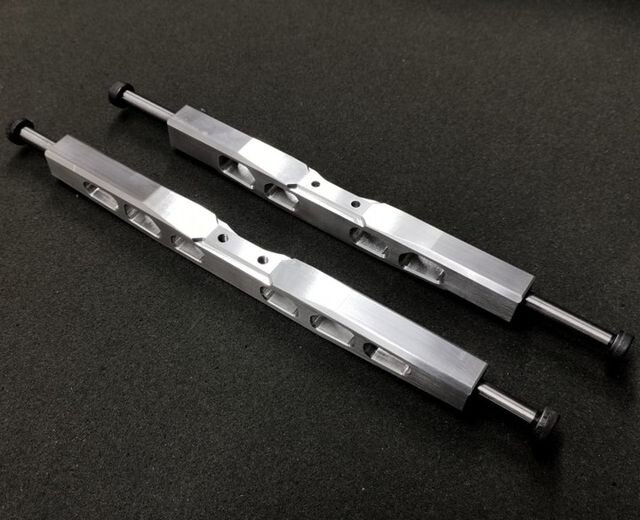

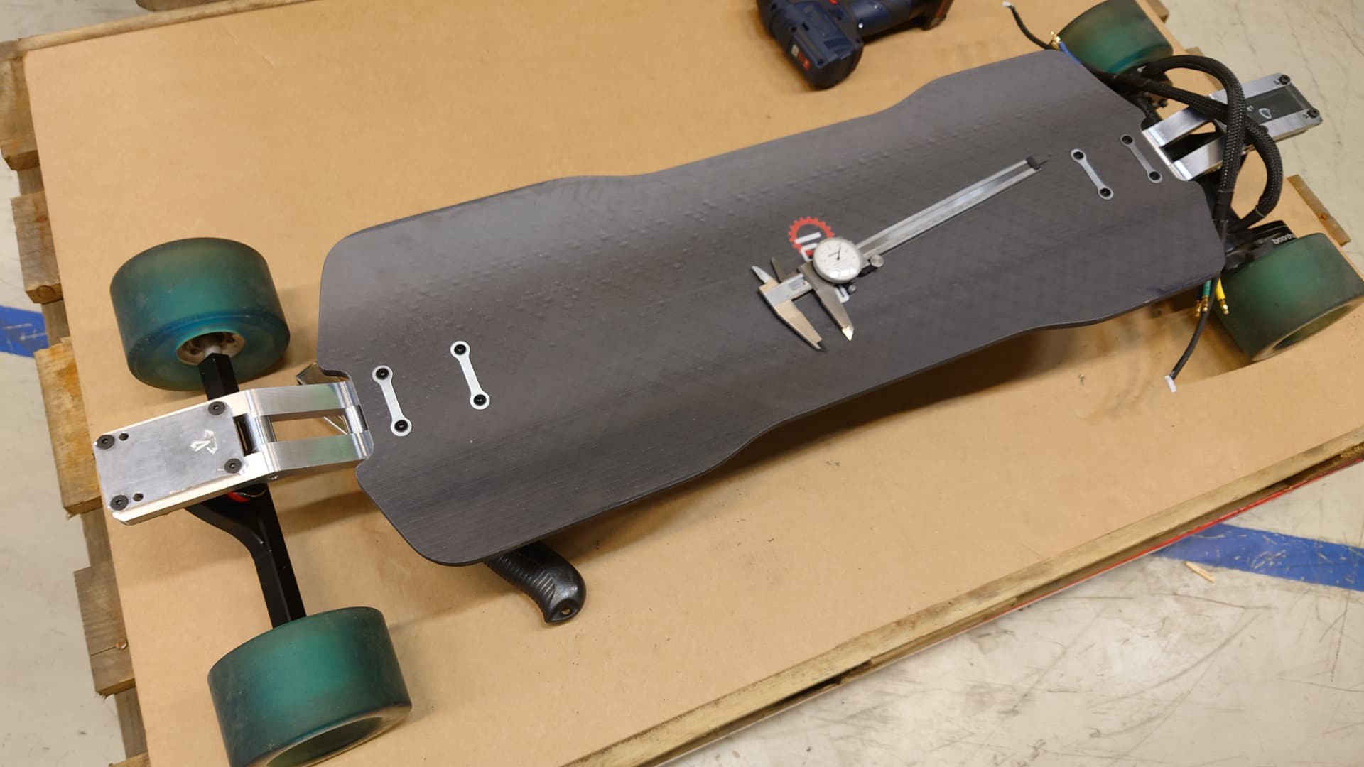

What hanger width are those there, and/or will there be an option to drop the rear angle more? I’d like something like a 20 degree rear option if that’s possible haha.
In this version, changing the angle to 20 degrees is not possible because the brackets are inclined at an angle of 35 degrees and there is a collision between the hanger and the bracket
At the same time, I am designing a horizontal brackets of similar design and in the horizontal version, theoretically, you will be able to change the angle up to 20 degrees… but no this is just a theory because the project is not yet finished :slight_smile:
There will be 4 widths of hangers:
300mm, 280mm, 260mm and 240mm.
These are the dimensions without axles.

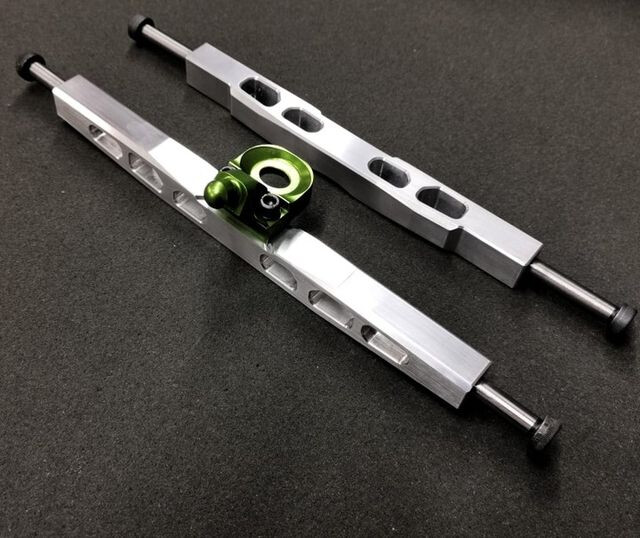

These hangers look amazing. What profile are you using? Just wondering what motor mounts and GDs will be compatible (besides your own motor mounts, obviously).

My standard is 20x20mm + chamfer 1mm
For hangers will fit my motor mounts available in 3 lengths
But I can adapt the ends of the hanger to the 19.5mm standard, so you could probably mount the APEX Jump Drive, E-toox and Trampa gear drive
Perfectly
You design the enclosure so that the space between the housing and the bracket is 35-40mm.
The new brackets do not need nuts, so you can mount the battery and ESC above them.

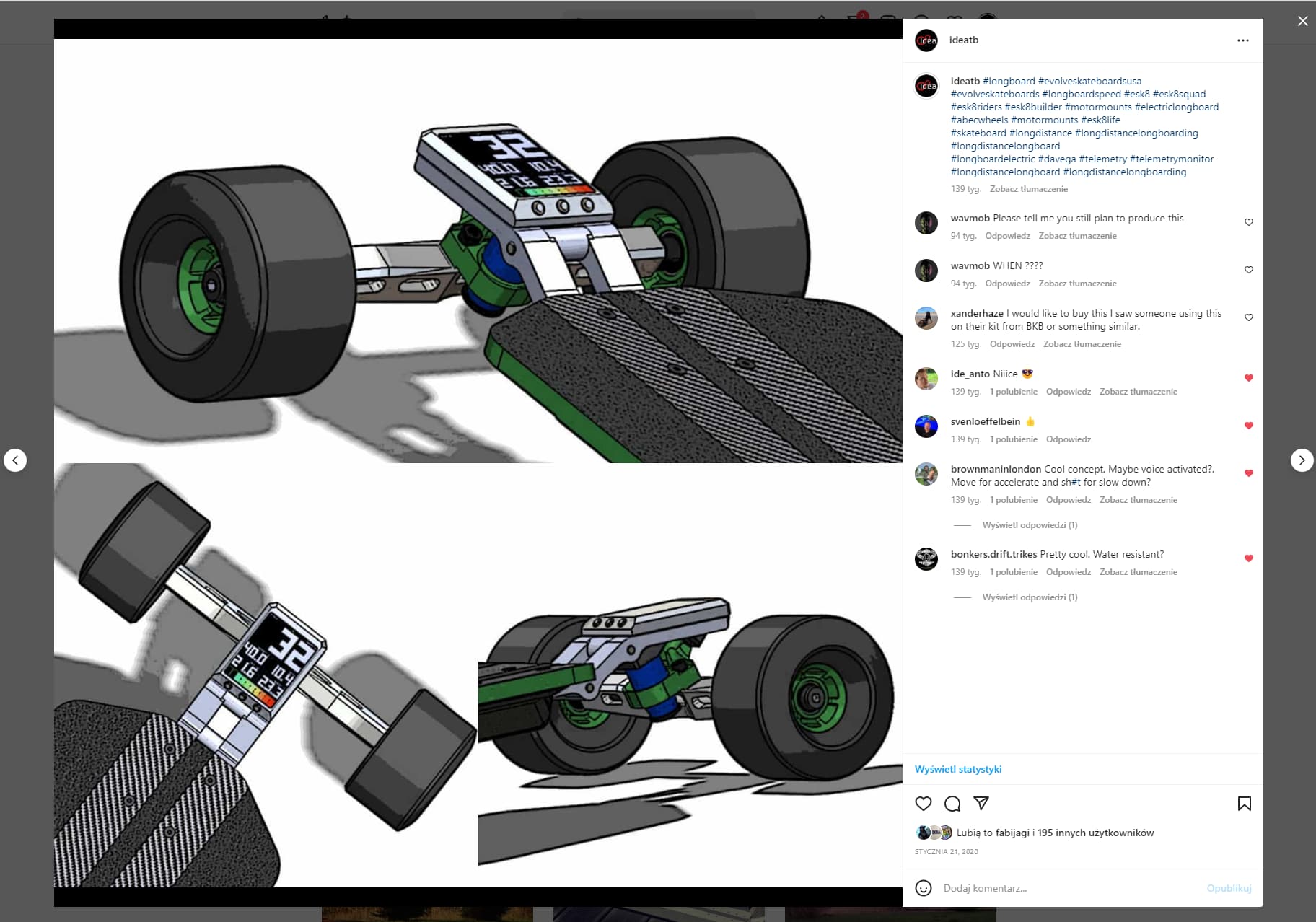

actually it is not so new, because the project is almost 3 years old, it was created in December 2019 :wink:
https://www.instagram.com/p/B7mNsqAJ7N5/
Is that a custom Davega case? I kinda like it
Yes, it’s an enclosure for DavegaX electronics
I love DavegaX but I don’t like the enclosure, because it’s too big and doesn’t fit on the bracket :frowning:
I wanted to design something smaller.
Unfortunately, this would require separating the electronics and hiding them partially in the battery enclosure and that’s a big problem because it requires a lot of cables :frowning:

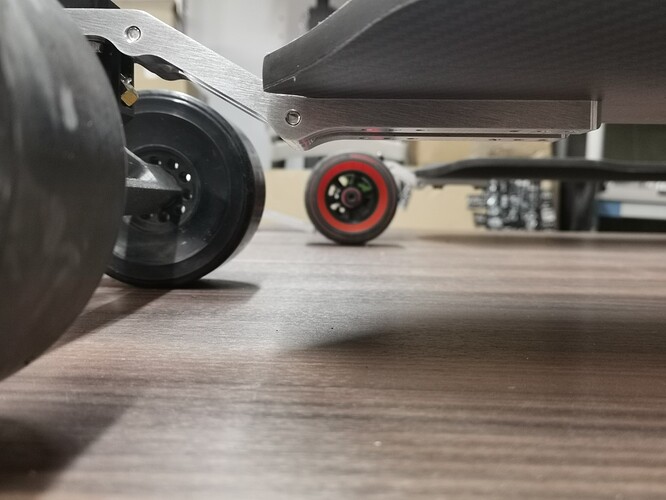

NR:4 Bracket seems it going to work really well with BN M1Street +BN Adjustable base plate V1+ BN220mm hanger.
Looks tall. Can you bottom mount the trucks?
