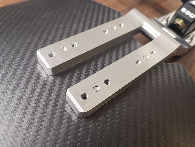

IDEA - Deck with Brackets

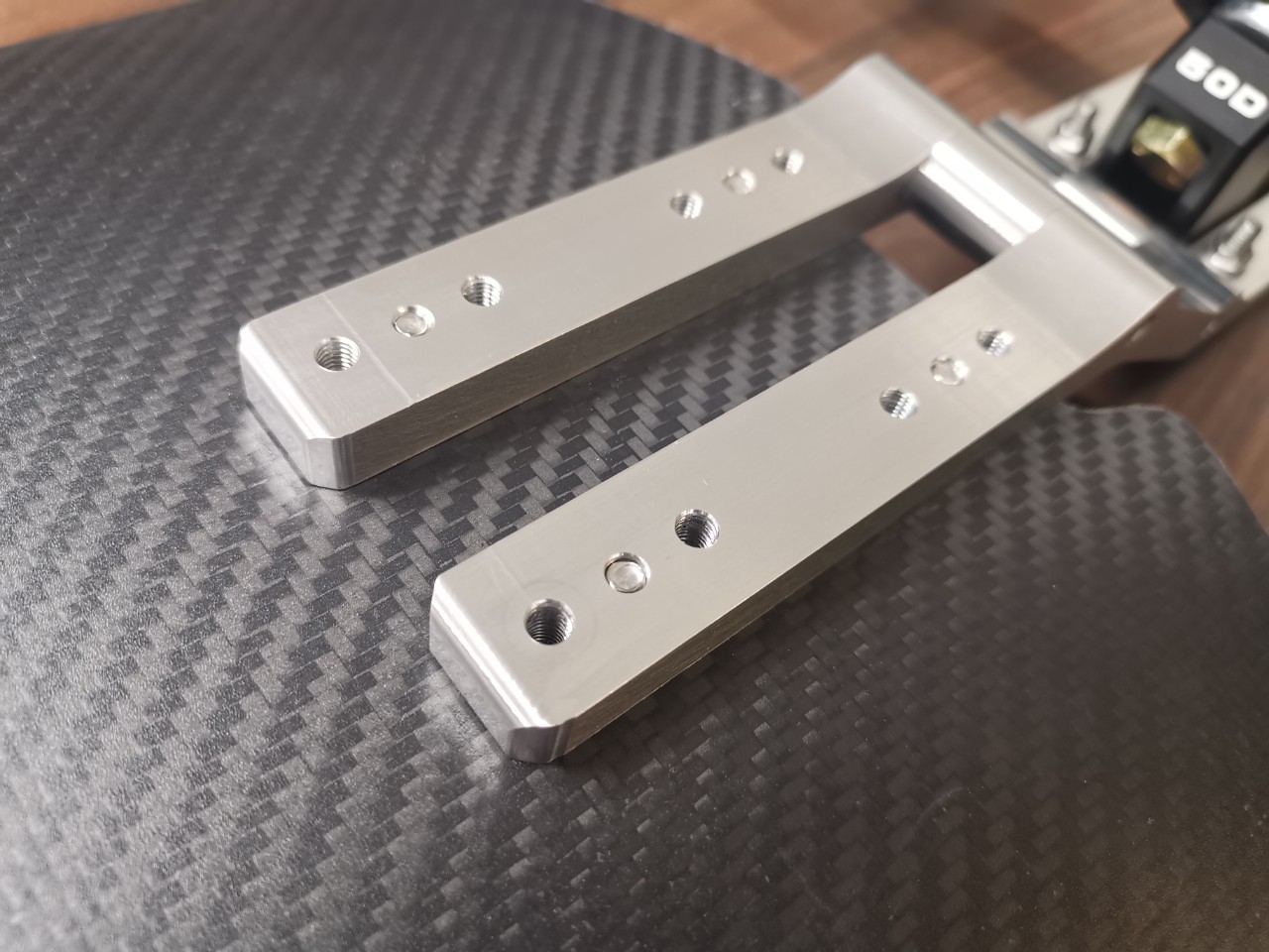

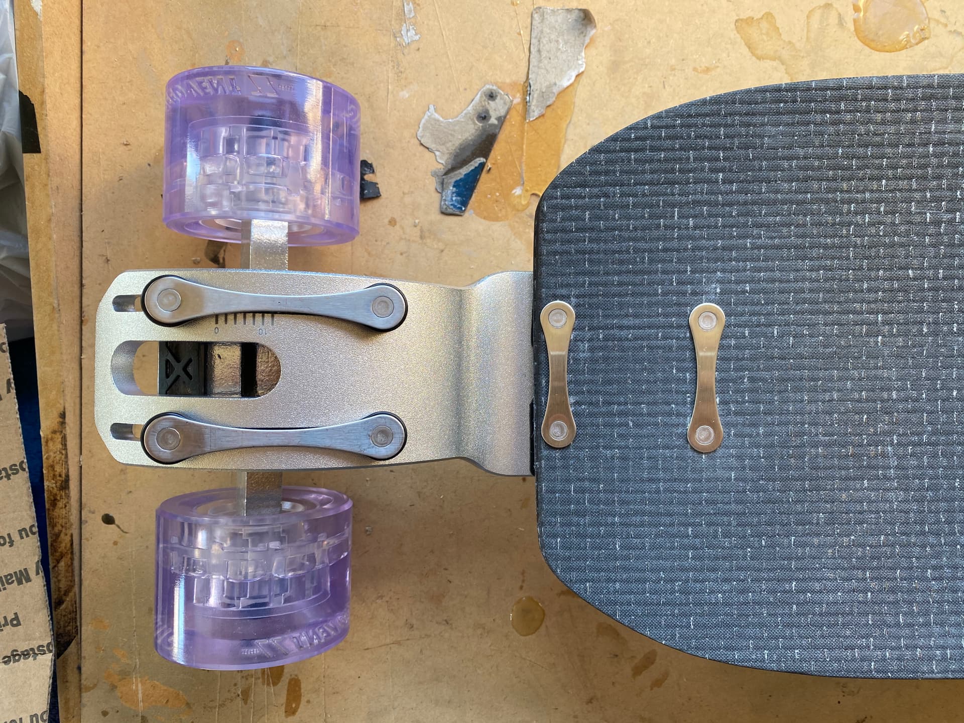

These are made for LDP decks which have the same issue
Recessed screws with special washers to increase the surface area making contact with the deck?
Considered that. Would love to see how that lines up if anyone has them and a 30degree deck around.
If there were a few people willing I could do it… I have already done some other type for 3-link NKP trucks
Brackets 1 and 4 are designed for NKP trucks and recently I have also made ectremely long brackets for the same trucks on individual order

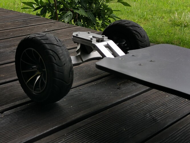

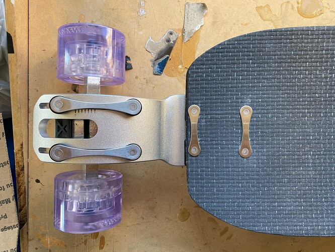

I’ve heard opinions that sometimes the bolts pull out of the sheet metal, I haven’t seen it, but I was told about it by a guy who is a competitor in LDP marathons, so this guy has seen a lot :slight_smile:
Wow I’m going to seriously consider those long ones as I layout this build. Opens up some real options. Thanks.
Yup I can imagine that happening.
In this location there is a lot of load on those because of lever arm from brackets. I was super nervous standing on this at first :joy:

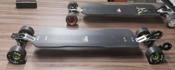

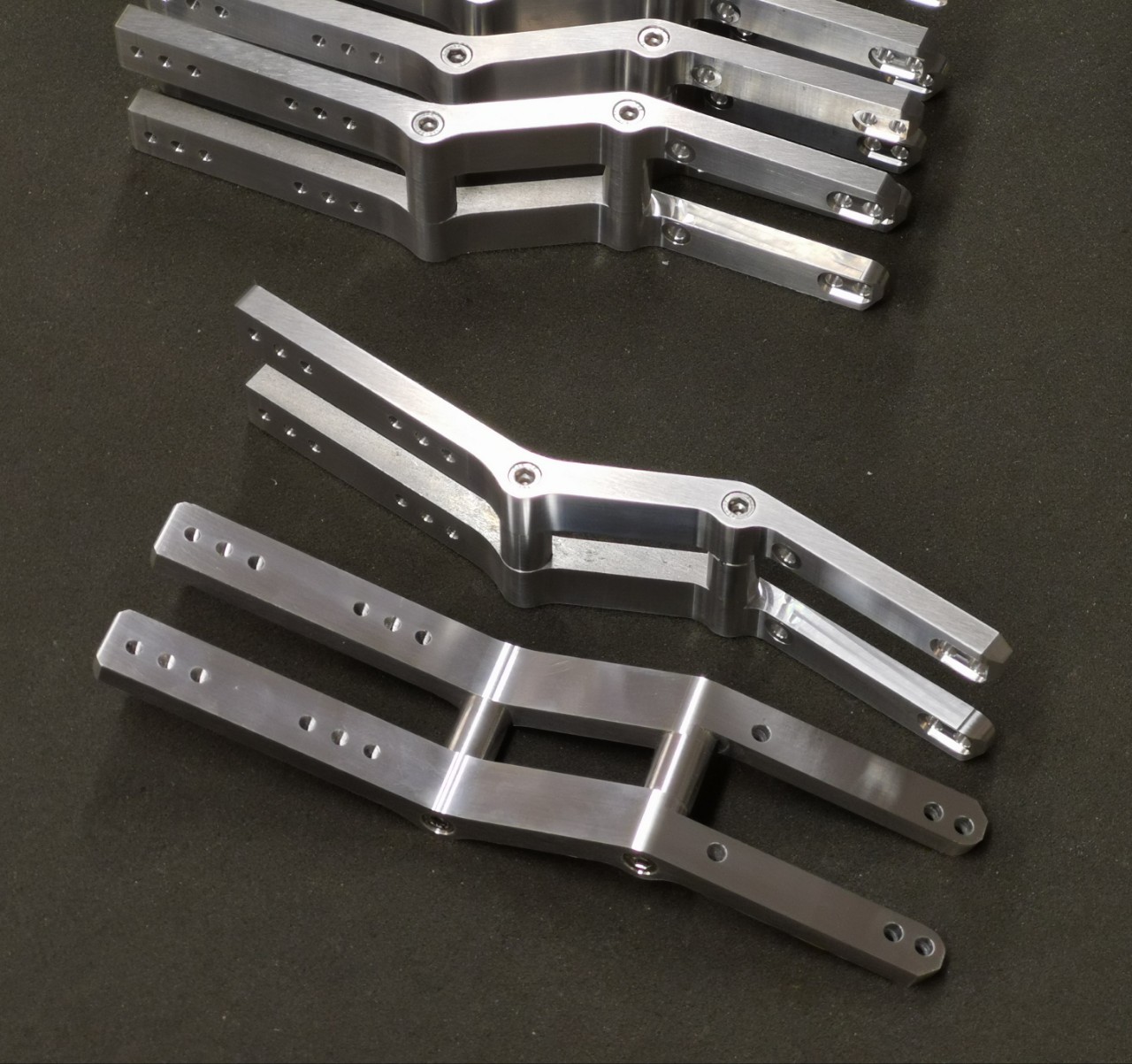

Just wonder, if i use the Horizontal 20mm deep brackets with Boardnamics M1 street grear drive on BN220mm truck will the gear box have interference with the deck ?
if it dont i’m sold.
What type of wheels would you like to mount to such a set? Of what diameter?
TB110mm
There should be no problems with this because the gear drive has a smaller diameter than the wheels, and the TB110 wheels do not interfere with the deck.
I have SR RKP 200mm trucks but long axles, tomorrow I will narrow the distance between the wheels and send you pictures to see how it looks…

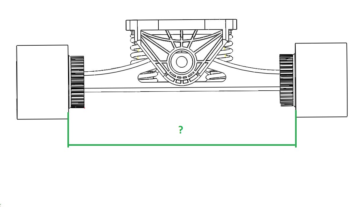

Can you measure the distance between the wheels on a BN220 truck with a gear drive?
I want to set the same distance in between the wheels on my truck
The distance got around 228mm with tape measure, (i can PM you with more accurate number by measure it with caliper at my workplace tomorrow)
IMO, with the #4 brackets should work fine with this drivetrain.

Longer and deeper version of the brackets ideally fits RKP trucks, both for small and larger wheels .
The last batch of brackets has threaded holes, no nuts protrude, so there is additional space for batteries and ESC above the bracket.
except then if you put too long of screw in you puncture the electronics. Some way around that haha!
3 variants of RKP hangers.

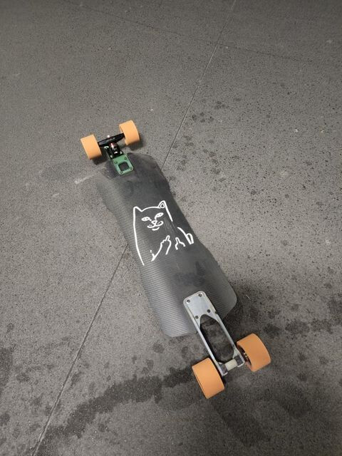

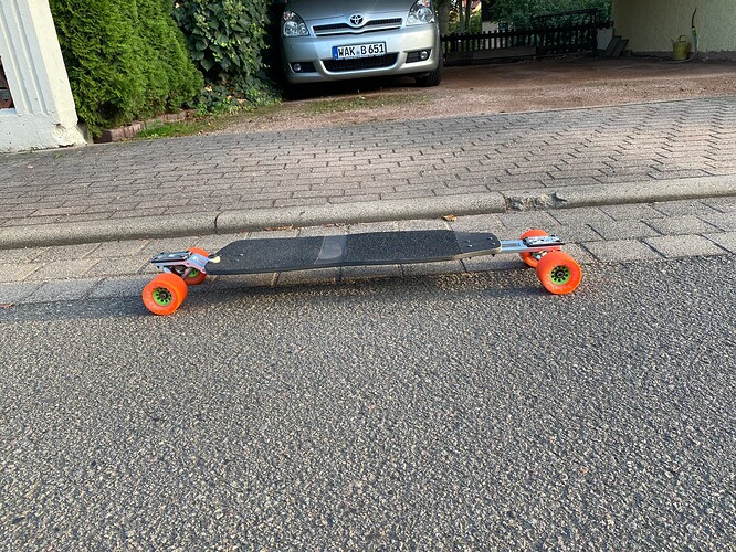

@IDEA Has anyone used your deck and/or brackets combo for a long distance pushing setup?
How’s the website coming? When do you expect it to be up and running?
@exx installed my brackets in his board and one guy from Singapore is using my deck in an LDP setup.
I have little free time and devote it to designing new parts and selling them, so the online store is not ready yet… I hope to finish it this year :/.
