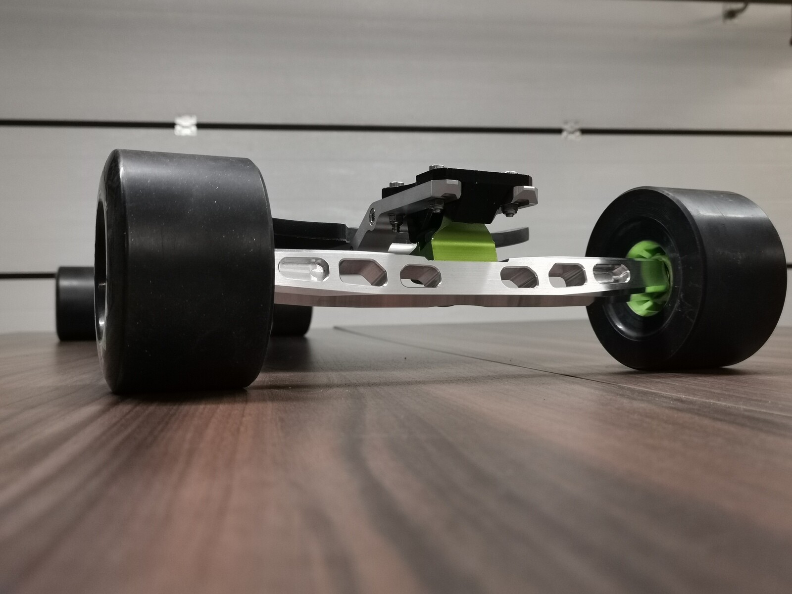

IDEA - Deck with Brackets
Haha! You can But!
It’s already top mounted
Yeah, that’s a bummer.

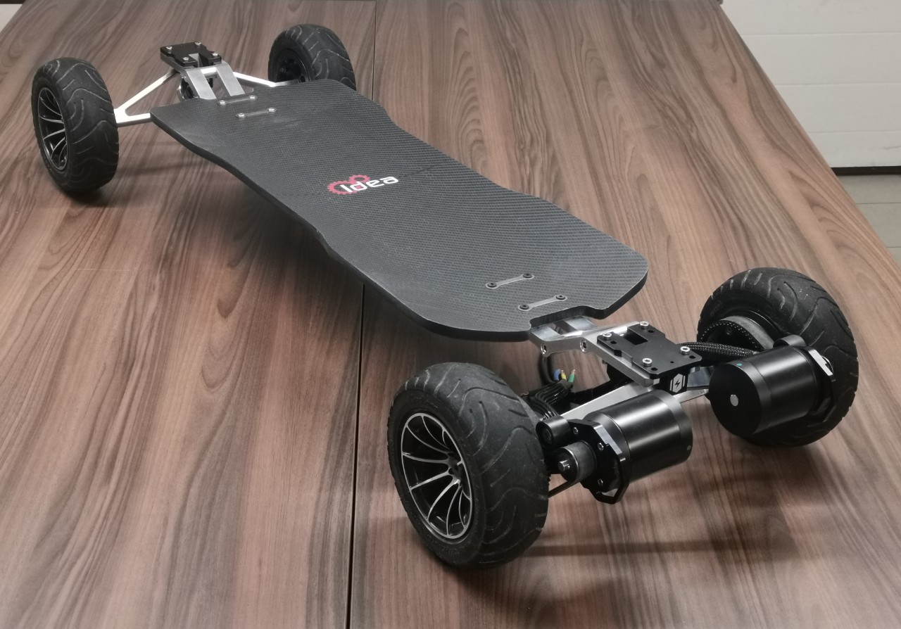

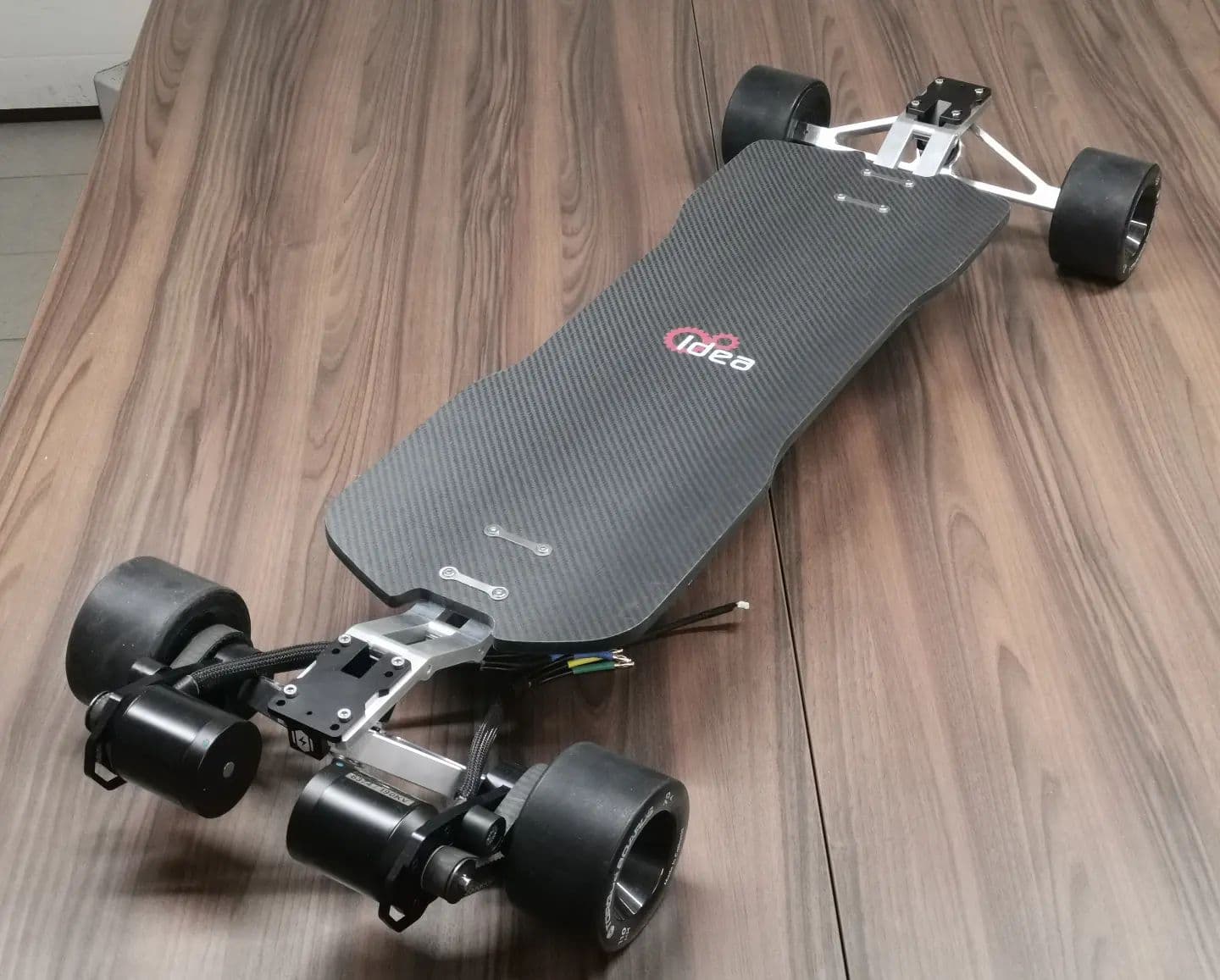

It can be done, but then the motors would interfere with the bracket.
@PROJECTFAP mounted BN 220 trucks with M1 drive , so the engines had to be in front of the bracket
In this photo you have shorter and shallower type 3 brackets with BN 270 trucks

It is possible on the 270s to rear mount 6374s with m1s if you use the adjustable baseplates at 50 degrees and file away some of the hanger
Thanks for the information, but @PROJECTFAP has 220mm trucks
No idea, will 6374 on M1s reverse mount will work with BN270 or not, but i saw some dude did it 6355 motor.
better ask Kevein.
Oh i am saying it definitely will work, i’ve done it.
Okay, my bad.

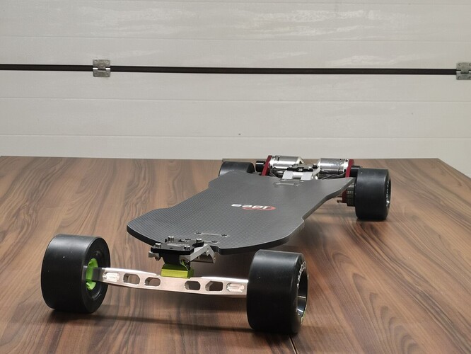

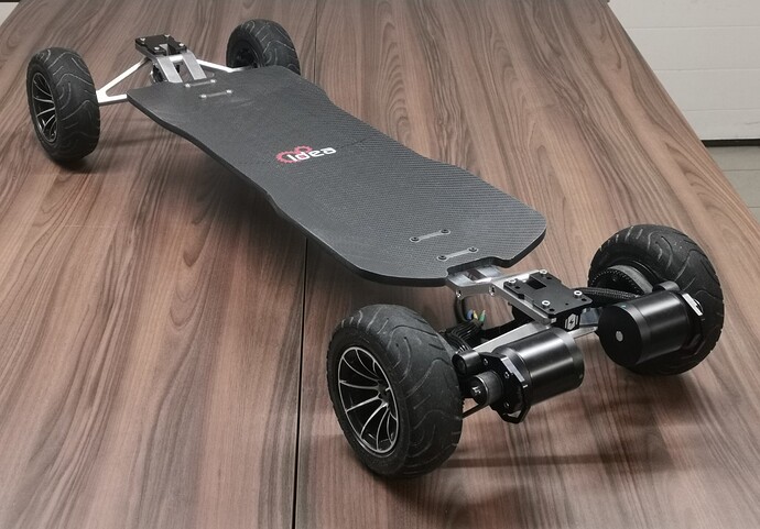

RKP hangers with 165mm diameter AT wheels.

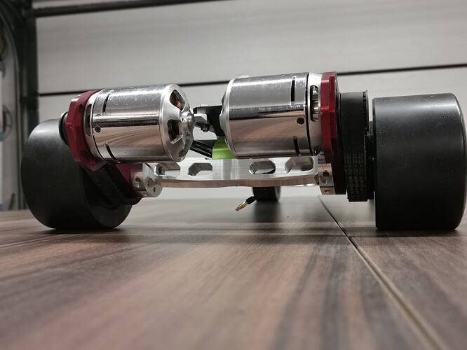

The next step is to make your own standard base plates, but I’ll start with the unusual base plates integrated into the brackets

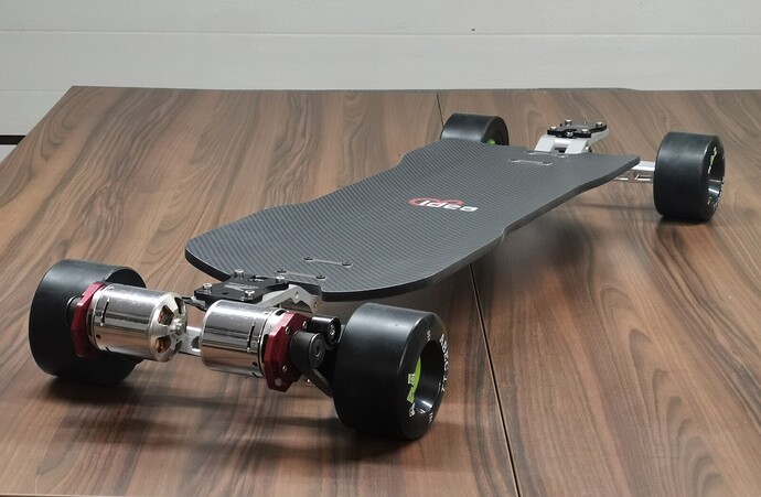

New 35 degree brackets and a new base plate for the RKP truck. In the photo below, the same type of bracket and two different types of trucks, RKP and PKP.
Well, and the first tests :smiley:

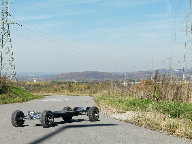

The same set but this time on TB110 wheels and with an enlarged battery.
Now the board has a 10S5 battery built with 50E 21700
The current efficiency (amperage) of the battery is not great, but it is a board for long distances, so it is not power but range that matters.

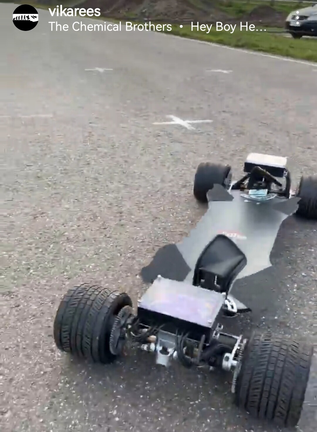

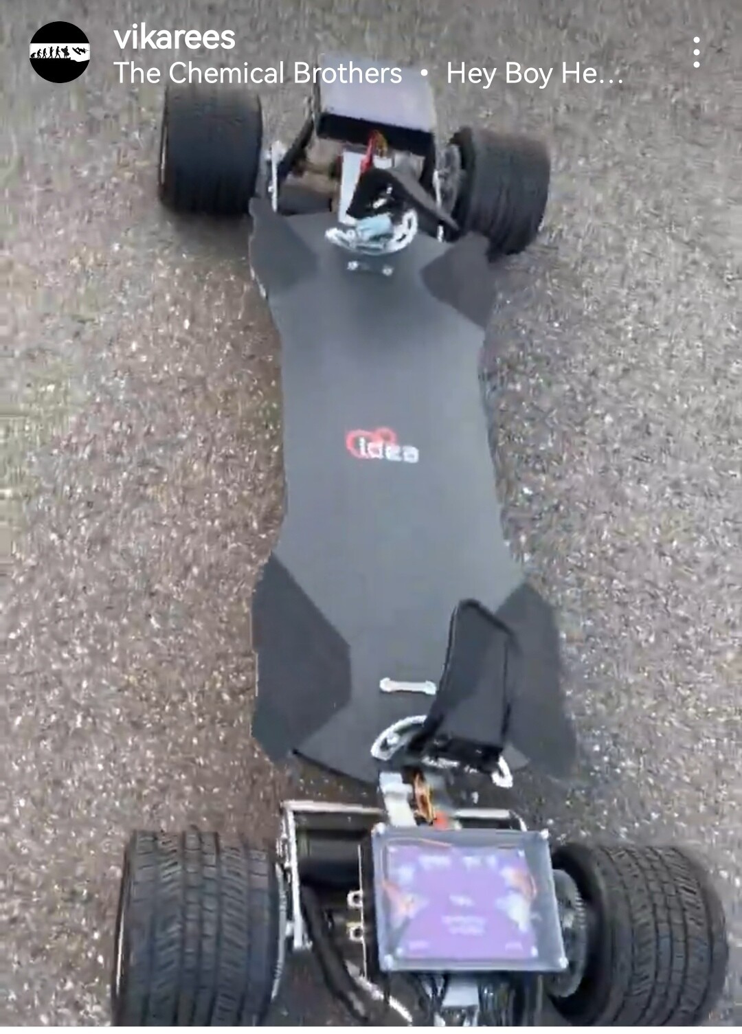

The most extreme board that was made from my parts :smiley:
What wheels/tires are that???
Ohh! my, that thing is pure madness
