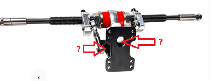

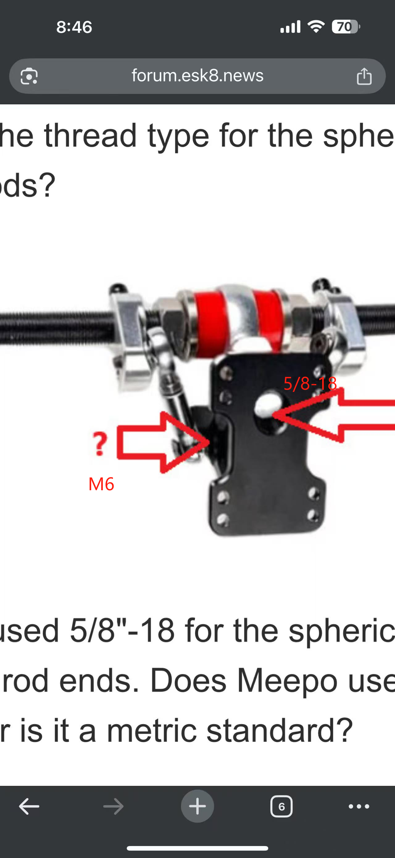

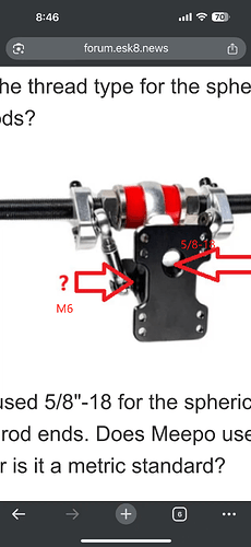

I have a question—one of my customers ordered baseplates for Stooge 3-link trucks from me and is very happy with the setup. Now, he wants to use the same baseplates on SRB 3-Link Trucks from Meepo. Does anyone know the thread type for the spherical joint on the axle and the rods?
So far, I have used 5/8"-18 for the spherical joint and 1/4"-28 for the rod ends. Does Meepo use the same thread sizes, or is it a metric standard?
I must make such threads in these adapters.
With Meepo 3-links, the sizes will be metric. I will check with my sources and get back to you.
Due to my upcoming break, all prices are 25% off – only until the end of February! :slightly_smiling_face:
Thank you for the information about the threads. So, it’s a mixed standard – M6x1 metric rods and a spherical joint in an imperial standard, with the same size as in Stooge axles.
Once again, thanks for your help!

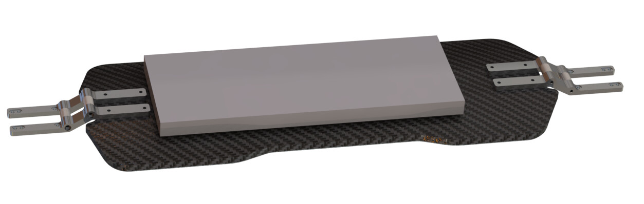

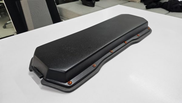

Is it possible to put a 12s4p battery in this deck?
Probably not unless you have great skill with thick gasket making, and sacrifice a ton of clearance
Absolutely possible. You can fit a lot more if you’re handy with enclosure design.
If your vesc will fit under the brackets, 12S4P is more than doable with a SS and minimal gasket. If you go up to the eboosted MS or DS enclosure, even more.
No problem at all if you use a DS (double stack) enclosure.

Hi friend, I actually already have a battery ready and a DV6s esc + using them on a Hurricane Carbon deck, but thinking about changing decks and transferring the configuration to a new deck, I wonder if it will work! ,
Another question, friend, with this deck am I obliged to use your trucks, or can I continue with my savage1.?
Approximate Battery Dimensions:
Length: 18.13" (465mm)
Width: 6.88" (175mm)
Thick: 1" (25.4mm)

Seem it will fit, you can ask me more cad stuff until he returns from his vacation

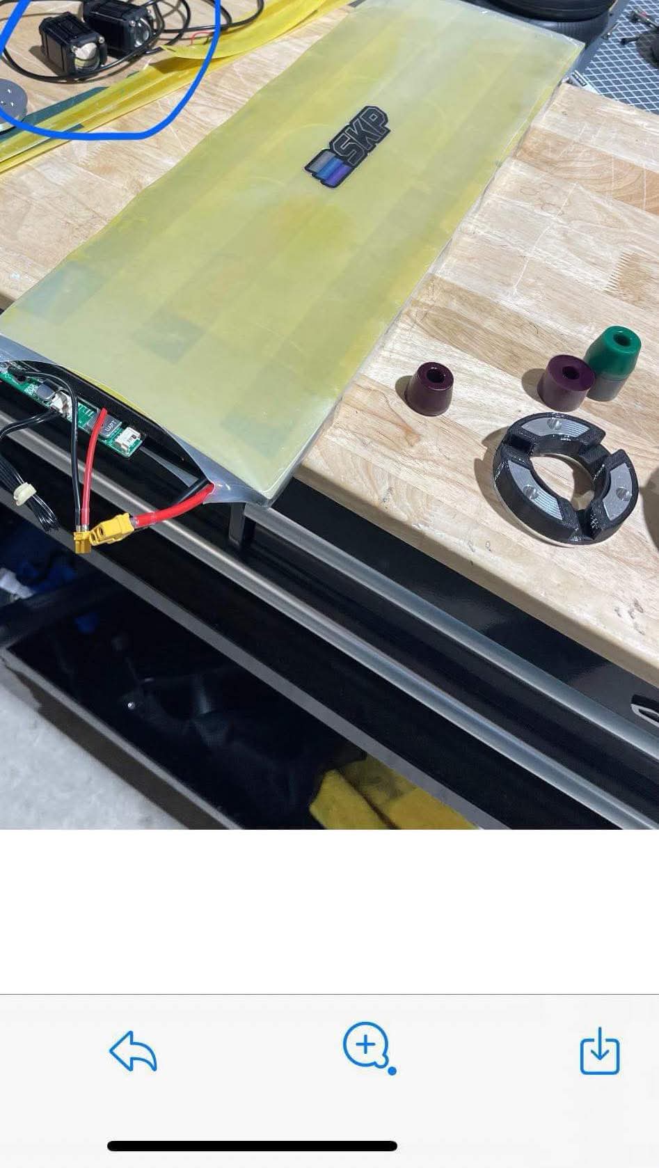

Ok , If I take this deck and sand it, will it have a wood tone? Can I remove all the carbon?
There’s actually more to it than just the outer carbon layer. Underneath the clear protective film on top, there’s a carbon fiber layer, and below that, a layer of fiberglass as well. So it’s not just one layer you’d be removing.
I don’t think it’s a great idea to take all of that off — it could slightly weaken the structure of the deck. Unless you plan to use a stiff enclosure, in which case you can experiment a bit more freely, since the enclosure would add structural support and help stabilize everything.

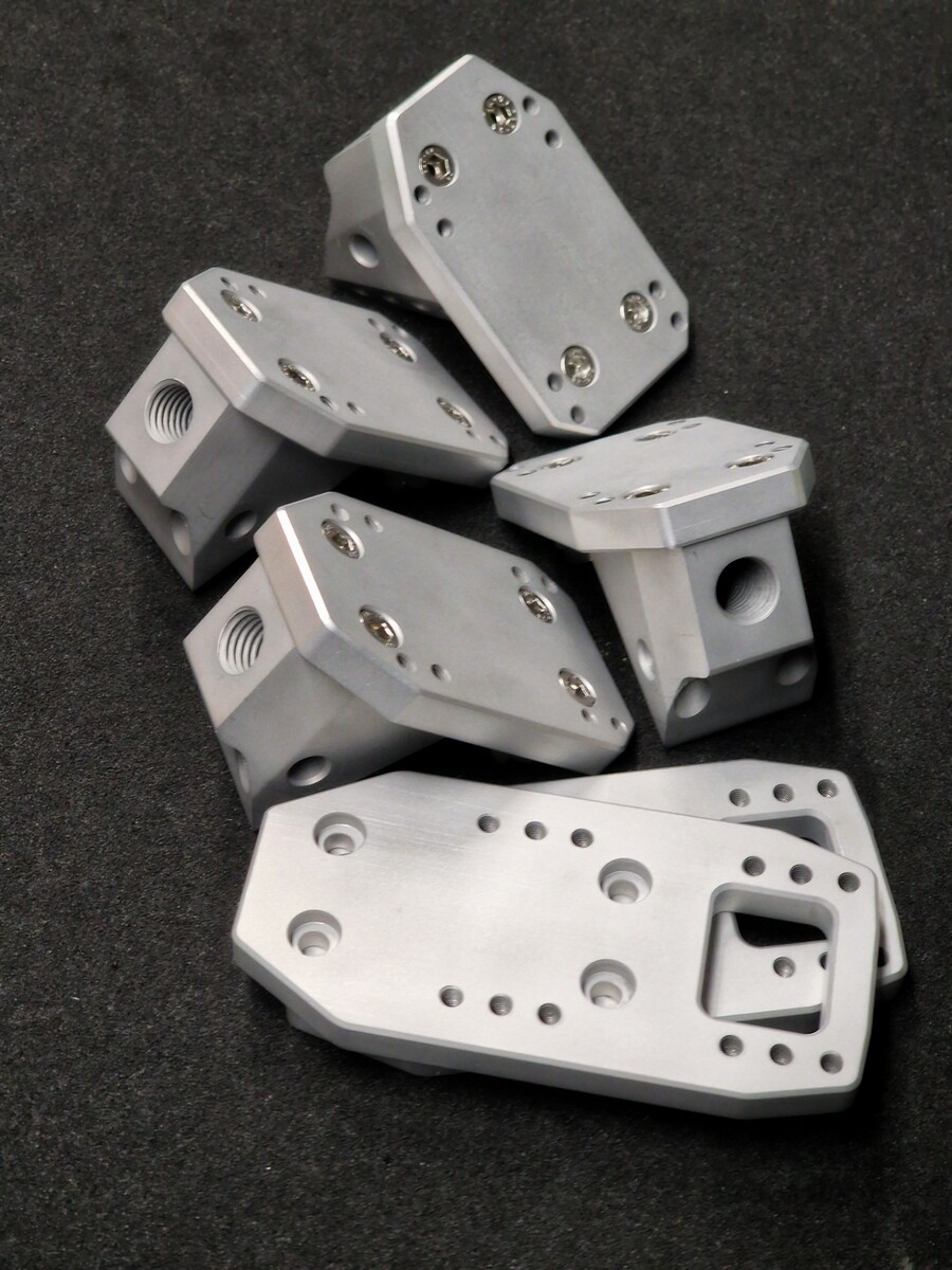

Do you have CAD files of the x-drop brackets? Would like to get my hands on them and work it for another deck i got
Just joined on here and on the hunt for my race build. Are your x-drop brackets on track to be in stock? Particularly the black 40mm-drop set
