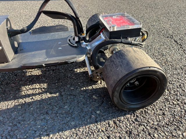

These are unusual solutions, but you can add an additional ESC enclosure, as Vikarees does
Then the entire space inside the enclosure is dedicated to the batteries.
297778512_413582060836653_4343954269935228873_n
I’m trying to avoid an external esc enclosure if possible haha
A mixed stack enclosure is on the works

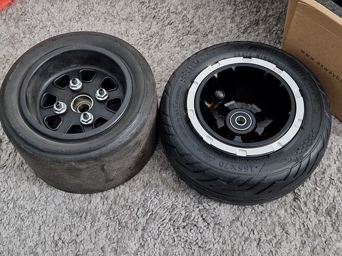

I bought new wheels for the racing version… now I have to think about trucks for such a version :slight_smile:
This is Exway Venator Semi-Slick Competition Tires
I don’t know if they are good but they look great :stuck_out_tongue:
Oh? How much were those, and 8mm bearings or?
I am replacing the bearings with 6900 2RS (61900 2RS)
