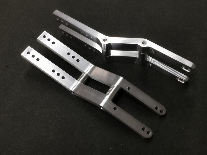

There is also a 3rd variant, type 4 brackets. I think this is the most sensible option
These are slightly longer than yours, are adjustable in length and are 10mm deeper
Here’s a comparison with your brackets
I have red and raw aluminum brackets in stock, black should also be available in 2 weeks
Thanks for explaining me my options! I’ll finish the board, and then figure out if I want to just go 1cm deeper to still use my footstop, or even further with the 35 degree brackets :slight_smile:
Would those type 4 brackets be usable with the deck i currently have, and be compatible with SRB 3 links if i wanted to try those? The other really long ones seem like theyd actually be overkill haha.
Type 4 brackets I designed for NKP SRB 3 links trucks so I confirm that they fit

Gotcha. How much for these brackets? Also, roughly how much clearance would i have with those brackets, SRB 3 links, and the eboosted enclosure?
