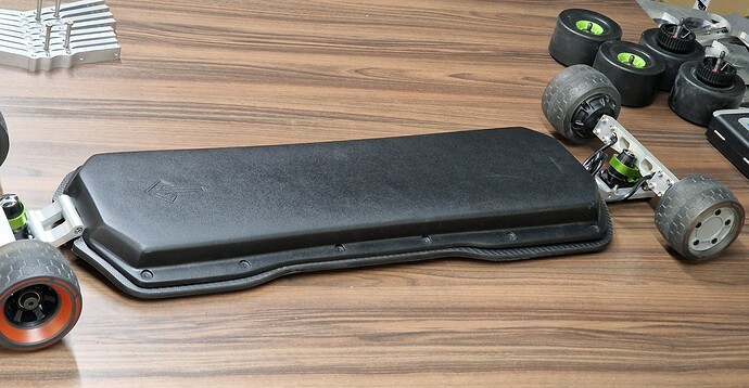

Another board this time built by @Kvothe :slight_smile:

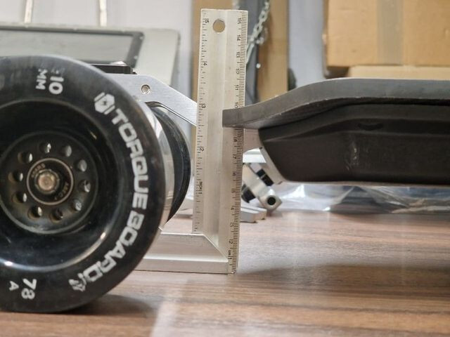

I was asked about the clearance with the enclosure made by @eboosted
I measured with 2 types of brackets and trucks:
  1. 35 degree brackets, IDEA RKP trucks and 110 diameter wheels, the clearance under the board is about 50mm.
  1. #4 brackets, classic RKP trucks (TORQUE 220 CNC) and 110 diameter wheels, the clearance is about 55mm

ENCLOSURE:
Currently, the only enclosure available is manufactured by @eboosted
Perhaps @guy and @glyphiks will make their enclosures
I do not broker the sale, enclosures you order directly from Alan
They will be different from eboosted, if they will be available for sale I will publish information about it here
From the parts described you can build this board :slight_smile:
