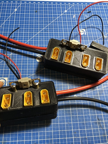

Printed a xt90 parallel serial mount which will make wiring 12s2p LiPos for each side easy.
It’s just a prototype but it will include a fuse mount as well.

Parallel/series connectors are wires up.
The fuse got a small cover after that picture.
The two thin wire are meant to go to an lcd Display to monitor the overall voltage aka 3A charge port. Probably will never use that charge port, but why not.
