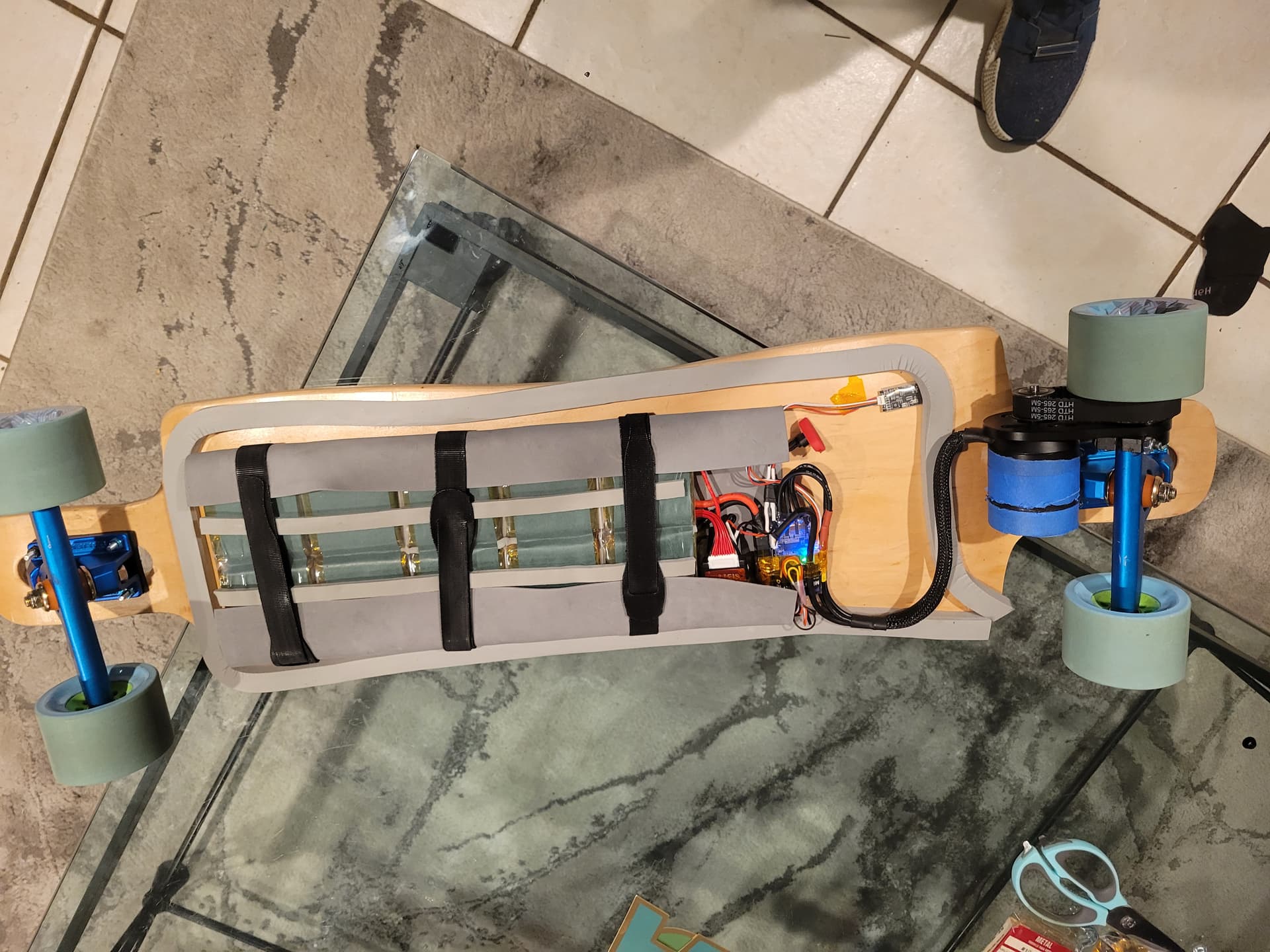

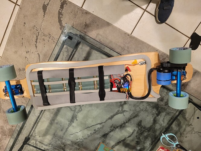

I made a grove in my enclosure to help prevent the wires from rubbing against it.
That belt looks too loose. If the motor can’t slide forward anymore then you will need a shorter belt.
I think a 255mm belt would work better on that BN mount with a 16/36 pulley. 265 might be too long.
That mount can be adjusted from 56mm to 68mm. Based on some calculators online:
56mm center to center on 16/36 = 246mm belt
68mm center to center on 13/36 = 265mm belt
68mm center to center on 16/36 = 270mm belt
Run those wires through the enclosure, not under the lip, for better results.
