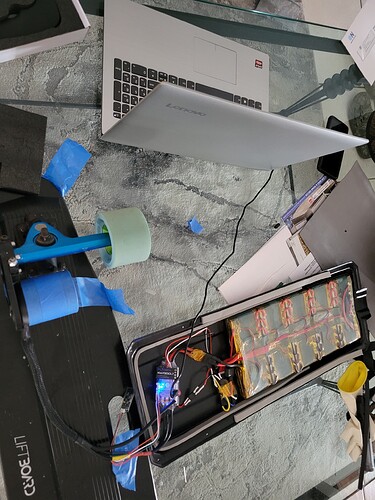

Ok so my board is not ready yet, but I have an old prebuild that had a broken motor. So I used it to test my drive train. One thing I learned (which I kinda already knew from guys on the forum) that my motor clearance is way too low. So I am going to have to figure that one out. But otherwise ran ok. It wasn’t blow you away performance, but I didnt really suspect that from the 6s battery it has. I cant wait until I finally finish my board.

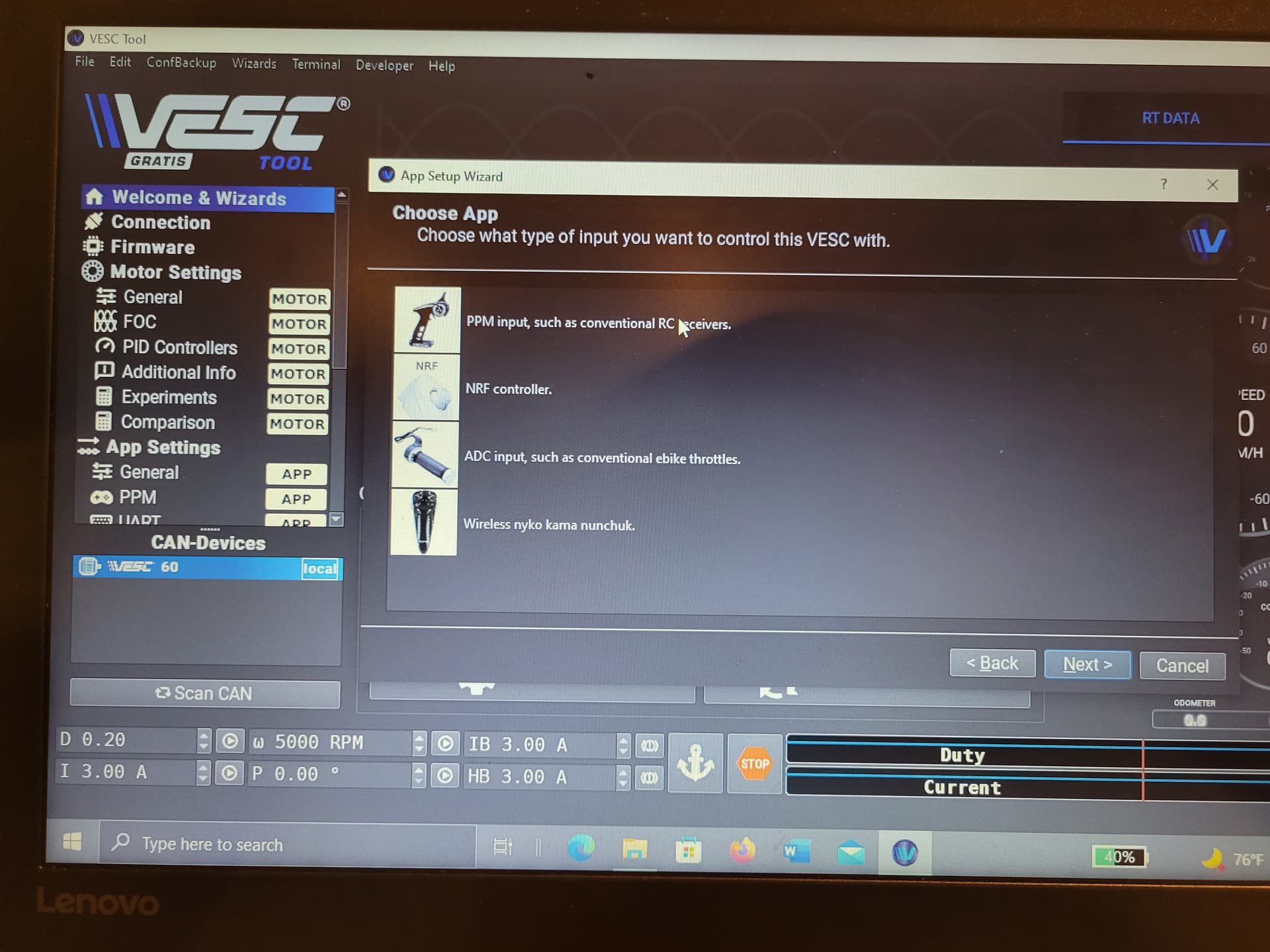

So I plan on installing my Vesc soon and was wondering if anyone had some suggestion for what settings to use. I just want to be able to get it to work then I will tinker with it to get it the way I like.
I have a:
Flipsky 6.7 mini
10s4p p42a
single 6374 flipsky battle harden motor
I have 85mm caguama blue wheels
16/36 pulley with a 15mm belt
I am about 170 (78kg) give or take
I have some decent practice with esk8 so I can handle hard braking/accelerating
I think that is all the relevant information if anyone needs more let me know. And thank you all again.
Just use the wizard and set 60 battery amps per side and 100 motor amps per side.
thats REALL:Y high for a 6.7 mini. Try 30 battery and 60 motor

I am tring to set up my vesc, but it won’t connect it keeps saying, “serial port error: the semaphore timeout period has expired”

I got it to connect

Which do I chose I have a flipsky vx2
nrf
thanks
The vesc is all setup but the remote is not working. When I spin the wheel on the board it shows on the remote the speed but the throttle does do anything.
the joy of the vx2. search “vx2” on this forum, you’ll find your answer
