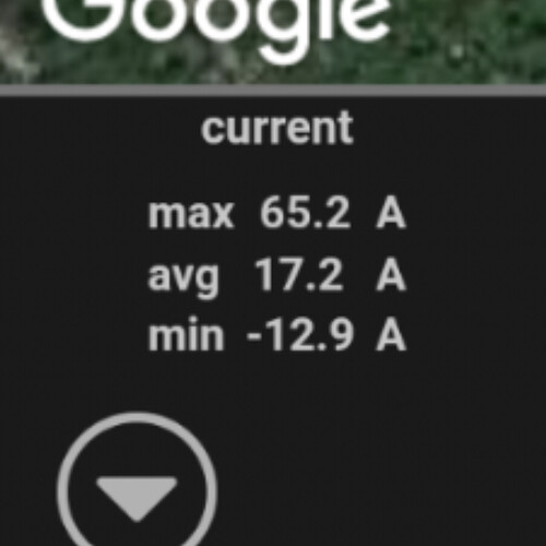

Cant let it lie can you? I already provided you with a technician answer but here it is again with pretty pictures and telemetry.
In this post is a telemetry log of a ride I did late last year, switch it to satellite. Entirely off road.
Now lets only concentrate on the battery current, as you can see multiple times the battery current is higher than the maximum current your 12S7P 48G pack could supply. As @Battery_Mooch says, those cells are good for max 5-7A per cell, so circa 35A total current output. My board is set for 80A per side battery max and is geared for ~30mph max speed, so potentially on bad terrain at 50% duty cycle my battery can be approximately 90A total output current and just 15 mph - this is already almost 3x the power output that your 48G pack can provide. If you gear shorter, the situation gets even worse.
Your 48G pack will be severely power limited, we all know how motor amps work against battery amps, I’m not disputing it will still have torque off the line, but as you accelerate on bad terrain the battery will sag, the internal resistance will climb, it will get hot, it will be an awful experience to ride and the cells will suffer a short life. Can you honestly hand on heart say you have tested this before recommending, because I don’t think you have - and that’s my issue. I know you have never been wrong in your entire life, but I’m sure you can see why I think you do this community a disservice with shitty advice.
With regards to battery amps here’s my log from riding that location.
Consider that this is on a board with a 18s4p pack. The point of interest is this:
So over 9 miles and an hour long ride I drew peak power of up to 16A per cell. But more interesting is that the average current is 4.3A per cell for an hour.
Curious as to @Battery_Mooch and @Trampa opinions on how 48G would cope delivering over 4A continuous for over an hour with peaks up to 16A?
Im guessing they would be a saggy mess and I would have spent an hour sitting on the battery voltage limit. I can verify that the P42A would give no fucks.
